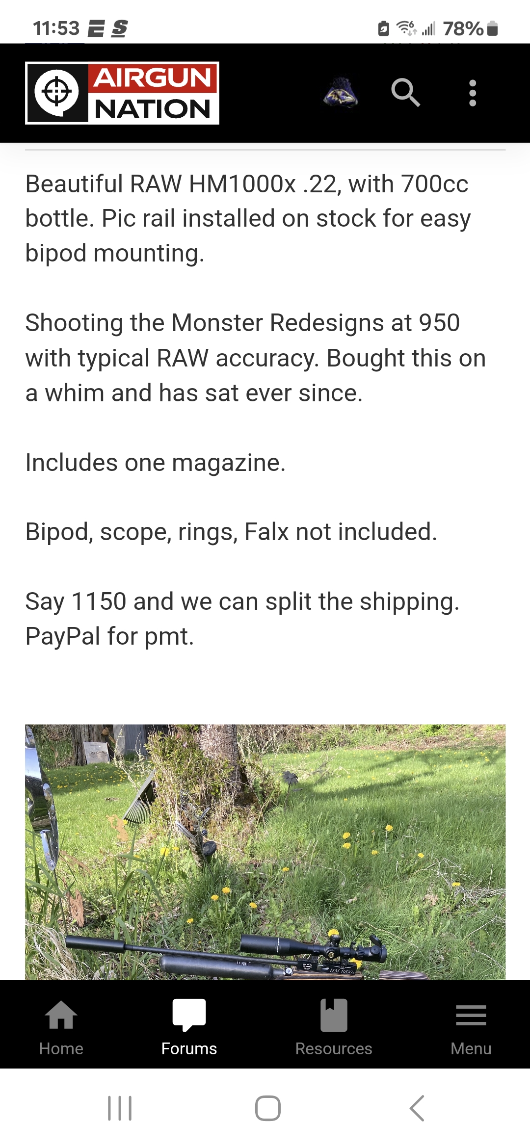

We need more info but you asked for info. My suggestion is to buy used and quality. Stay alert for a good trigger, barrel and about all. Pinpoint accuracy at your desired distance. If another $150 is in your budget take a look at this setting in the classifieds. Just saying.
