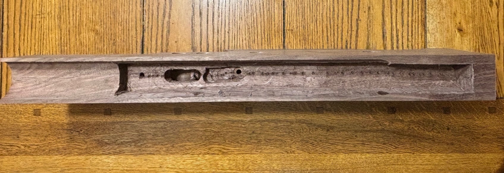

Here's so far. Inletting is finished and I seated the action and air tube about 1/4" deeper in the stock to lower the profile a bit. Tremendous amount of chisel work even after a lot of Forstner bit mortising. Funny, I have a mortising press in the box. I haven't put it to use yet.
I planed about 1/16" from each side. I have wiggle room at the end of the butt if I need it. Of course the butt has to be angled down from the top to access the power tune adjustment.
I just carved (band saw) a few inches of the extra wood away in the last 30 minutes. I've left about 1/4" around the edges, probably too much. Drilled for trigger guard and cutout in the butt.
The action screw holes aren't off as much as they look from the overhead. However, I might still have to drill the hole larger, insert a dowel, and drill again as was suggested above. My bit was too long to be able to take short bits in and out to keep the bit from wandering. Next time I'll find an 8" bit.
