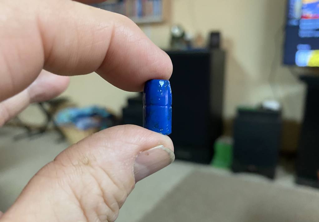

1st attempt at powder coating some of my home cast slugs. Made a couple rookie mistakes(some are a bit splotchy/others I didn’t clean powder from the hollow point), that I learned from, but all in all ended up with some shootable sized slugs to feed the Taurus Bulldog when she arrives.

Slugs were first sized to .357, then cleaned in acetone, recleaned in hot soapy water, towel/air dried, shaken to powder, baked standing on end at the required temp and time, air cooled for 2hrs, then ran back through the .357 sizer. To my surprise, rather than peeling away the coating, for the most part the pure soft lead actually compressed under the sizing pressure. Leaving a thin film of coating to hopefully help alleviate any potential leading problems.
If any peel when you size them after coating, something is wrong. You should be able to smash them with a hammer and not get peeling.
Also, no matter how clean, some powders are just blotchy. Get a lead thermometer and drill a hole in the side of your oven so you can monitor the temperature. And do not cook food in the oven after using powder coat, you probably know this, but worth repeating for others. Do not use the oven in your kitchen for this stuff

The oven that I’m using is a quality 2nd hand toaster oven that I picked up last weekend on Marketplace. And, I agree that your advice is worth reiterating. Sound indeed. I recently purchased the digital lead thermometer as well, and like the idea of drilling the hole and incorporating it into the oven. I did, on the other hand, pick up an oven thermometer and used it in this first bake to corroborate the set temp.
