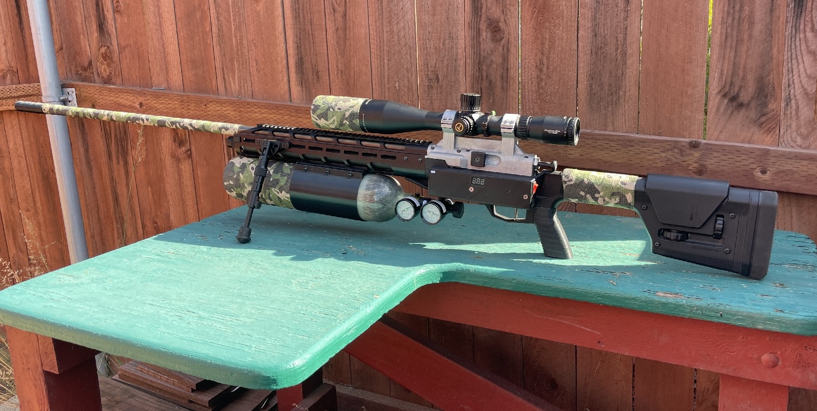

Nice shooting! What rifle is that? I guess most guys can recognize it from the photo, but I am clueless.
