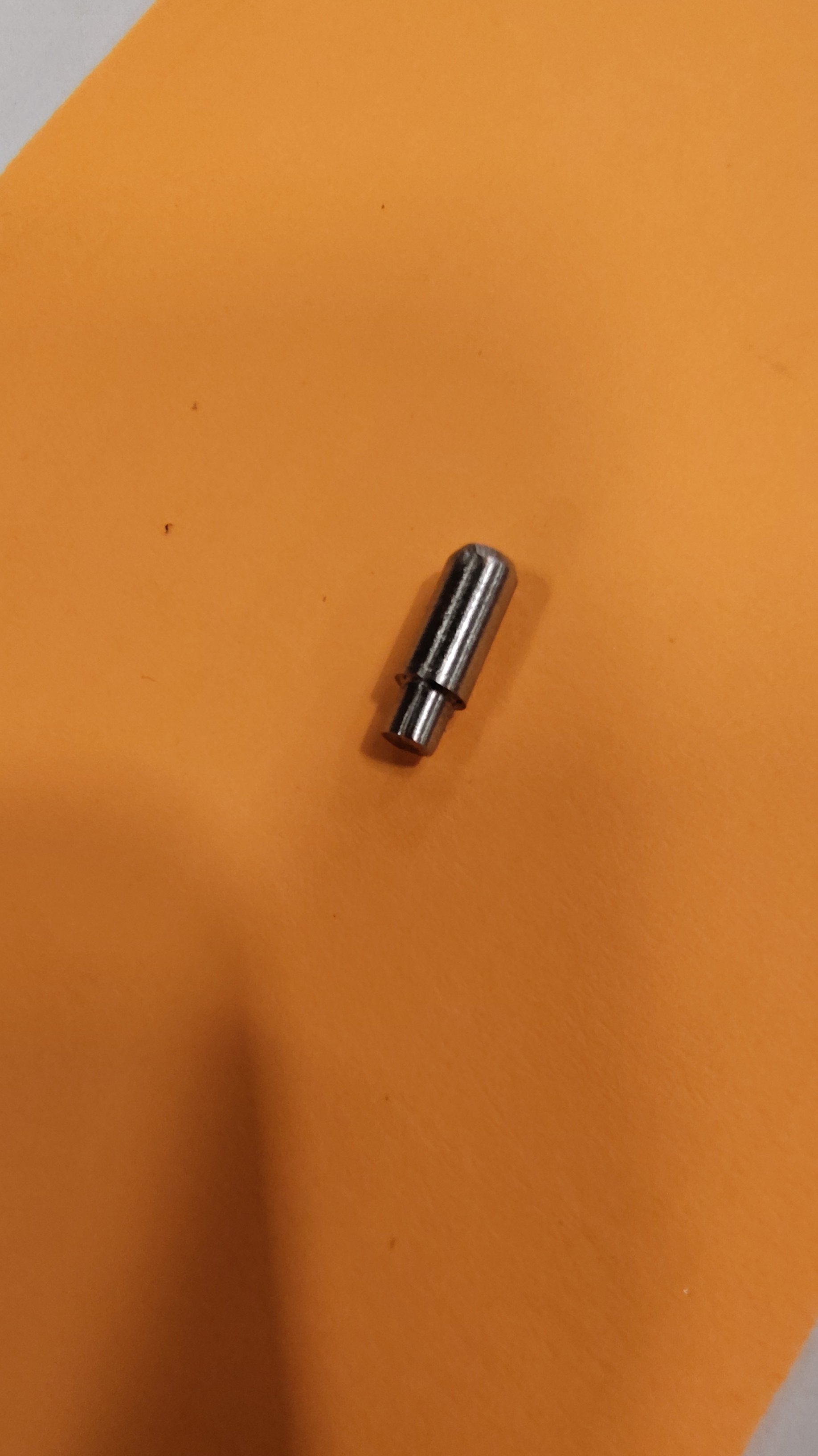

Those recoil pin holes are tiny. I considered making a pin but thought it might shear it off. And it's going to be difficult to get the offset. Most mounts aren't going to center exactly over the holes. I think the hole in the tube should be drilled out large enough for a standard pin. When I take mine apart that's what will happen.
I mounted a 40mm scope with medium Sportsmatch rings without a recoil pin and it walked back in 100 shots. The 34mm scope on low rings held just fine for 1000 shots. A smaller scope on low rings has less inertia and seems to hold much better. If I mount a scope on it again it will be a light 32mm on low mounts.
I shoot mine mostly open sights. I think as hard as it kicks forward a scope will always be trouble without a fat hole in the receiver that will accept a recoil pin.
