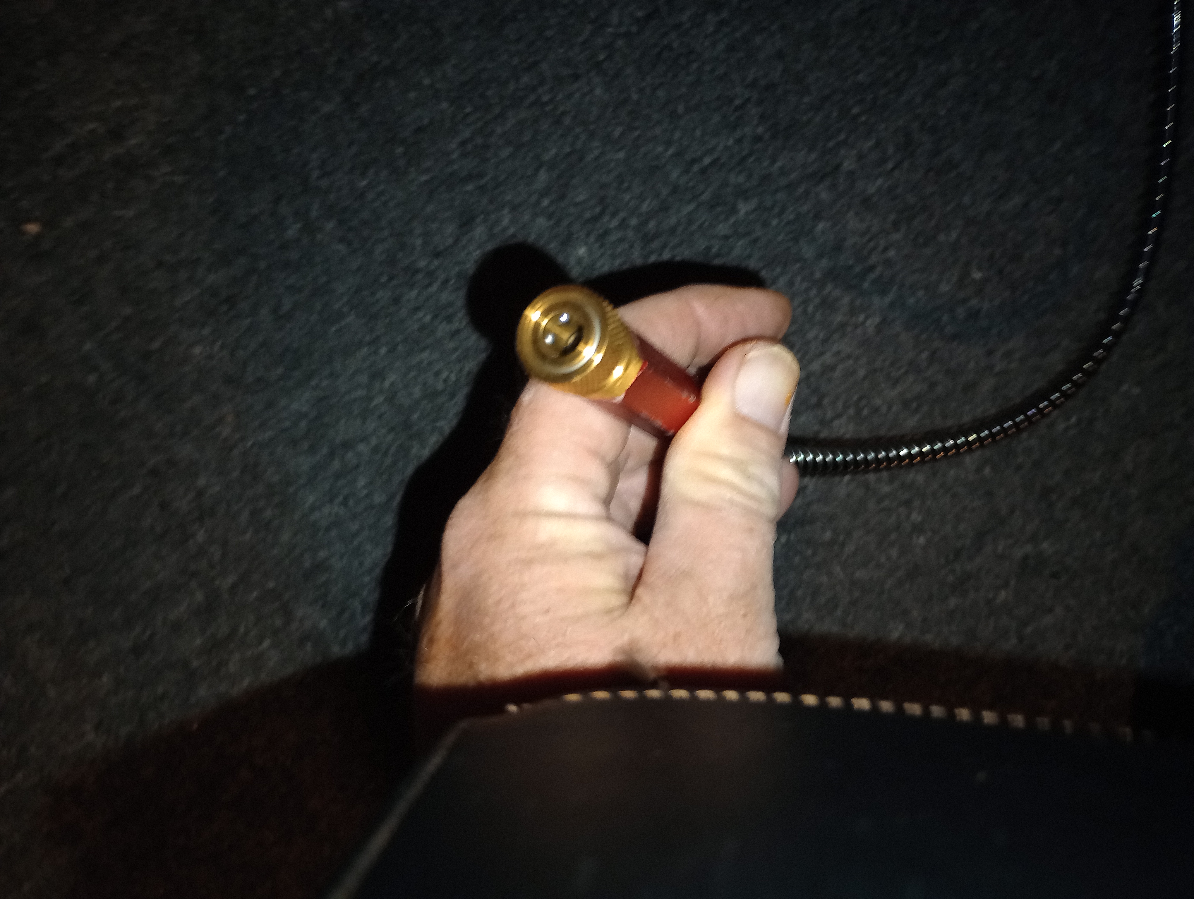

Again, if you have a couple pictures of the set up or a video of what happens when you try to fill, someone here will very likely be able to help you.

I understand you are frustrated and I hope people will stop criticizing your gun and actually try to help. Getting the probe connected to the pump is a one time issue and very solvable. Wish I knew more about Hatsans. A picture of your fill probe would help.
I had to remove the one on hose in hand to put the Hatsan one on it.

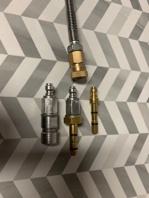

Attached picture shows my fill line connecting to different fill probes.
One one on the left is for my FX guns and it has a quick release coupler from "Best Fittings".
The one in the middle is for my HW100T, also has the quick release coupler.
The one on the right is for my PP700S which fits into the fill line directly.

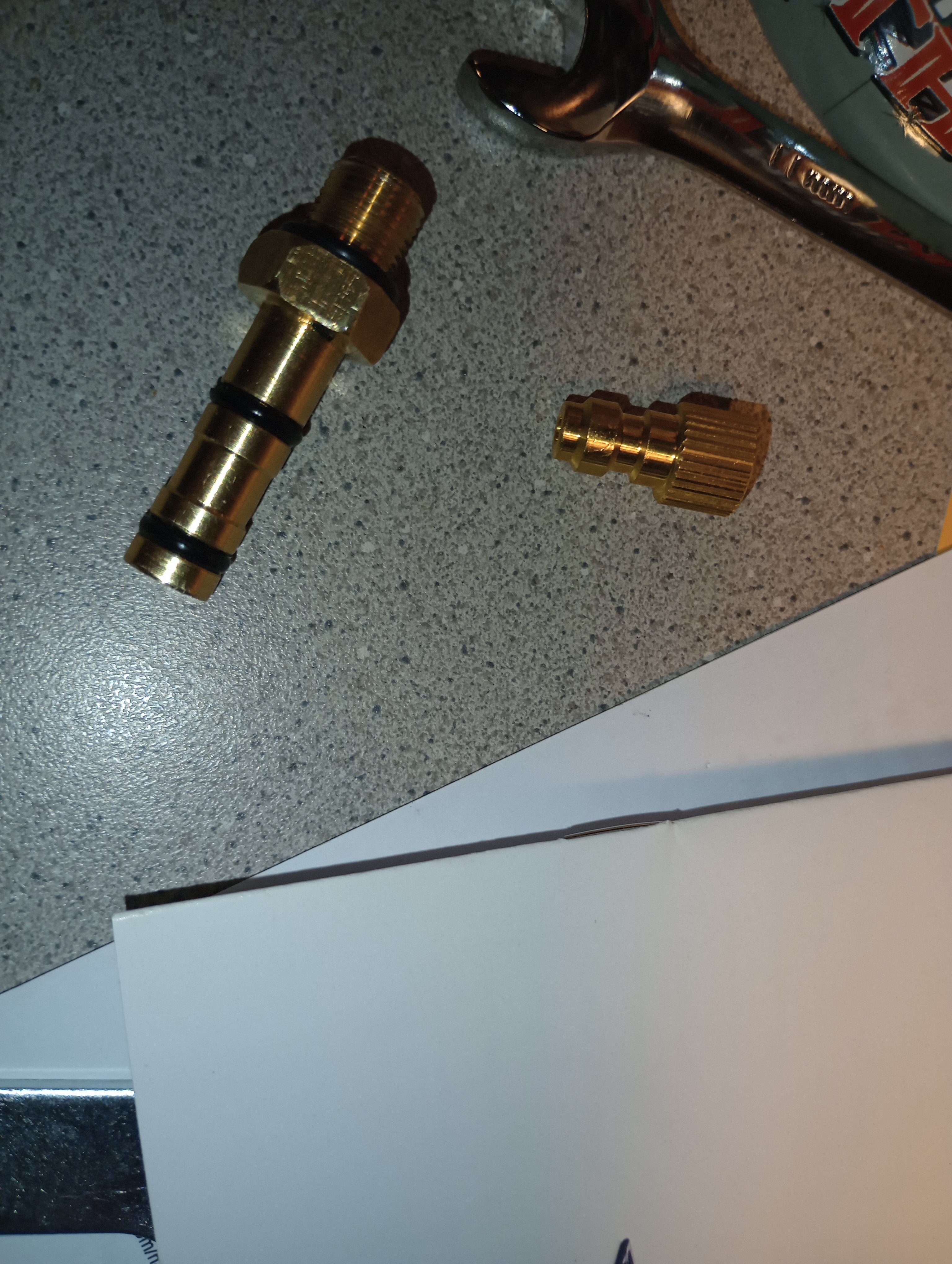

Your second picture showed the small brass coupler beside your Hatsan probe. Does that has a hole at the end and does it fit onto the probe and fill line?
What I see there is a dead head and the hatsan fill probe you need a 1/8 quick connect to add to the fill probe .
The small one that came with the pump fits into the pump. they are smaller than the Hatsan plug. There is no where local I can get one so I can verify the fit. Online I'll just be ordering and getting poop that don't work or fit. Seriously if I had known what a pain in the ass a starter PCP was I wouldn't have bothered. Now i'm in burnt out mode from this poop and the pump I ordered I was told worked with Hatsan another sale I got conned on.
