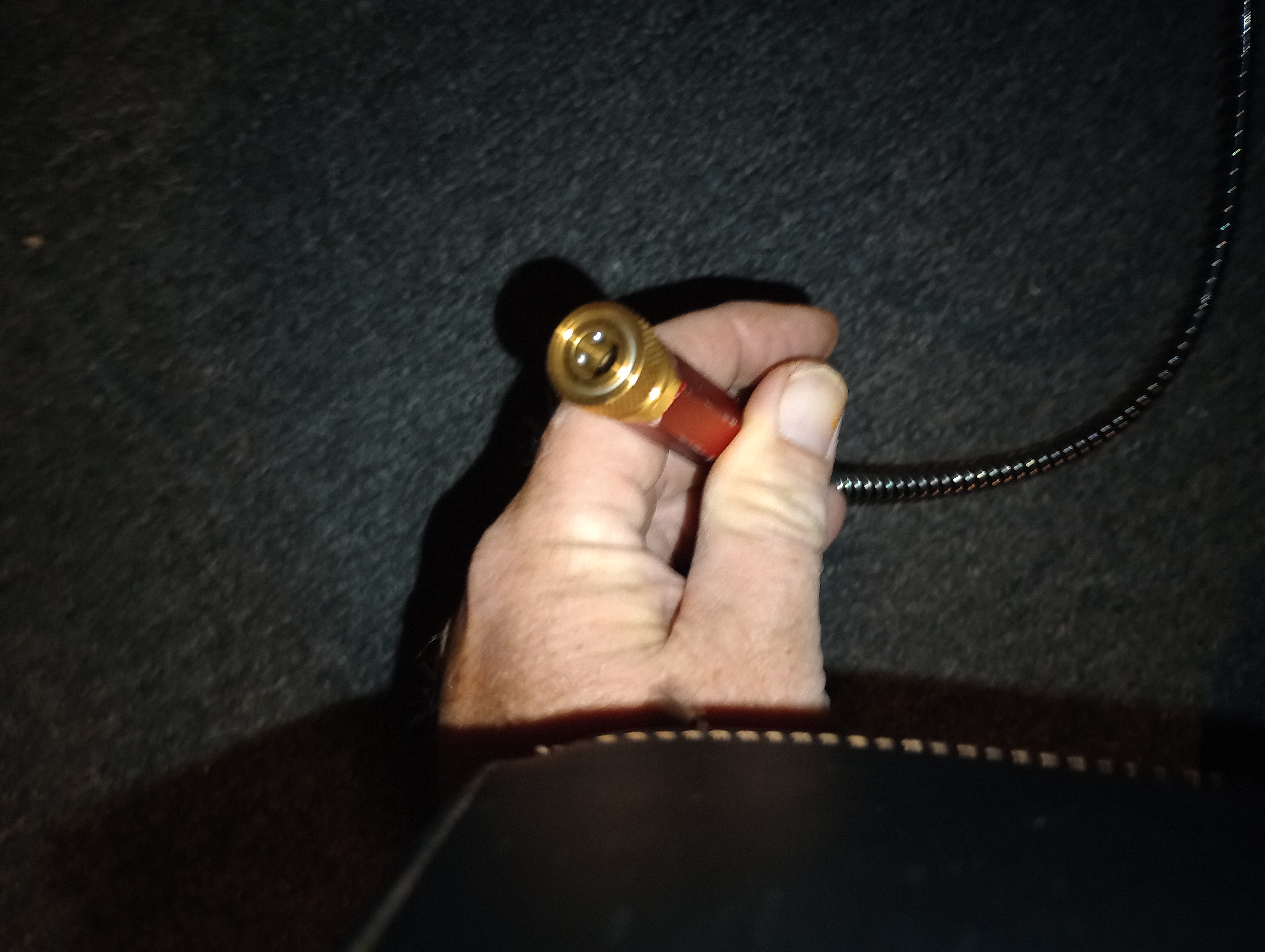

I had to remove the one on hose in hand to put the Hatsan one on it.
the brass part on the right, can you see through it or is it solid? If you connect it to the pump can you pump air through it? if not its a deadhead cap. If you can, Are you able to connect it to the fill adapter and push air through it with the pump or do you get the same result of it maxing out in a few pumps? If not then its the fill adapter thats the problem.
