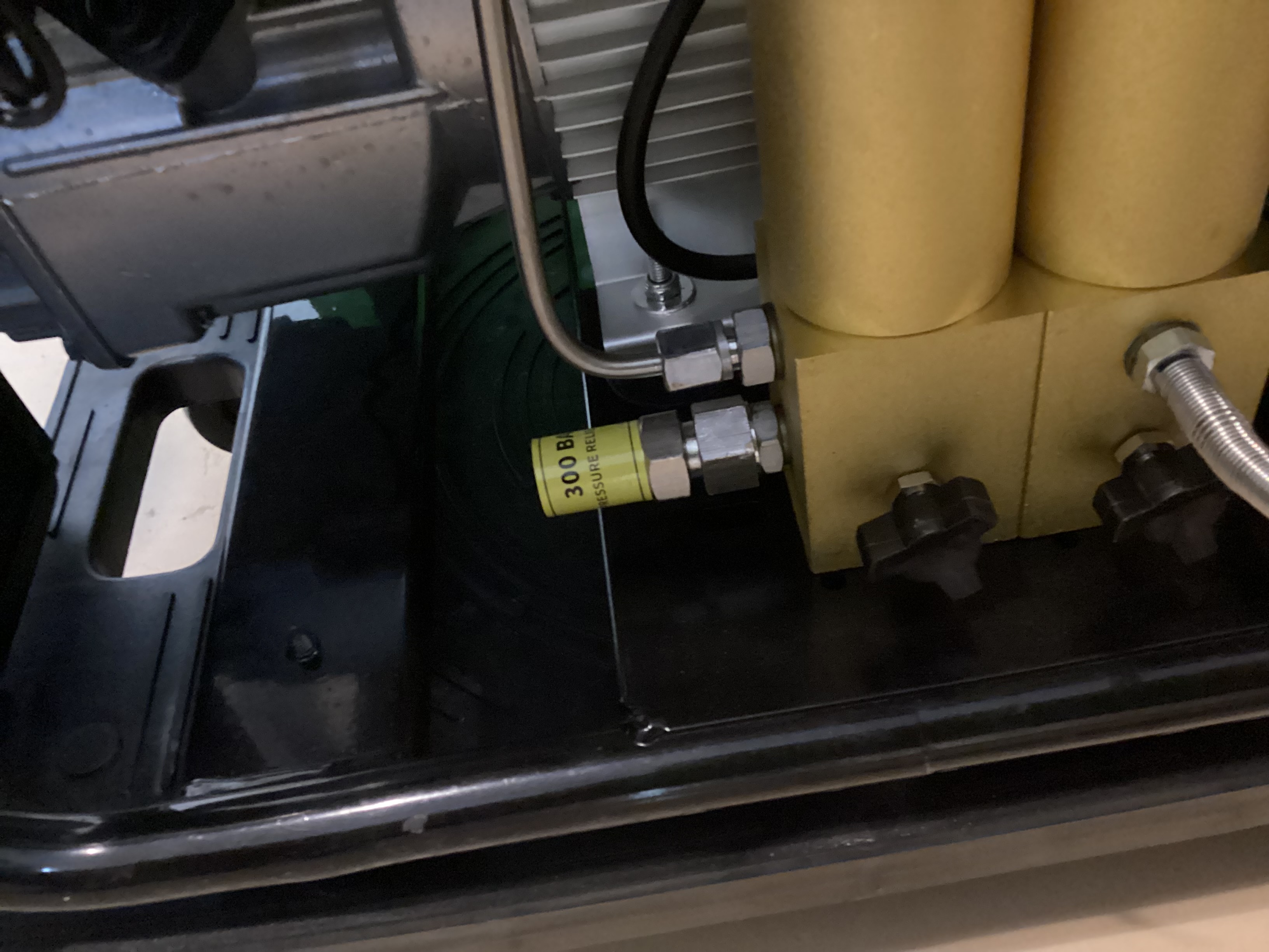

Ssgmac, a couple nights ago I was filling my 9 liter with my Gxcs4i that has the Tuxing twin gold filters . I was letting it go to about 4700 psi but the pressure relief valve opened at just over 4500psi. So I was looking all over Aliexpress and googling to find a higher rated valve. Didn’t find anything so I ordered a 5 and 6k burst disc. Anyway tonight tried with the Tuxing 042 twin which also has the gold twin filters and ran it up to 4900 psi on a 6.8 and the 9 liter with no problem. Then I saw this post.
So I can adjust these ? Pic to concur we’re talking about the same thing. If so, how ?

So I can adjust these ? Pic to concur we’re talking about the same thing. If so, how ?View attachment 550177
Yes sir. Do you see the yellow sticker is on the stainless steel thing that looks kind of like a spark plug at the very bottom of twin filters? I think it was a 7/8 inch deep well socket that fit right over that and just crank it in just about a turn probably will do it . I did mine about one and a half. Just turn the outermost hex nut. The deep one
Edit: the blue arrow in the screenshot is a little confusing. It's righty tighty, like on an oxygen or acetylene regulator or air compressor LOL
