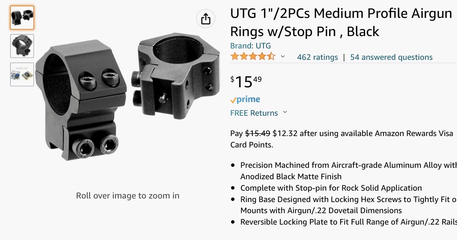

Air Rifle Scope Two Piece Ring Mounts for 1 inch tube
Air rifle scope two piece ring mounts for 1 inch tube rifle scope is very easy to install. Deluxe scope mounts from Gamo.gamousa.com
Says what? The pin? You can ser it in the picture. If you look a most "air gun" mounts you see the hole for the pin /hex wrench in the bottom 1/2 of one of the rings.. when in doubt e mail there support...Good Intel, but I can't see anything that link where it says that.

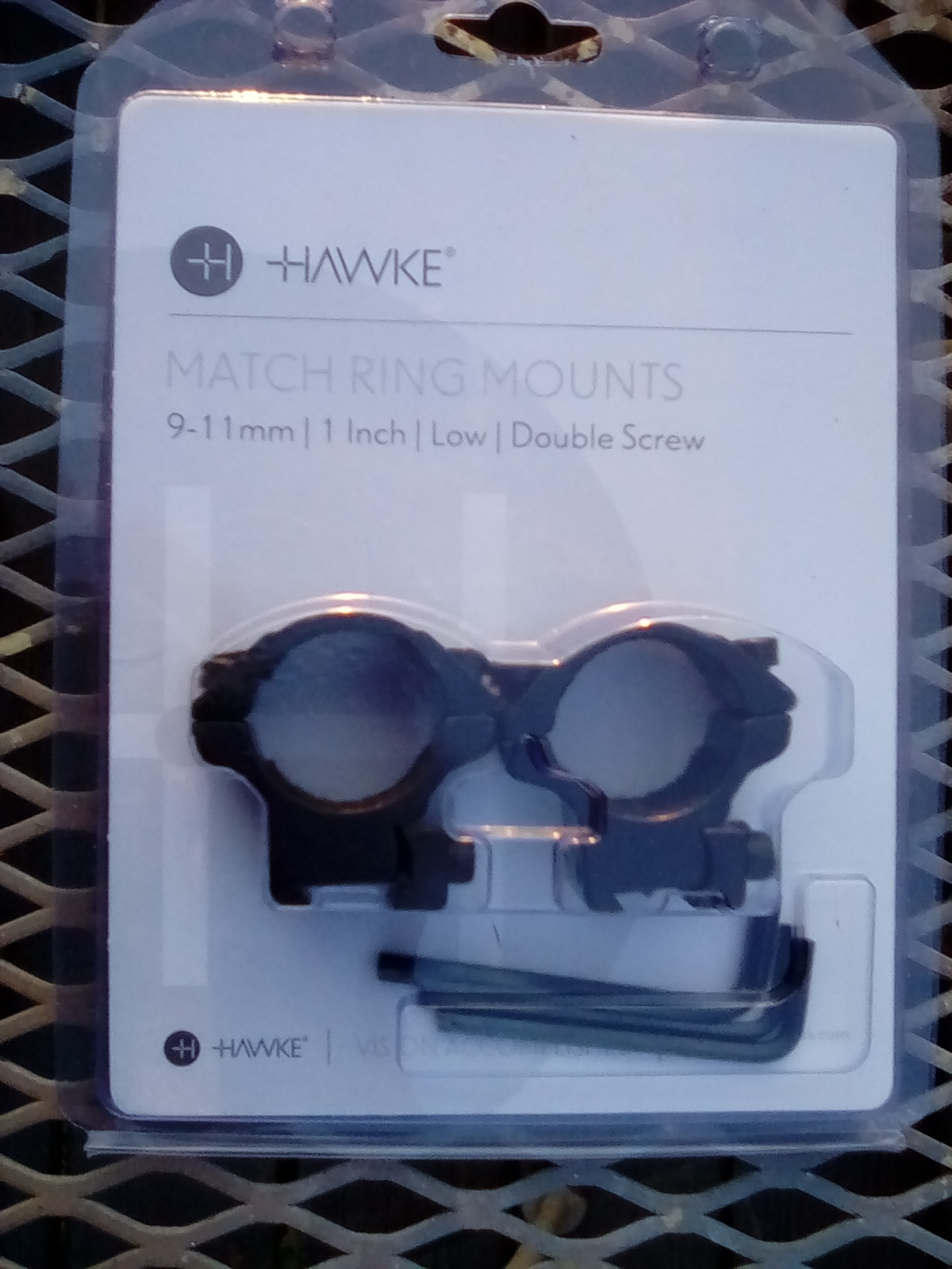

To help dig in to the receiver.. or pumch its own stop hole ... . lolTake a very small file to that Hawke stop pin and file the point off so the bottom of the pin is flat. No clue why they make them that way, but you can get more of the pin down in the hole to do the job it's meant for if you do.

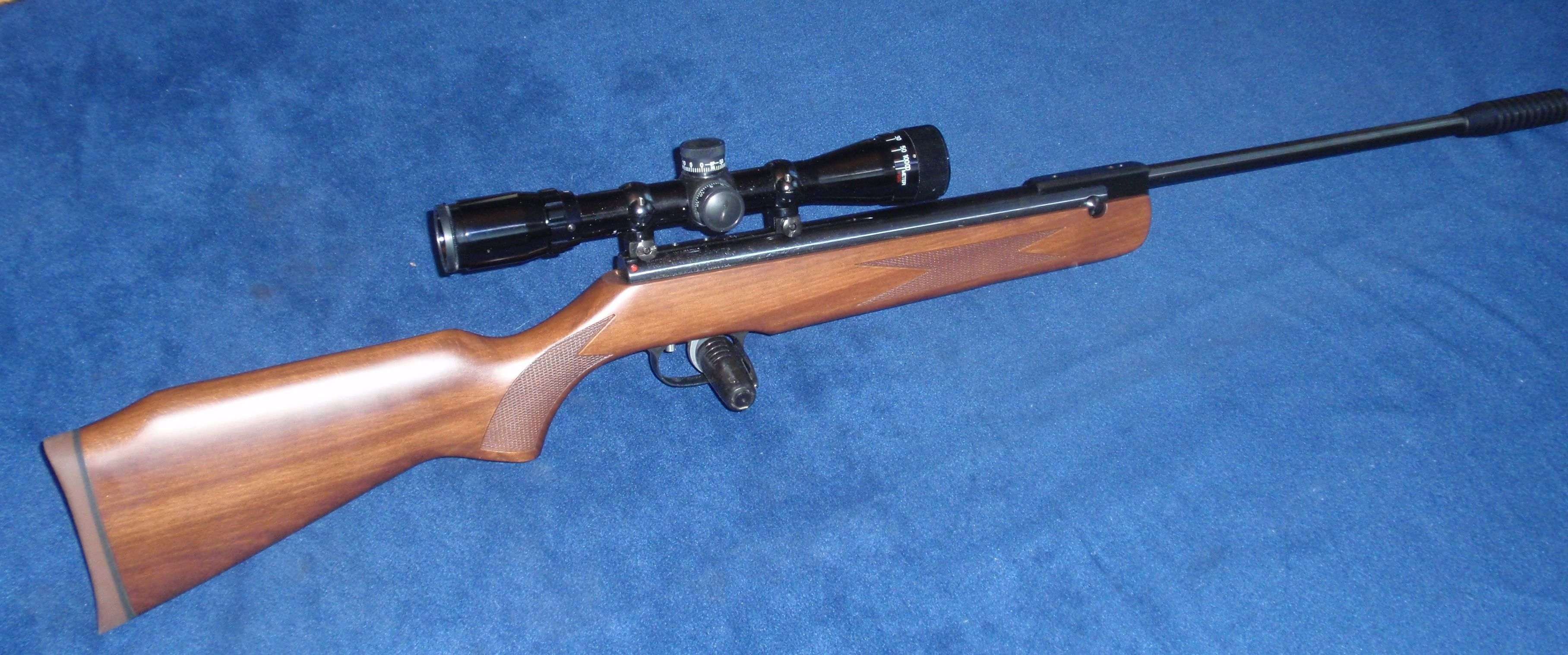

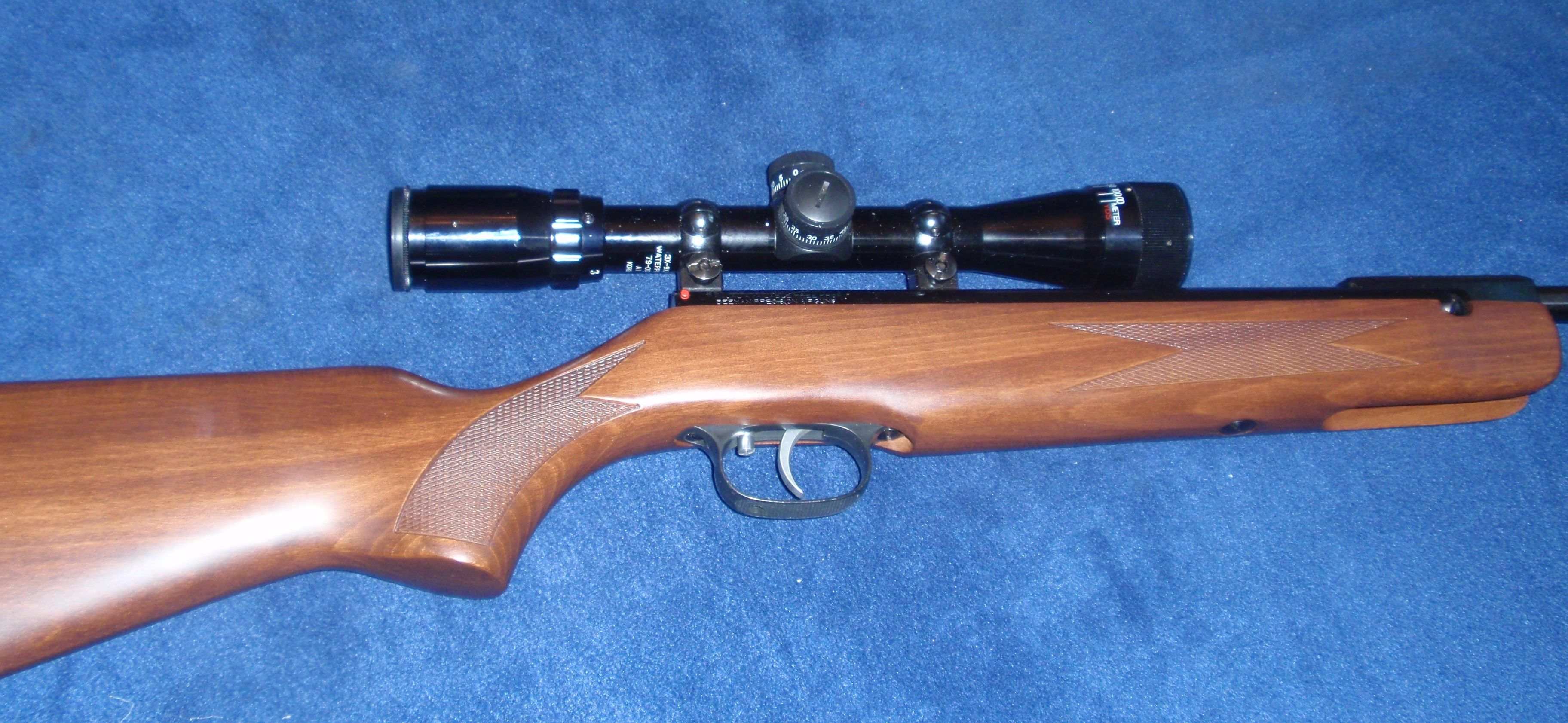

SportsMatch T04C medium rings on my HW95L with a Hawke 3-9 x 40 mm AO scope.SportsMatch scroll down to see what size you need and click the colored square to see model number , then do a google search for that model to find dealers
