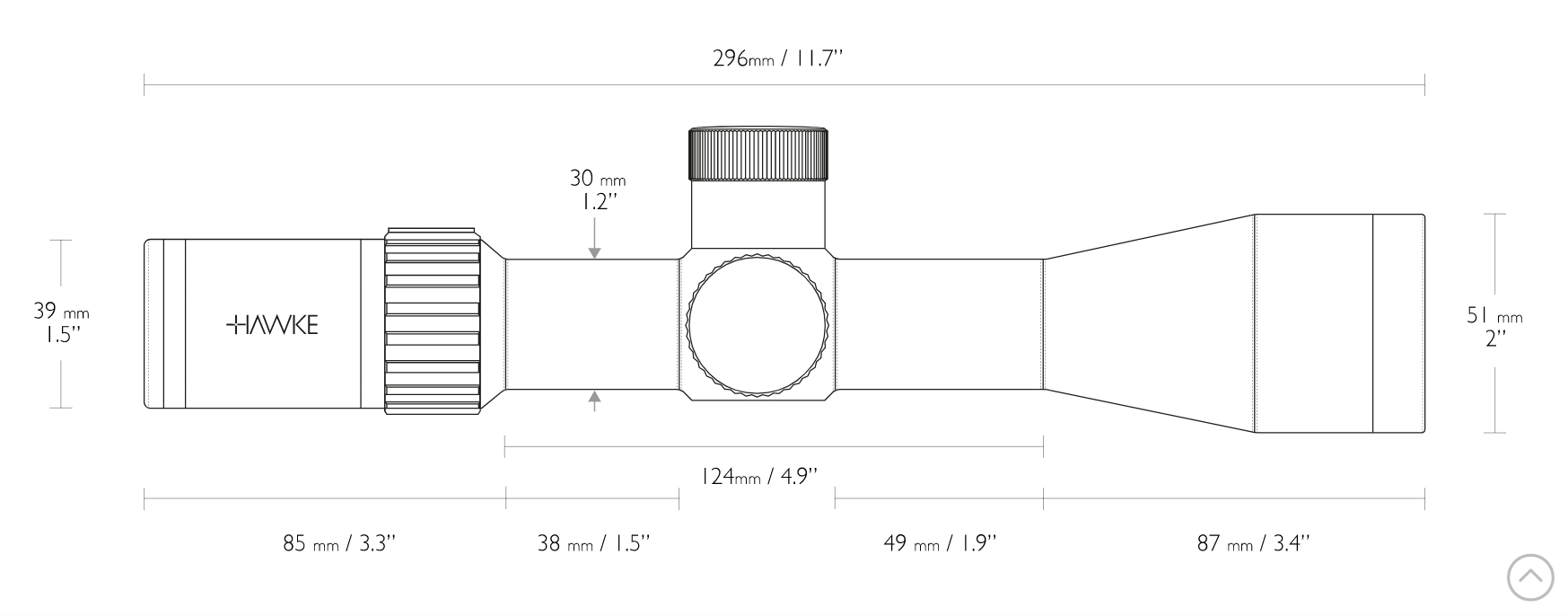

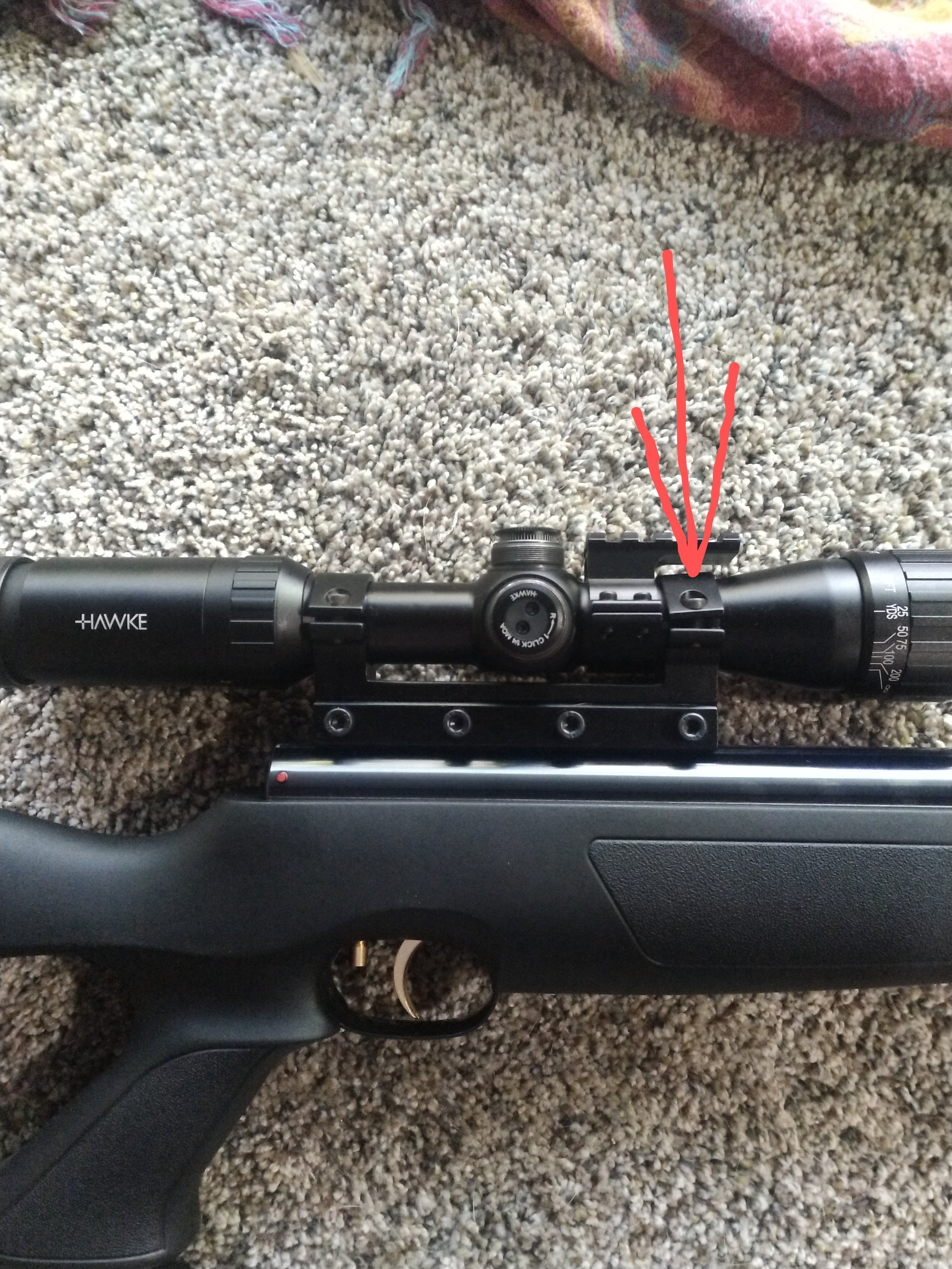

Here's my debacle: I have a quality one piece mount on the HW97, but it's too long for my 2x7 scope (see pic where it's clamped on the tapered part of scope). I love this scope, but my choice is to put 2 piece mounts on the 97, or buy a longer scope for it, and put the 2x7 on the HW50. My options are somewhat open in that I currently only own one scope.
Reactions: Hateful McNasty
Hawkes can be short for most one piece mounts. Thats why you look up at the Scopes specs from the manufacturer then the one piece mounts specs to insure the tube fits and the height so the Scopes used its belly or that little plug dont bottom out or the lens bell hits .. dont feel like the lone ranger..
( Been there🤤 ,done that😉, learned👍..lol)
P.s just to add with hawks short tube that may make the set back / off set 2 piece rings more appealing ( opinion)
