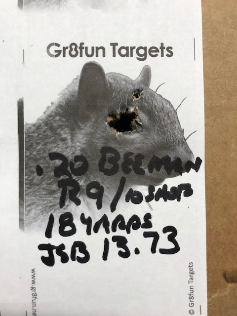

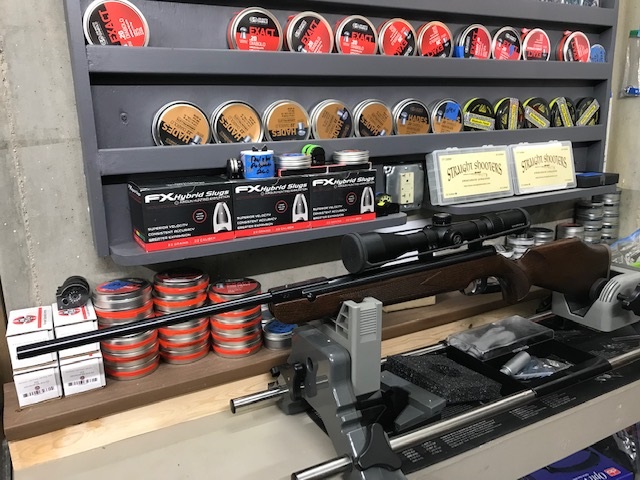

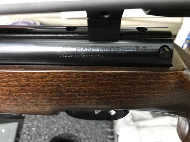

Testing began, shooting two ten shot groups each with four different pellets, to find the best pellet match, of the pellets I had on hand, for this rifle. The results can be seen in the accompanying exhibits. Note that Tom produced a spring kit that provided the exact power output I was looking for.
The real proof as to the accuracy and consistency of these rifles can be seen on the final test target, the squirrel target, as found below, putting 9 of the 10 pellets in nearly the same hole. Bear in mind that this is only +/- 120 shots after spring installation. From my experience, it will only get better and likely won't hit its peak performance until after 800 to 1000 shots have been fired.
