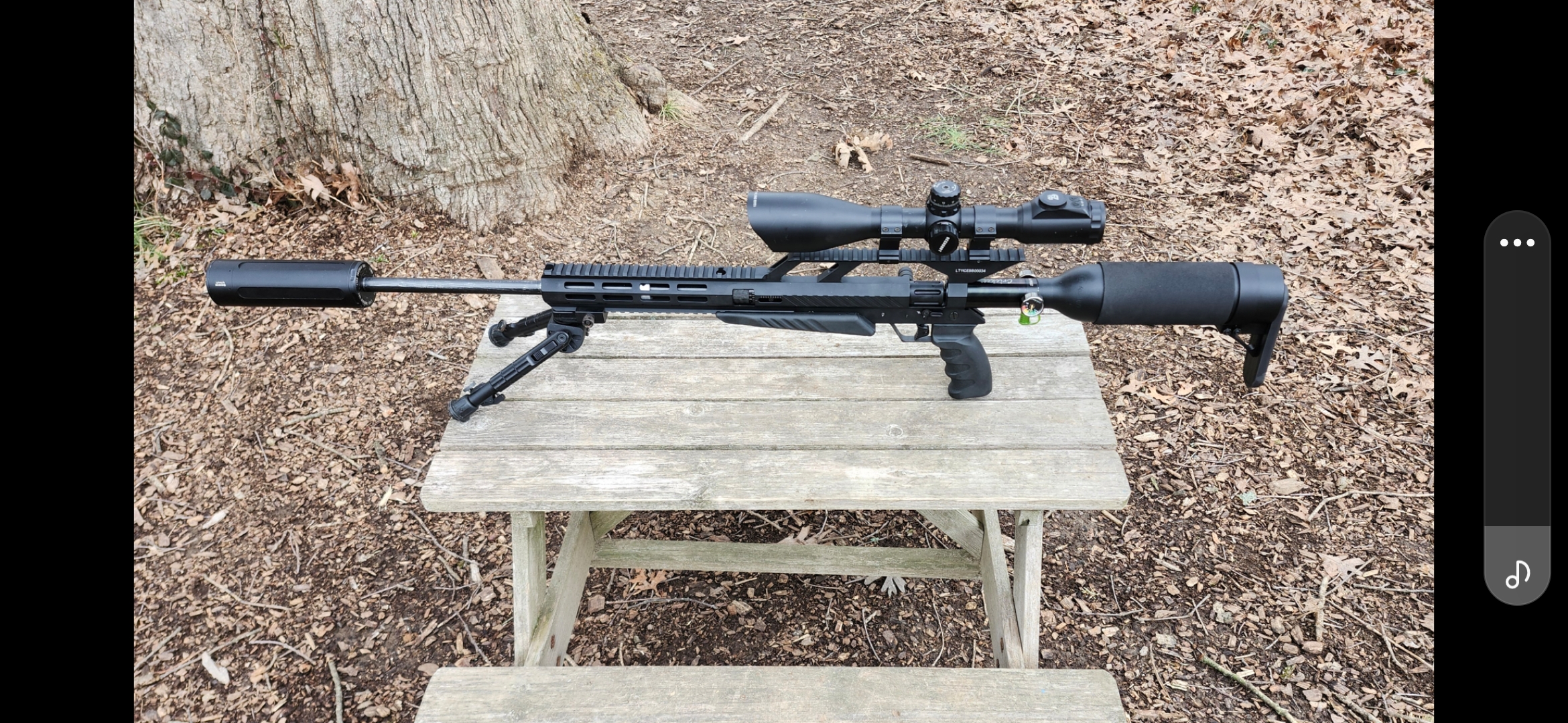

This is the Airforce Clonish style Pinty Tactical. I just made a 24" .20 barrel for it off an HW110 (it was also a new barrel not a takeoff) it's regulated and you can buy the rifle new I'll upgrade your trigger and add the barrel. Gun is $250 new. The trigger and barrel are also $250 so for around $540 shipped you get a brand new regulated .20 that shoots 13.58gr Baracuda pellets between 800-1100fps depending on reg setting and power wheel. Trigger breaks between 1 and 1-1/2lb.
There is a nice 19 page thread about these rifles just a few posts down for you to check out.
