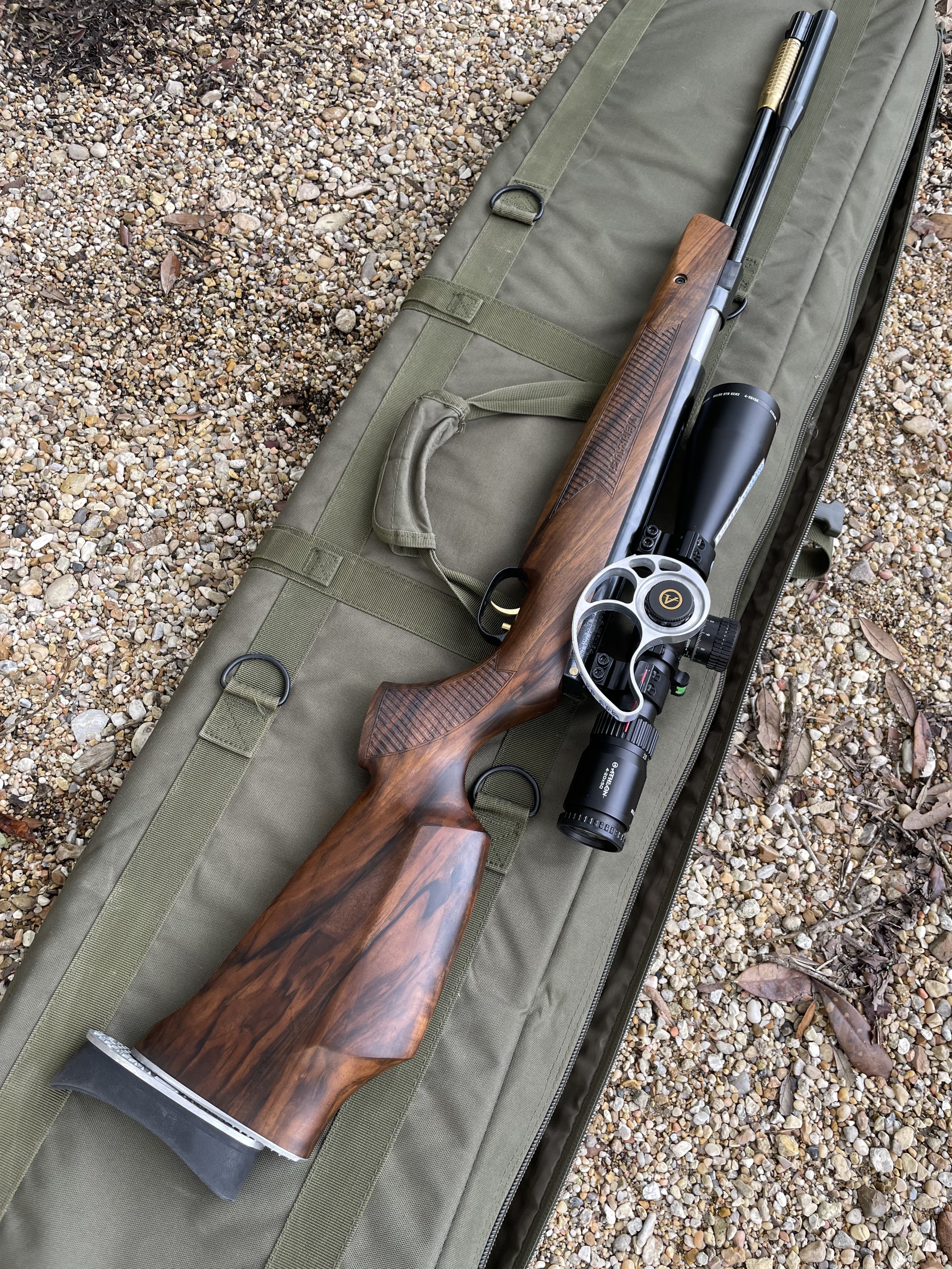

I bought my first .20 in June, a ‘97 with walnut stock, and I’m a believer. It’s shooting JSB 13.73 around 720fps with a John in PA tune. I’ve owned maybe 6 or 8 .177 spring guns from Weihrauch and Air Arms and have never been able to shoot groups like I have with this one. I absolutely love it.
That may be the best looking walnut Weihrauch stock I've seen yet.🔥✅

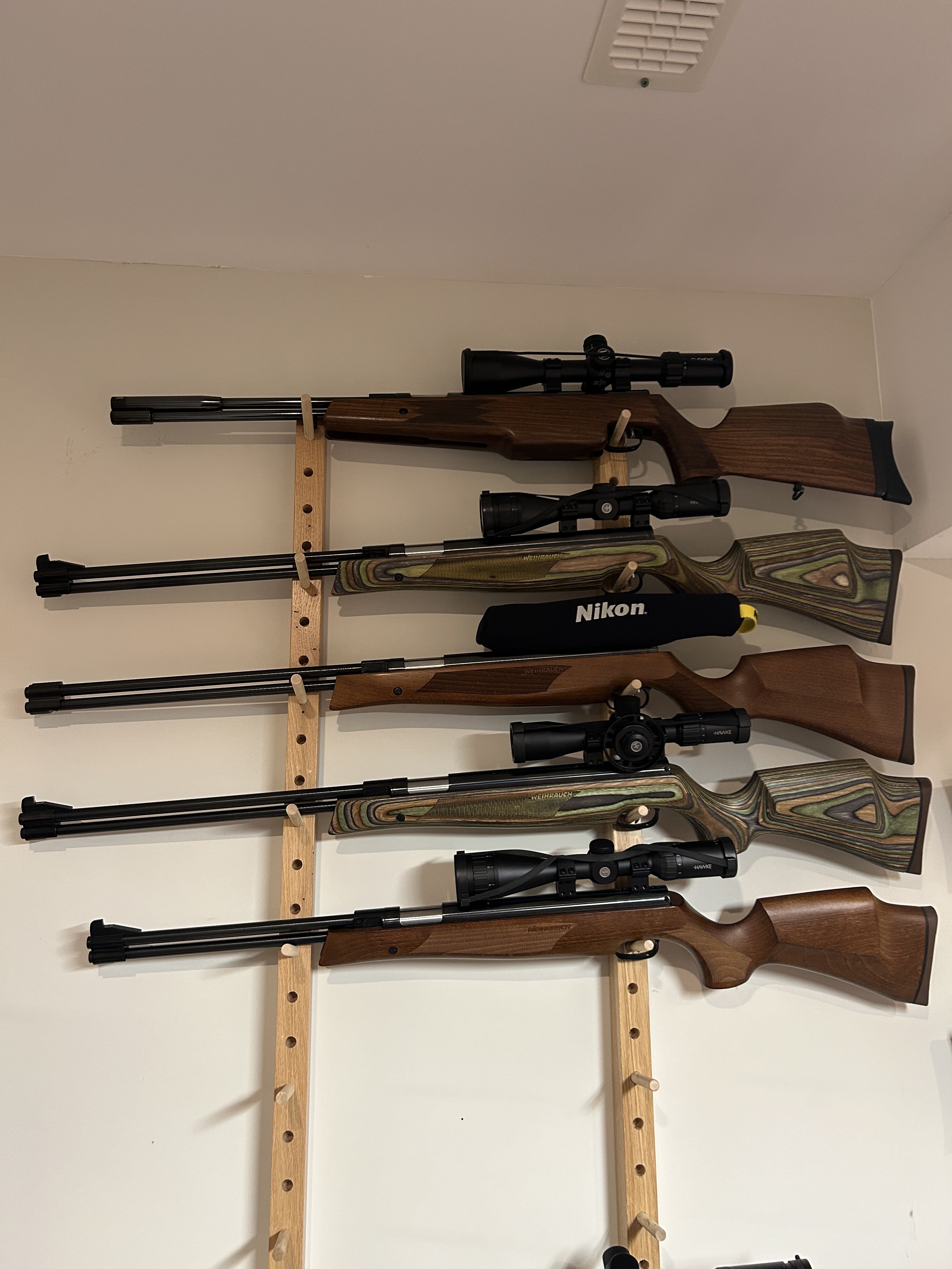

Here’s my 77’s
Top is Venum stock and tuned .22 cal.
Top lam .177 cal.
3+4 are .22 cal.
Bottom .25 cal. ( a favorite )
I’d be curious if ours come at the same time.

Here’s my 77’sView attachment 495116Top is Venum stock and tuned .22 cal.
Top lam .177 cal.
3+4 are .22 cal.
Nice buy, good luck. Crow
Where did you buy that from?
Absolutely beautiful!!!
