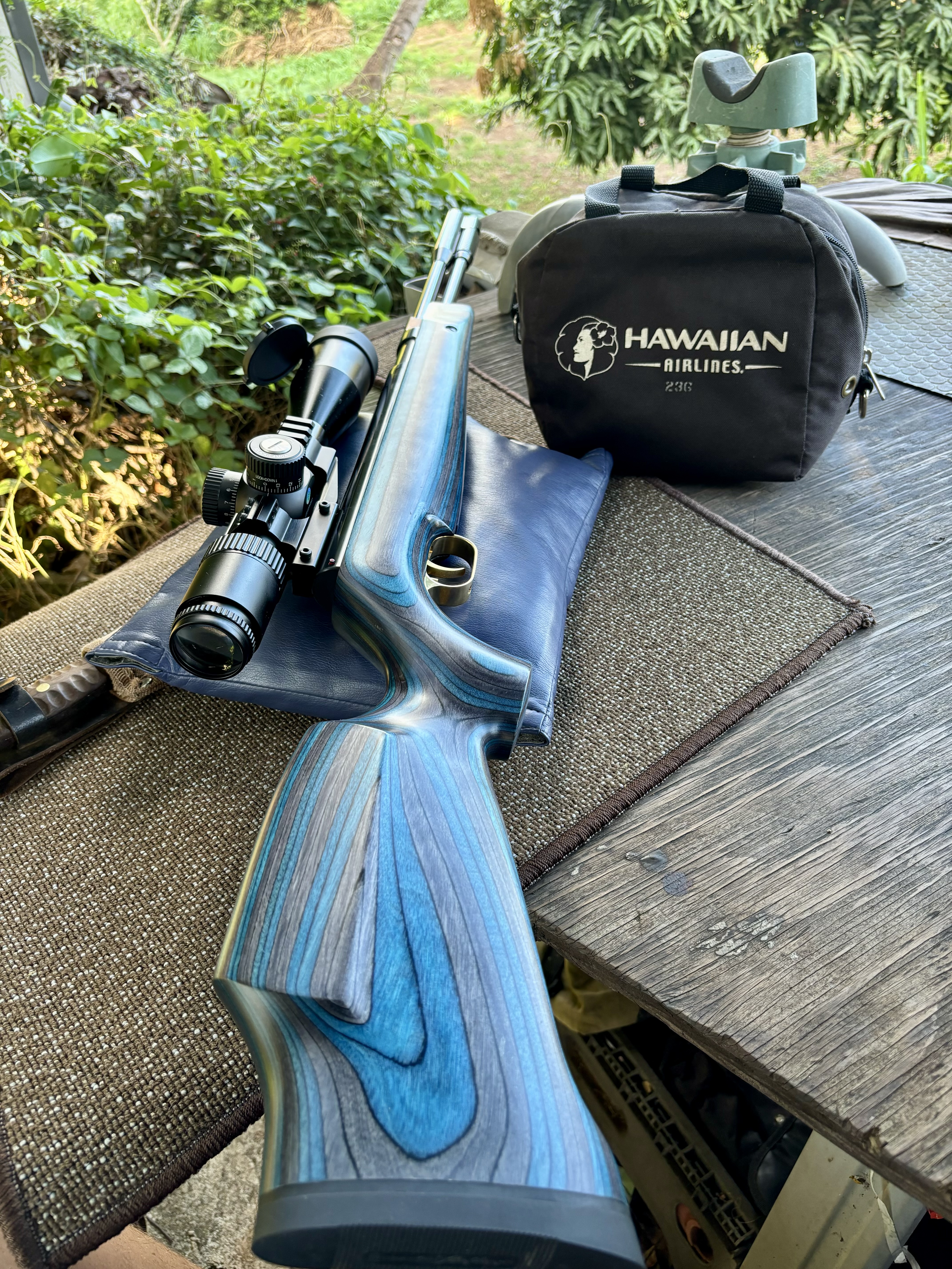

I bought my first .20 in June, a ‘97 with walnut stock, and I’m a believer. It’s shooting JSB 13.73 around 720fps with a John in PA tune. I’ve owned maybe 6 or 8 .177 spring guns from Weihrauch and Air Arms and have never been able to shoot groups like I have with this one. I absolutely love it.
Smokin specimen...wow man 😮 (y)
