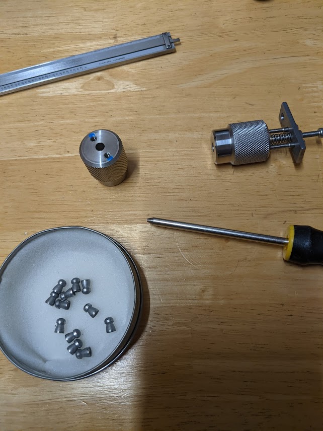

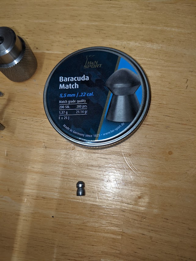

Decided to go for it and ordered the TR Robb sizers in .22 and .20. Took a few weeks but they arrived day before yesterday. Working nights and the whole shift I was itching to get home and try them out yesterday morning.

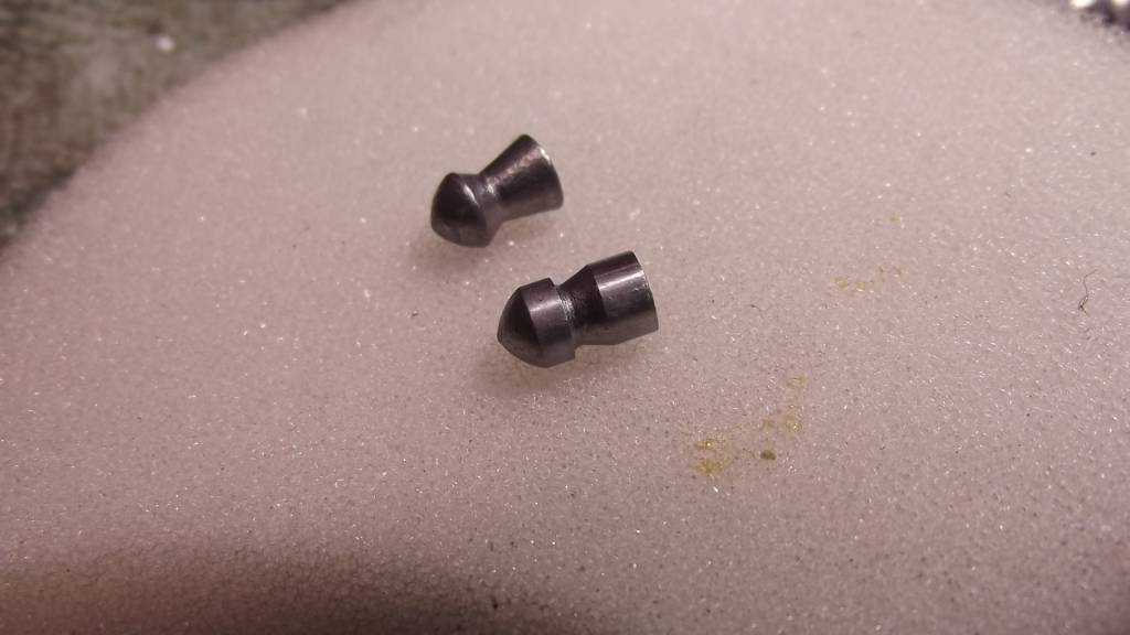

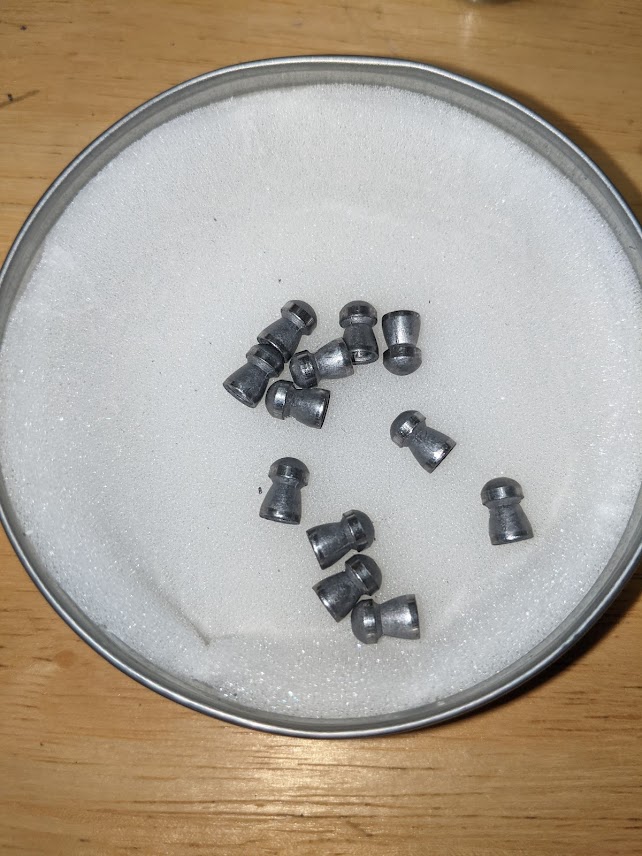

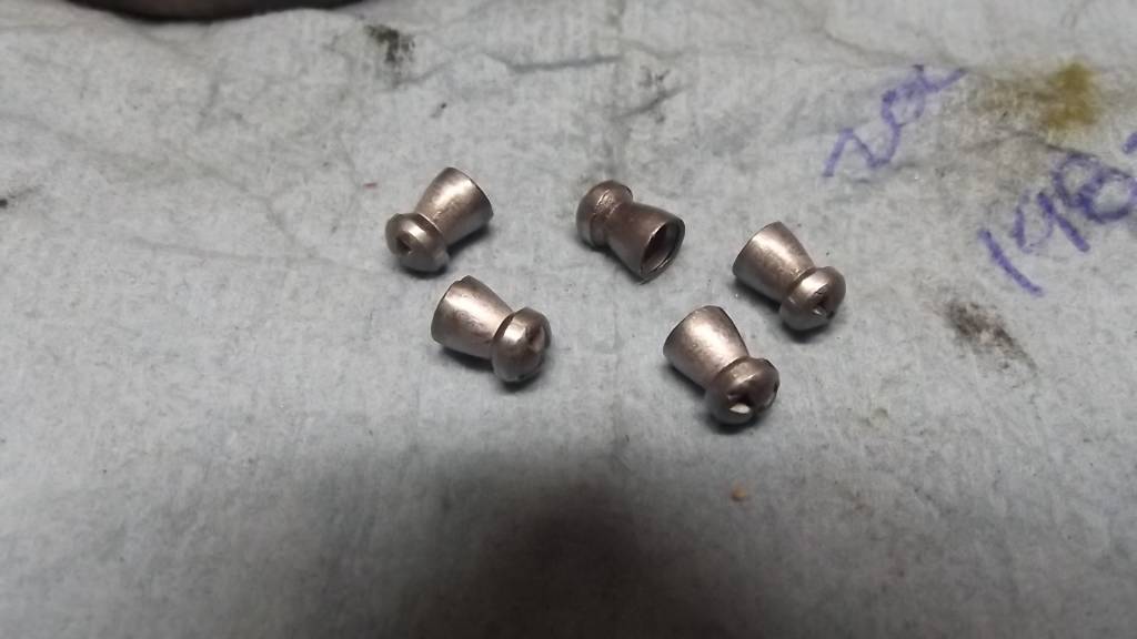

First step was to removed the stop on the .22. Two bolts and it comes right off. Tapped a .22 all the way through with a rubber mallet, using the pusher it came with. Pellet was TOUGH to get through, and came out with a thoroughly mangled, nearly ripped off skirt. Well, that's not gonna work. Close inspection showed that the tip of the pusher it came with was too blunt, and the skirt was being pushed between the walls of the sizer and the shaft of the pusher, ripping it. Two options at that point, modify the pusher, or "make" my own. Issued pusher is a bit short for pushing pellets all the way through the sizer so found an old phillips screwdriver with a mangled tip, and cut off the "phillips" part. 3 minutes with the belt sander (yeah, you machinists are cringing) and I was in business, flat tip with a steep enough angled cone to keep the shaft area of the pusher safely behind the skirt in the die.
Measured those best I could with a caliper and head size was about 0.210. Tested a couple in the .20 sizer, and after a few adjustments could get them to a pretty consistent head size of 0.2 and skirt of 0.206. My comparison .20 factory were coming out of a tin of JSB 15.89s. The factory .20s were measuring 0.2 on the head, and .209-.210 on the skirt. So, the die has a bit steep taper than the factory .20s, at least from that one tin.
I'm able to push them through both steps of the sizing with just the screwdriver and hand pressure, no rubber mallet necessary.

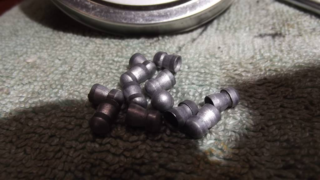

Chambered one and it went in like butter, just as smooth as a factory .20.
The results...
(was pushing them a bit too hard into the stop and giving them a small flat, almost a meplat, was able to mostly do away with that on the second batch).

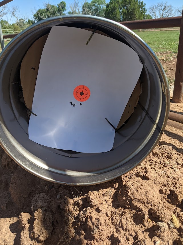

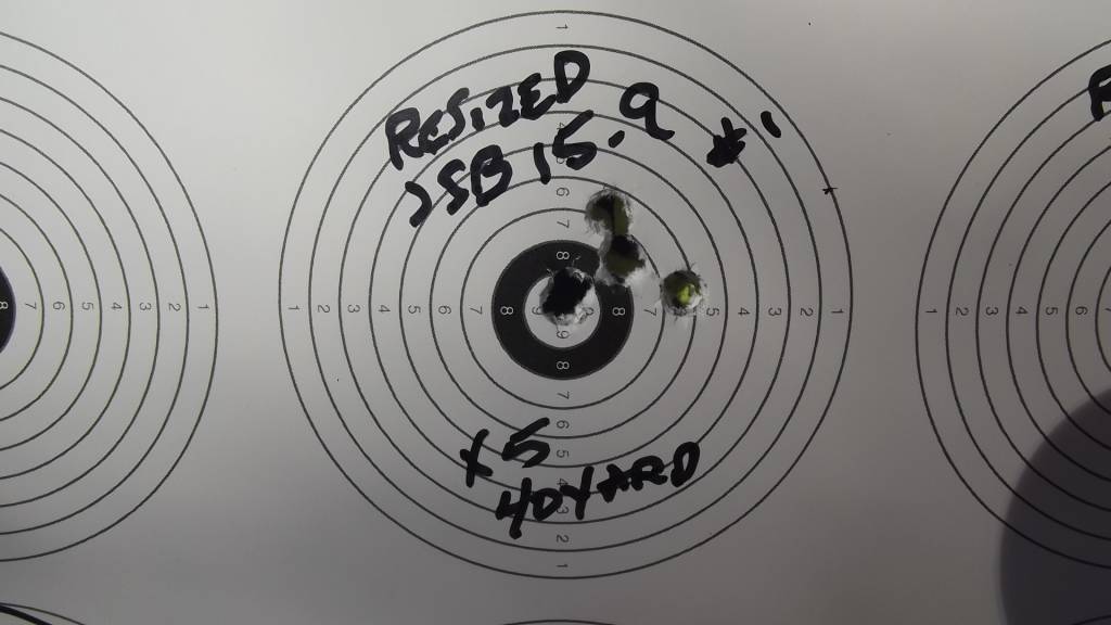

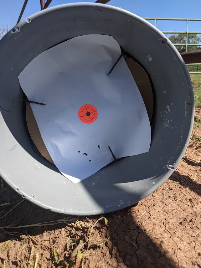

First 5 shots @ 46 yards

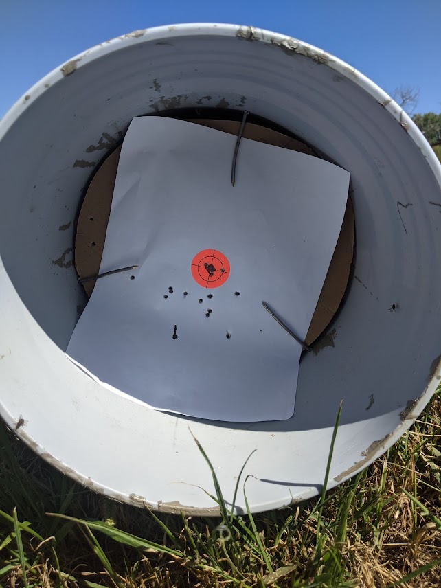

First 5 shots @ 71 yards (with 1mil elevation added to the turret)

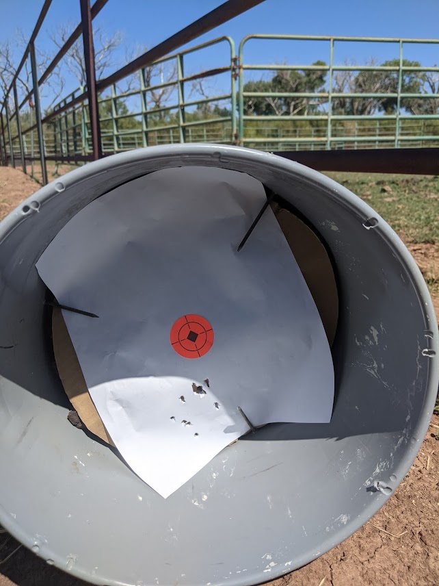

And then about 15 @ 92 yards (top three up in the orange were the last three, FAR below reg pressure so fps was up so they hit higher).

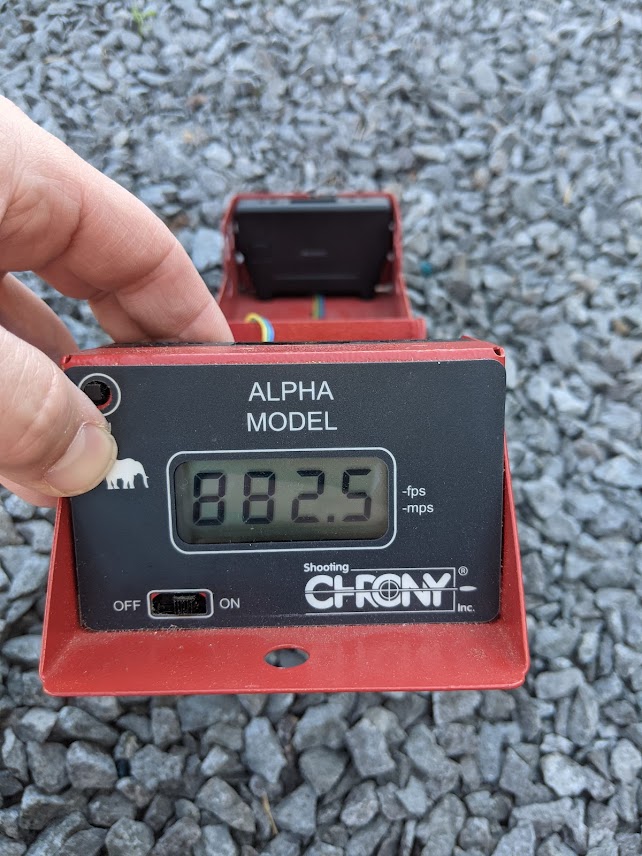

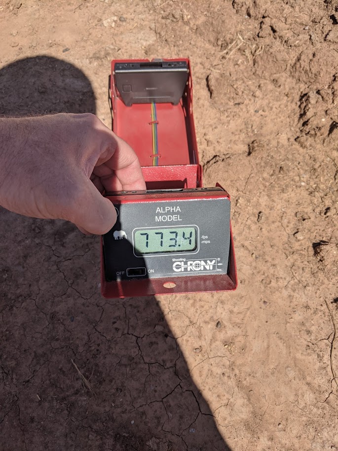

Also decided to up the power and bit and get out the chrono. Went one half revolution "in" on the hammer tension to get to here (5 shot average at the muzzle).
So about 31-32fpe.

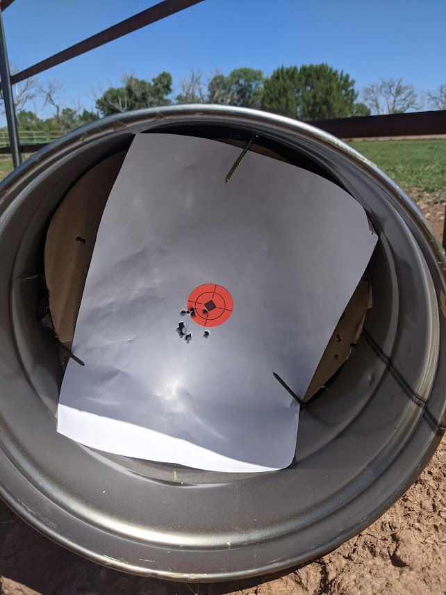

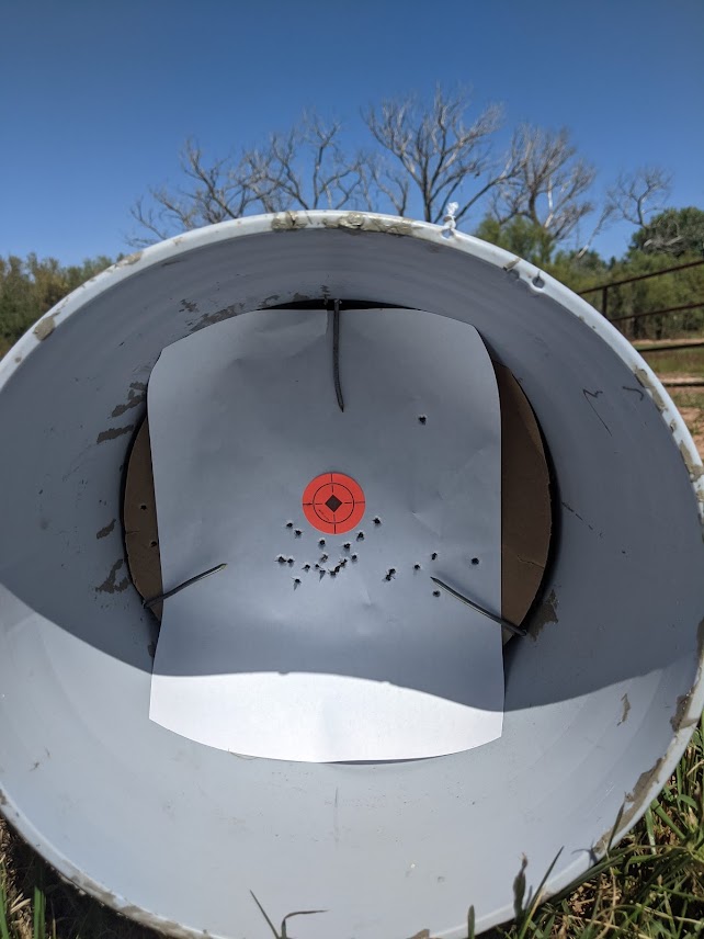

5 @ 46 (the new holes, compare to previous 46 yard target)
5@71 yards (new holes again)
and about 25 shots @ 92 yards (entirely new paper here)
The upper right hole was my guess at turret elevation, took it down some after that first high shot. From there I didn't do any adjustments for wind or anything else, just held on the middle of the orange. The holes off to the right are where the wind was pushing them as it was a bit gusty. But the bulk of them in that main cluster are a pretty good representation of what it can do.
All shots taken from horribly uncomfortable prone position (breaks my neck every time). I could shrink them with less caffeine and more sleep in my system, and from a bench, and holding off for wind.
The results...
So about 31-32fpe.
