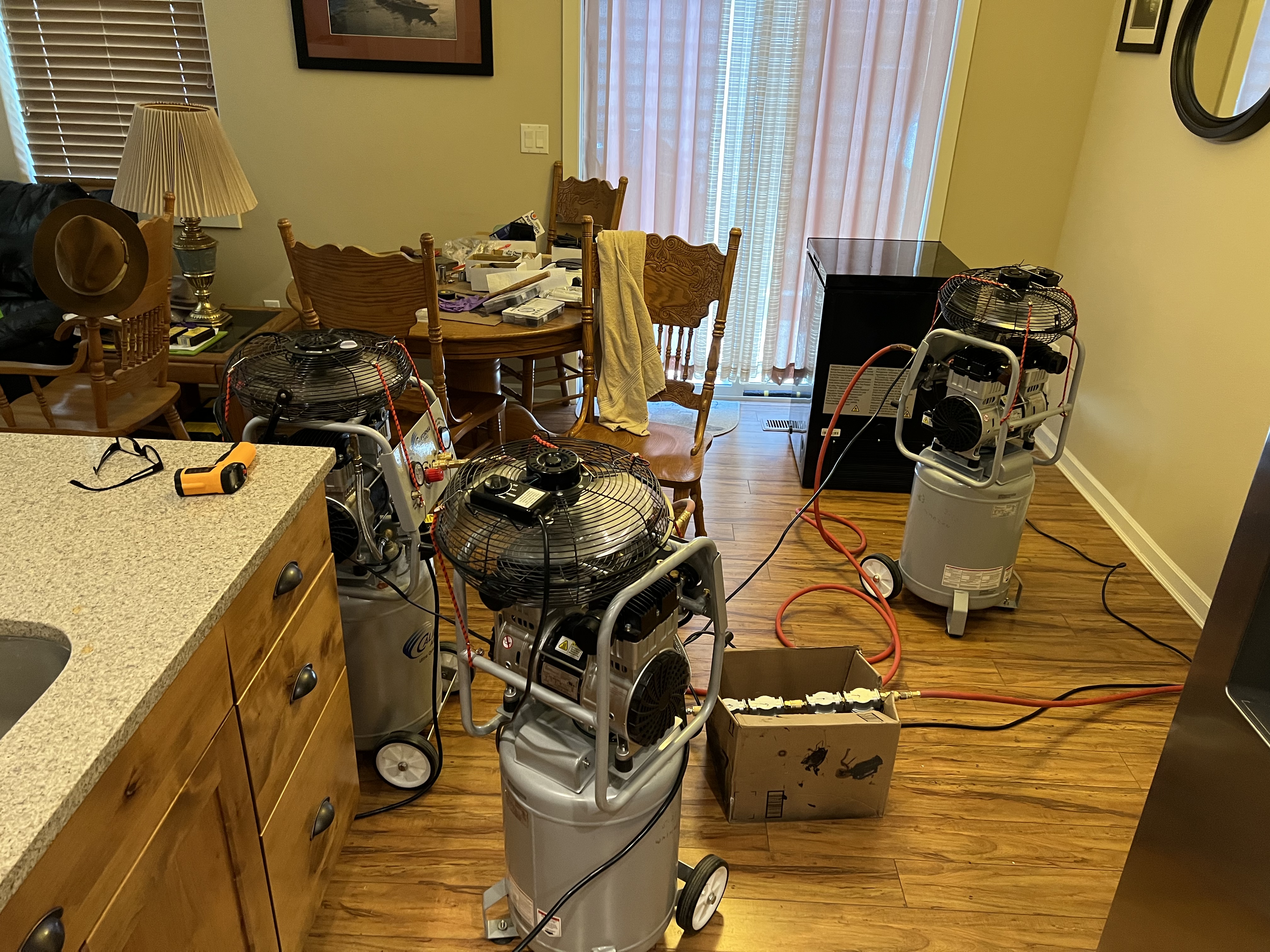

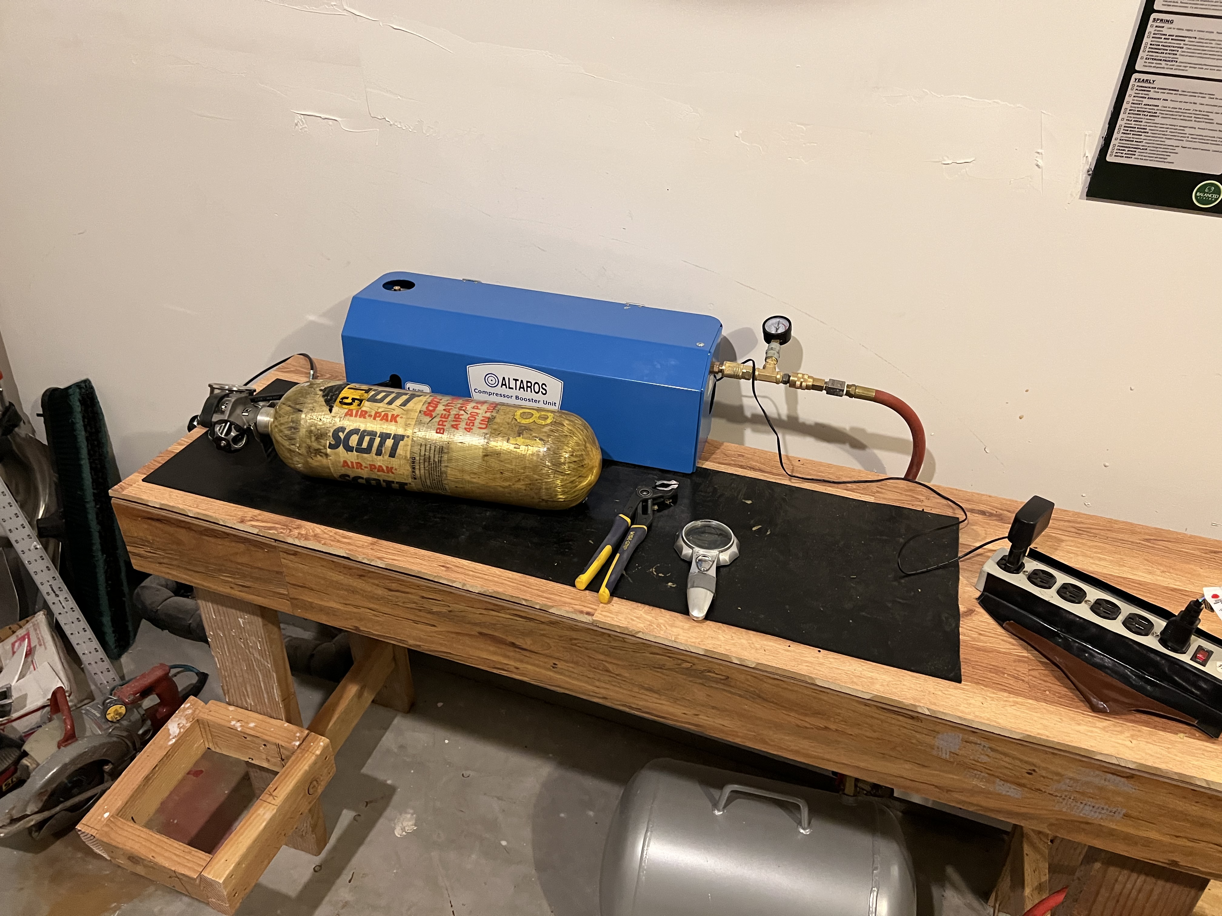

I have been using a Altaros booster now for 20 months, maybe 12 to 15 hours a month.
I started with one drive shop compressor, a CaliforniaAirTools 2 hp 110volt, to which I strapped a 12 inch cooling fan to the top. Soon I added a 2nd Cat compressor and a few months back a third Cat.

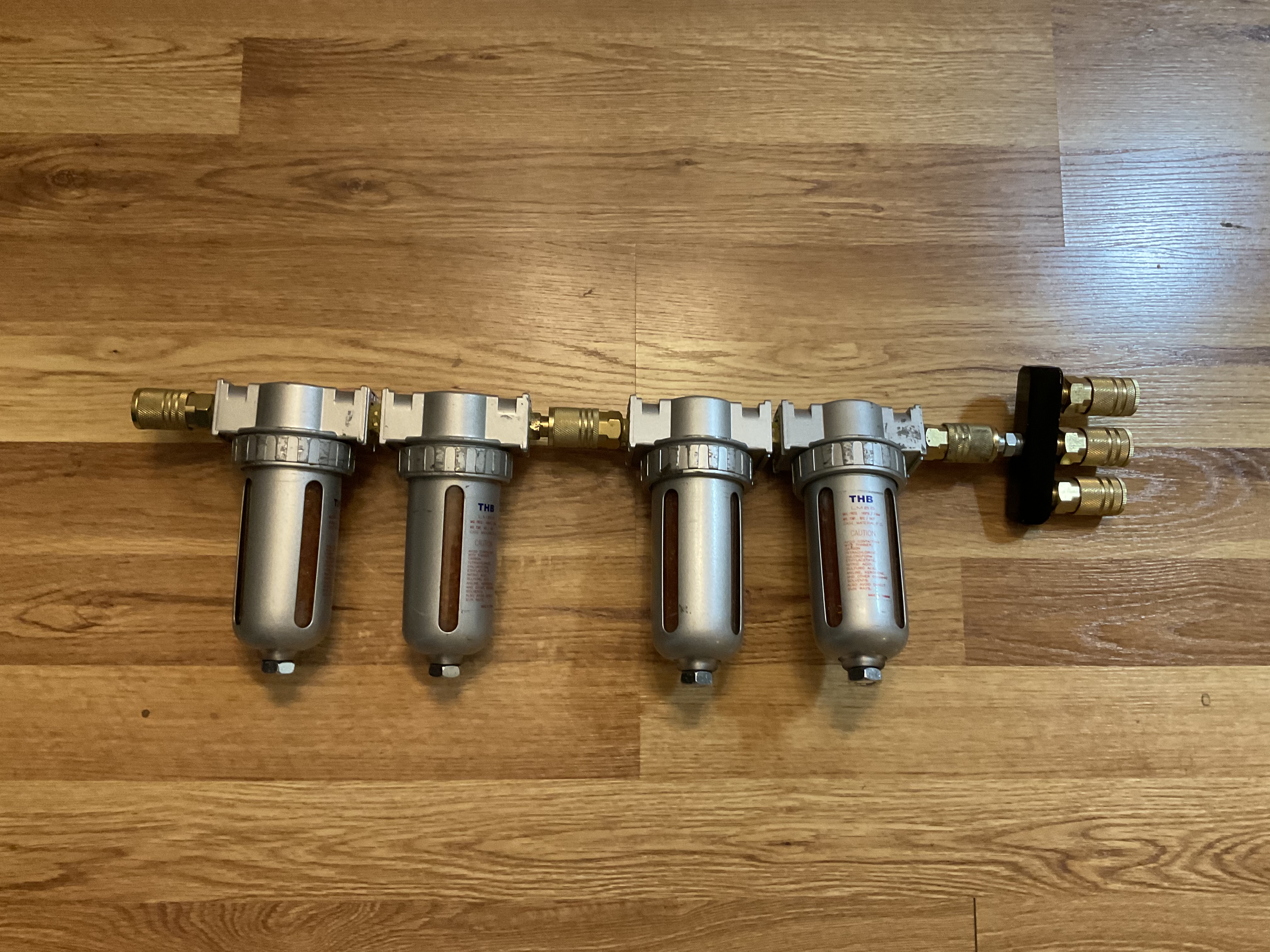

Those 3 Cat compressors pump through 4 dessicant filters and empty into a 10 gallon Cat storage tank, before feeding to the Altaros.
Recently I have had a switch on the first Cat shutting off after around an hour on duty, on a 70/30 work ratio. Shutting the switch off for a few minutes and restarting gets it going again, but I do need to call the Cat techs and find out what I need to replace. I set up and run the system in my kitchen where I have access to 3 seoerate 110volt lines and pump into my garage where the Altaros booster lives.
I went to top off 30 and 60 minute tanks yesterday and for about 30 minutes the system was failing to build pressure on a empty line and gauge on a closed valve fireman’s tank. I spent several minutes checking for leaks, but found none so I released around 2000 psi into the system and immediately started building pressure. Later in the day, after taking a break I restarted the system on the 2nd tank and experienced no problems.
I think a rebuild is in my future. Watching the video on seal replacement seems easier than the countless Shoebox rebuilds I have done. Rebuilds are a maintainence chore and not a reliability issue.
The set up looks like a mad scientist project but I love the system and it’s durability.

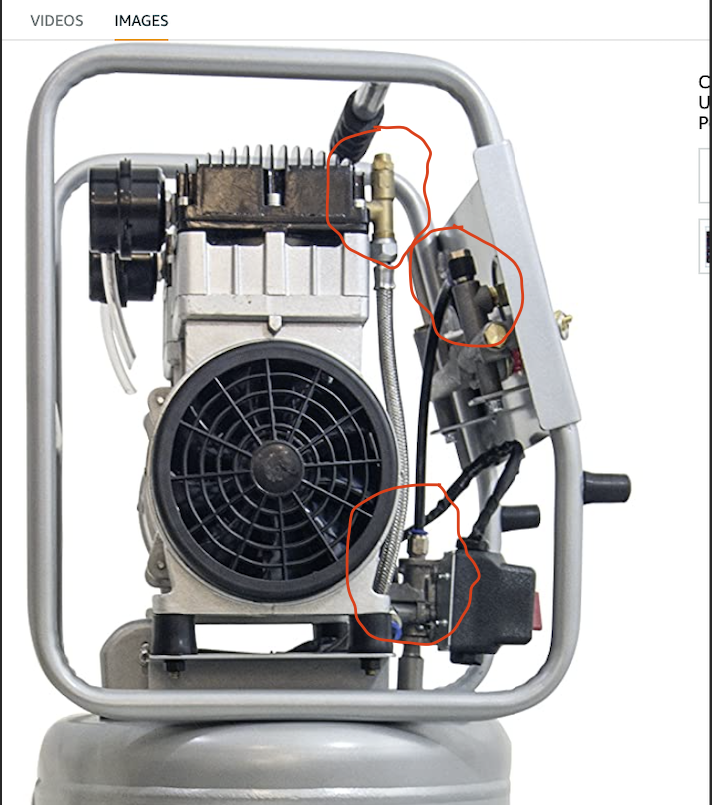

I have one of those CAT compressors and used it with my Altaros Booster before selling the booster. Maybe it was just the room I was using it in but I struggled with a lot water being generated by the CAT and the design of the output tended to push a lot of it to the output rather than letting it sink to the bottom of the 10 gal tank.
You can see this in the design with the circled areas below that the feed into the tank and the output to the distribution board should not have been placed on the same connection.
For me, with the high flow rate of the Altaros I saw a lot of water in the line.

This is what I use for the water. Nothing gets by these filters.

Thing is compressing air creates heat and water, it is how you deal with it that matters. With the filter system shown water just does not nake it to the Altaros inner filter and it never needs changing. I do check and change the dessicant media with each use.
