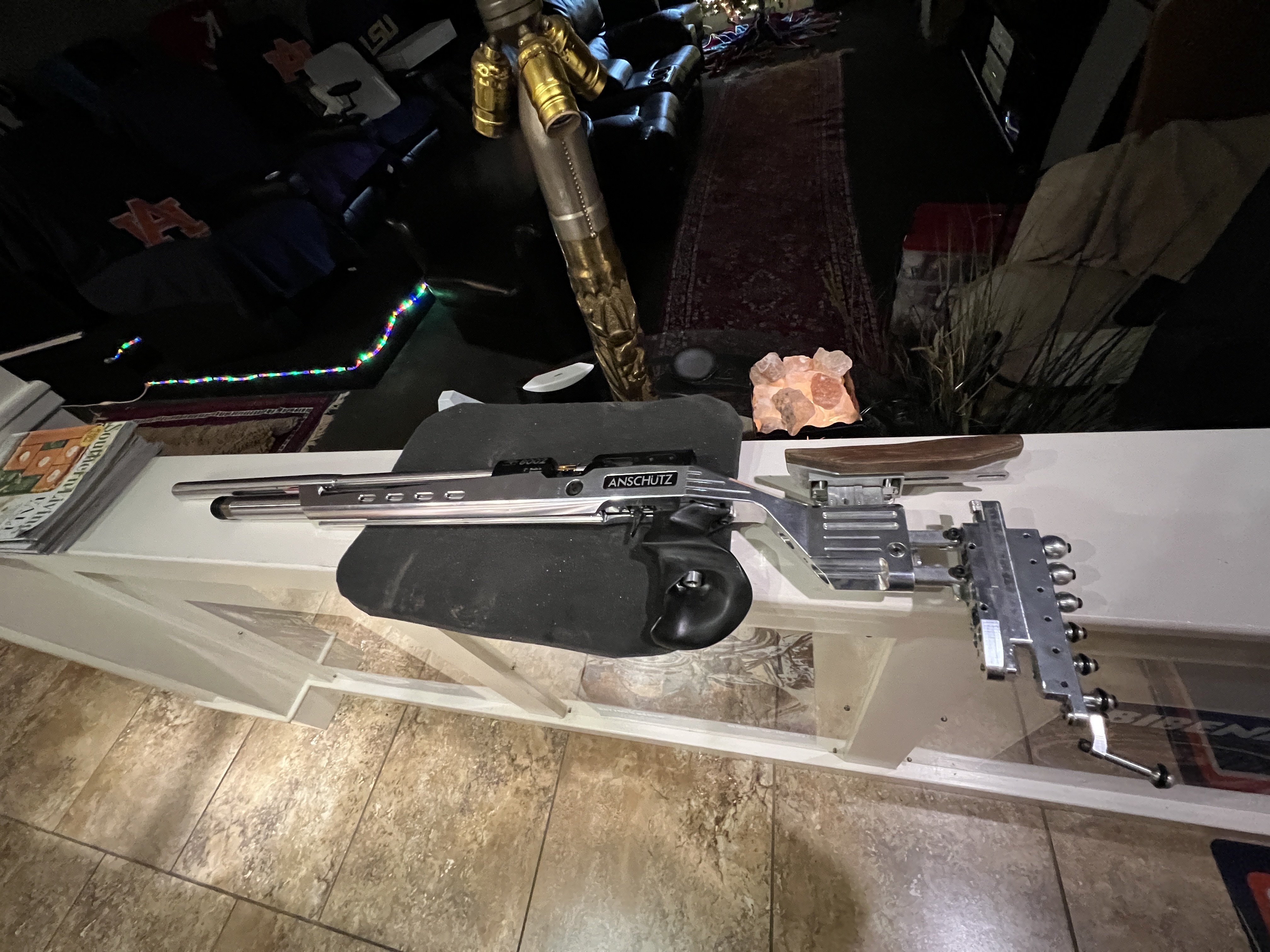

This will be interesting
Some machinist had his way ... Hum :unsure:
Sort of some Frankenstein going on ... Do tell
Allen Zasadny just returned it to me after many many months.
He Converted this 6 ftlbs 10 meter Olympic gun to wftf <12 ftlbs
Insane trigger ! I ordered a trigger guard for it last night so I don’t shoot my window out 👀
So quiet you think it’s broken 💭

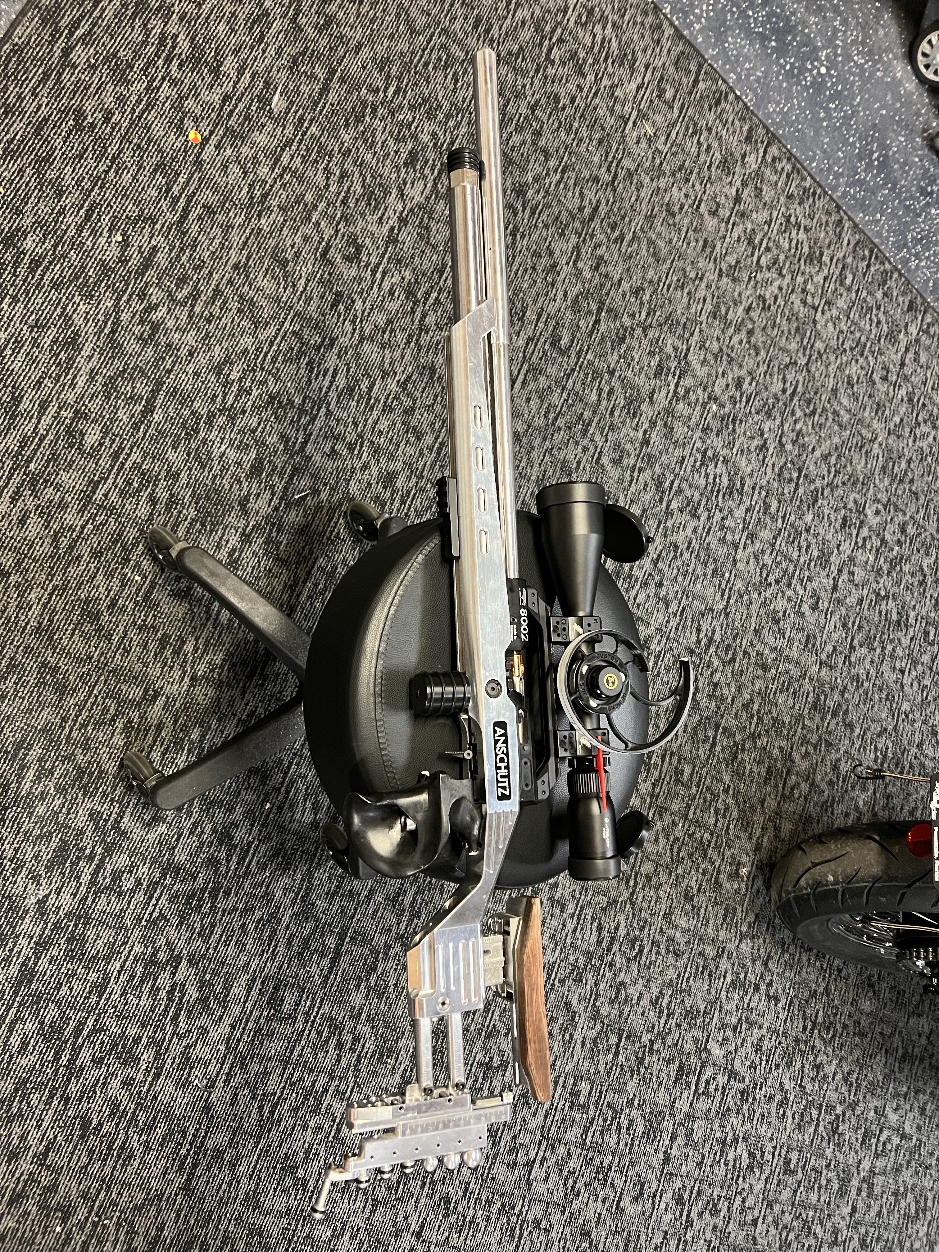

Scoped easily with a monorail and Athlon 6-24X56 Heras which I zero’d at 30 yards
Dope created using Strelock from 10-55 yards then taking actual shots.
Definitely wind sensitive with JSB 8.44’s moving @785 fps.
I’m practicing with this and a MAC1 USFT to better learn the wind game🌪️ through better awareness.
Lots of buffing and elbow grease here hoping to blind the competition 🌞
Point of interest-I have a terrible time with right angle breech loading directly into barrels but the protruding / convex cone breech on this makes loading pellets relatively easy.
