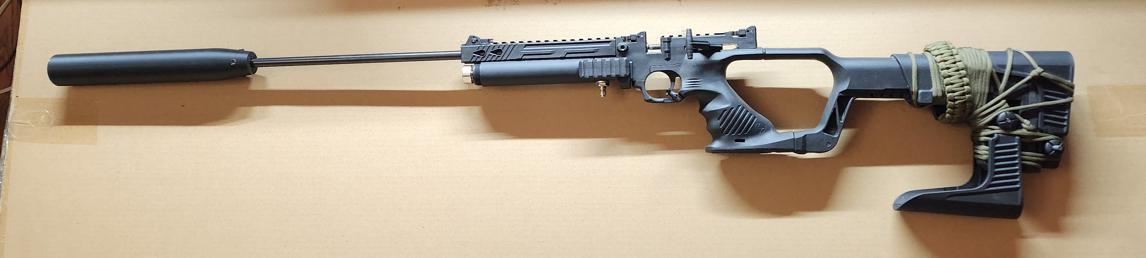

So. The Jet is my muse. Made a bullpup and sniper rifle, and am into barrel swapping. This particular post is to ensure people that a smaller outer and inner diameter barrel is usable in the Jet. Obviously a larger one can be sanded down but a smaller one leaves a gap that needs attention. I will post a thorough video walk through soon. The barrel enters the suppressor for a few inches before bottoming out. Fits snug, no clipping, held by 4 grubs.
This barrel is a .22 cal from my Crosman 3622, which needs a longer barrel itself to be able to accommodate suppression. Could that longer one be a .25? We shall see. The original .25 Jet barrel is now reworked via drill-lathing to fit in my .43 cal T4E Walther PDP. That's a complicated and challenging mod, which is the point. This Jet longbarrel mod is much easier and just takes some creative latheing with a drill and some well placed o-rings. Particularly the bolt on the Jet doesn't have an o-ring, it's inside the barrel and isn't in Crosman barrels. Have to reshape the bolt and add a notch for an o-ring just like the Crosman bolt, and it works really well. Just gotta fine-tune the clearances and ensure the rifling isn't an issue at the interface.
This one is a success at approx 21 inches, but I have a 14 inch laying around somewhere and will likely make a video starting from scratch with that one for YouTube's sake.

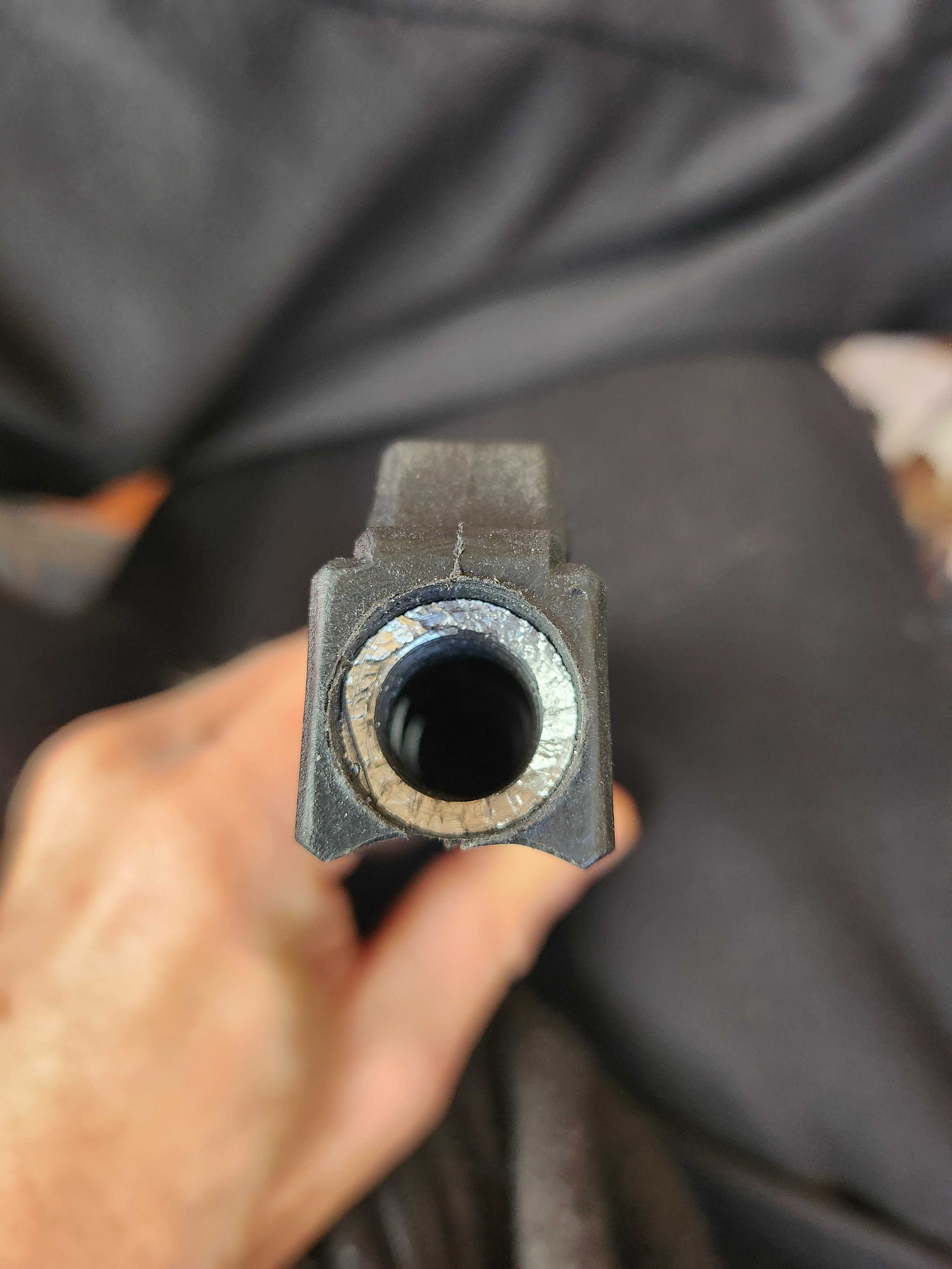

Update: got a chrony and measured the mod w the .22 long barrel... the shot string peaked in the 690s, near perfect for me. Some air is escaping out of the rear and I was hoping it was enough to keep the fps below 700. Nailed it! Installing another oring to snug up against the back of the barrel when closed will likely up the fps, so I'm not doing it for now. Also, the port I drilled into the barrel is smaller than the original by maybe 30%, so it would be another point to increase fps if I wanted to, which I don't, for now. Not sure if my moderator is slowing it down either but it's definitely quieting it significantly. Really happy I don't have to give up on this build for breaking 700fps.

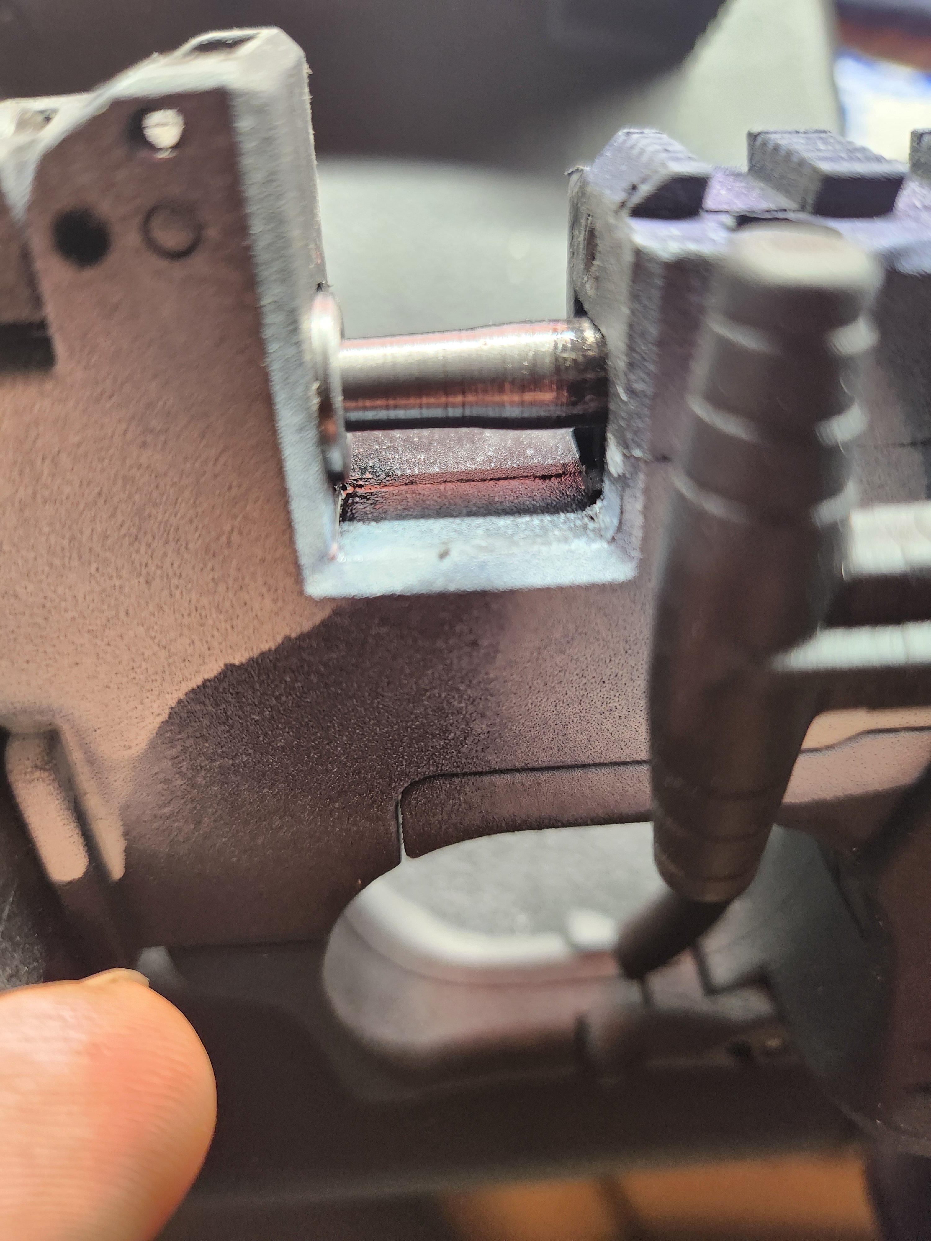

Got a .25 cal Avenger barrel to play with a .25 long barrel Jet build and have yet to figure out how to install it without cutting it. It's very close to the Jet dimensions, but the oring channels likely need deepened slightly and it's just a smidgen shorter in the rear behind the port. Usable, but not with a magazine so I may be cutting off the port and making all new oring channels and a new port, again smaller than stock so as to limit fps. Upon doing this I will also be able to fashion a proper rear seat to hold a magazine.

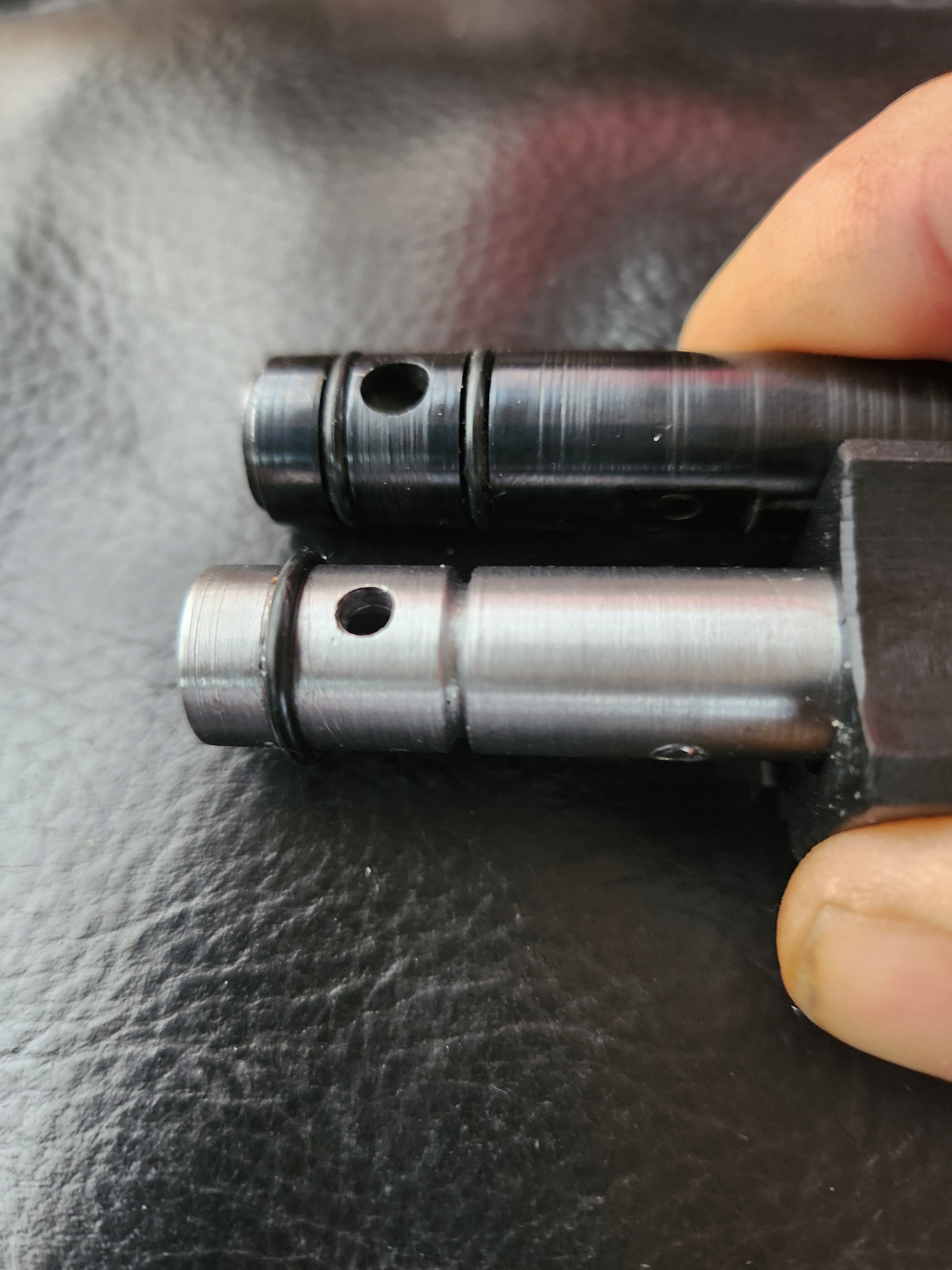

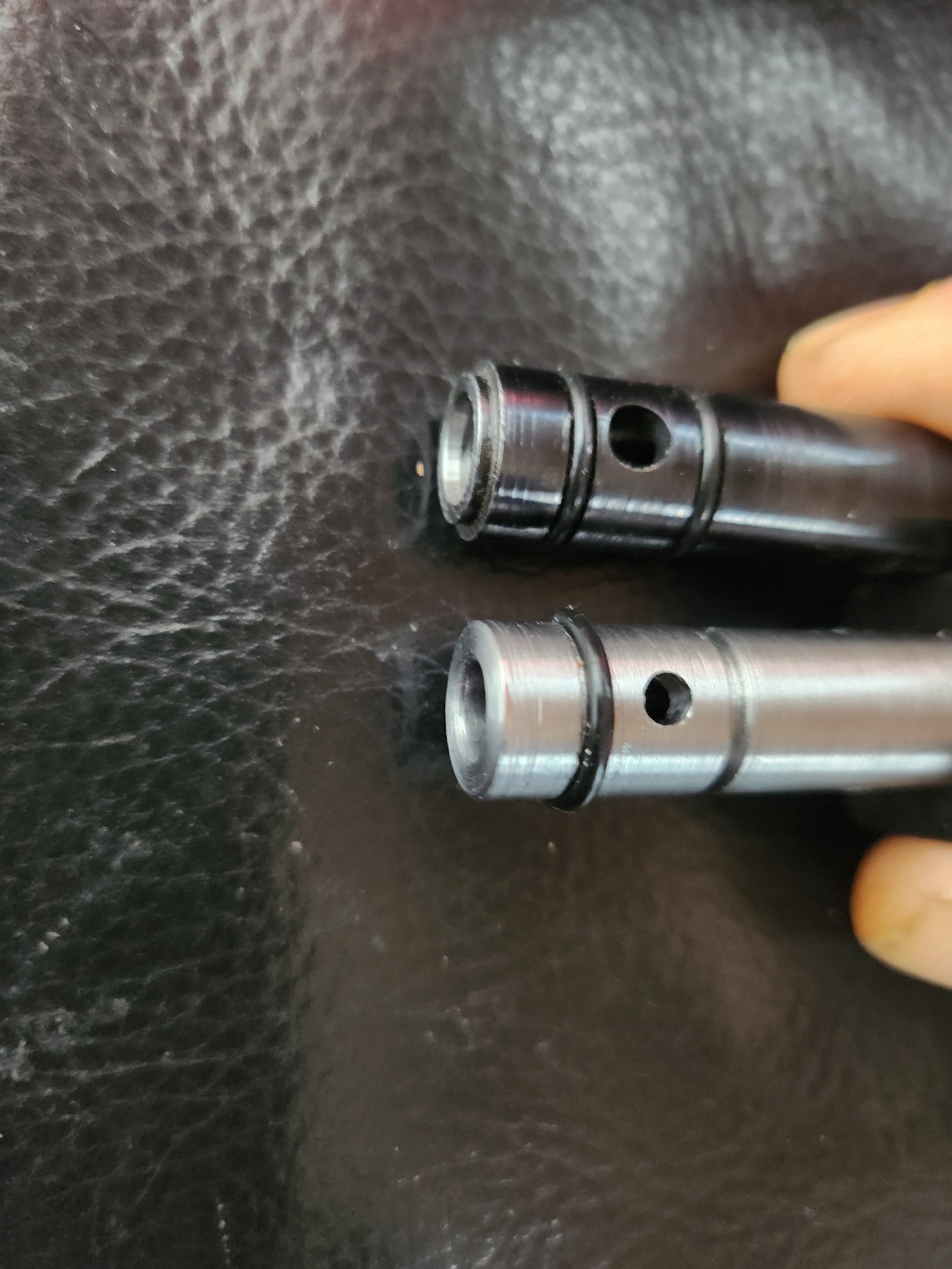

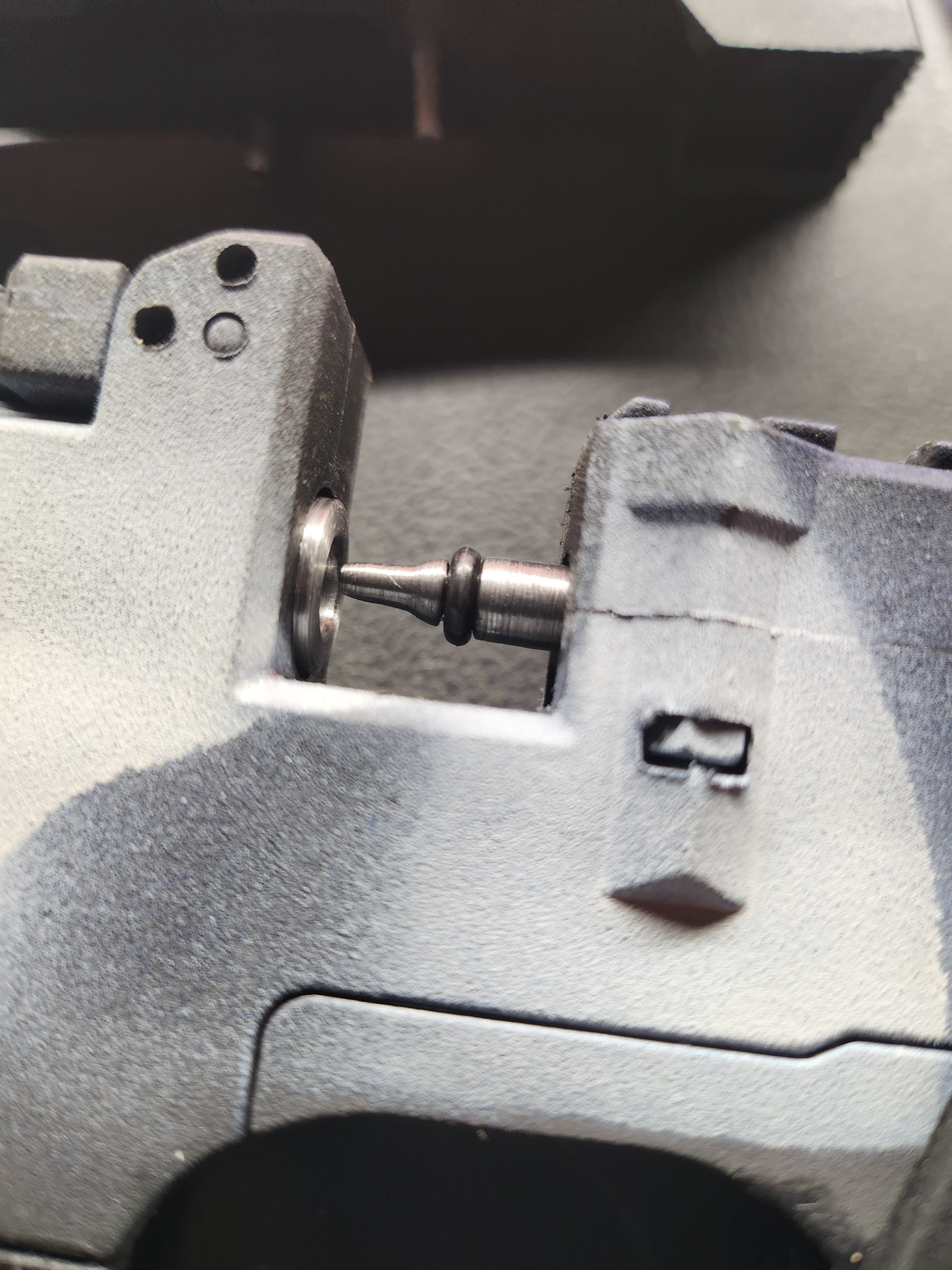

I'll add a pic of the bolt for the .22 mod. The oRing isn't needed as I eventually spun down the bolt. Removing this oring ups the fps by about 30-40, which were the conditions under which it was hitting 690 with coppered barracudas. Adding it drops the fps by about 30-40 due to taking up space.

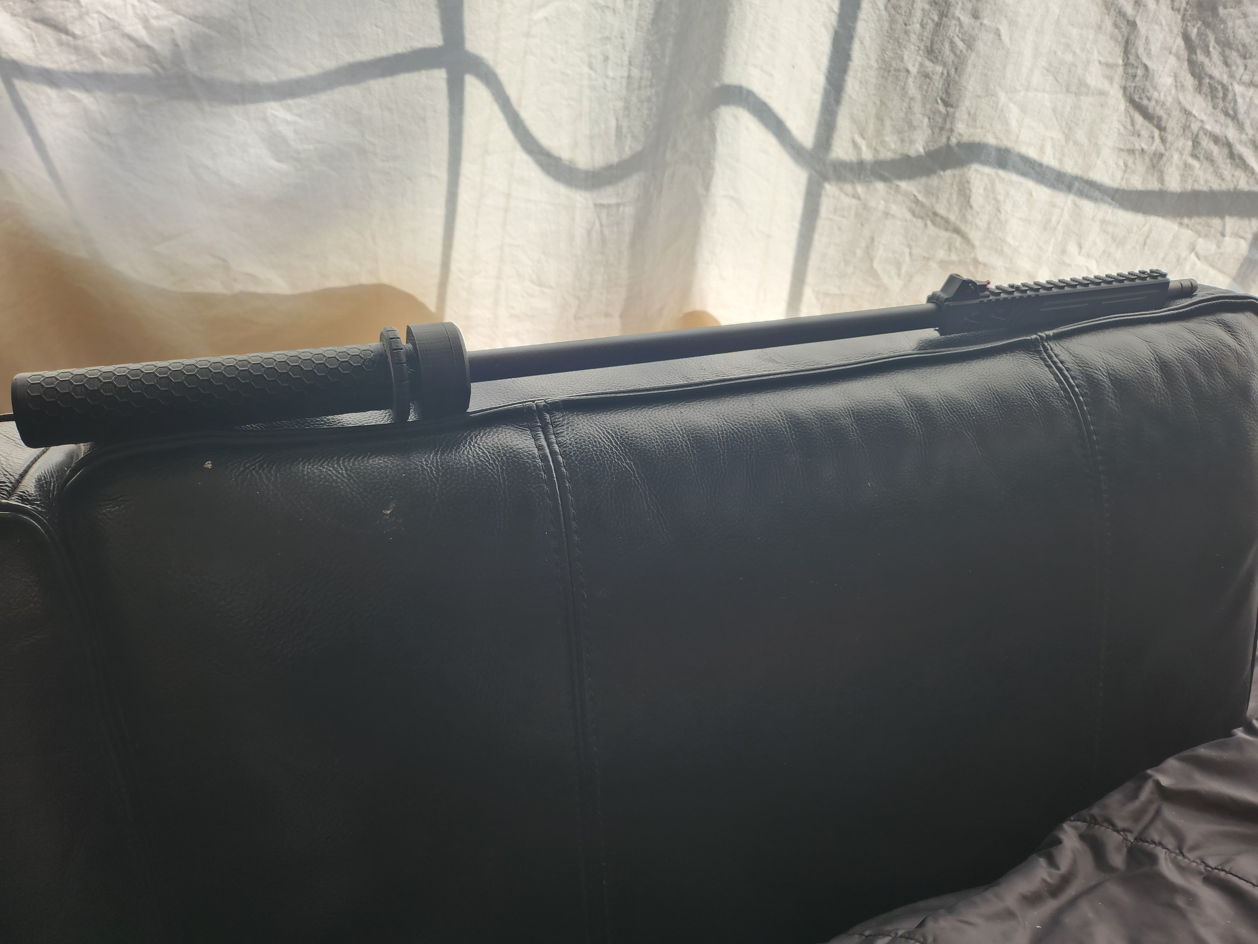

The crosman barrels may be a tad over 11mm, sanding down let me fit a 15mmOD 11mmID carbon fiber sleeve. This is to deal with the barrel whip of the longer unsupported, as is the tuner.
Had to get a 15mm bit to try drilling the Jet shroud for a recess, but there is zero clearance, and the metal thread set into the Jet tip for moderators just bent outward, did not want to cut and drill out. Maybe a soldering iron removal of that piece is better.
The moderator is a Frankenstein monster I made by super gluing a Buick Rail supressor which broke at the base to a printed harmonic tuner design. For a junk piece, it works well enough. It's not a perfect glue interface, probably off by 2 degrees but I'm hoping it's ok being that's it's a .25 supressor and I'm shooting .22. I can always cut it, resand and reset it and have pretty much convinced myself to do so.
