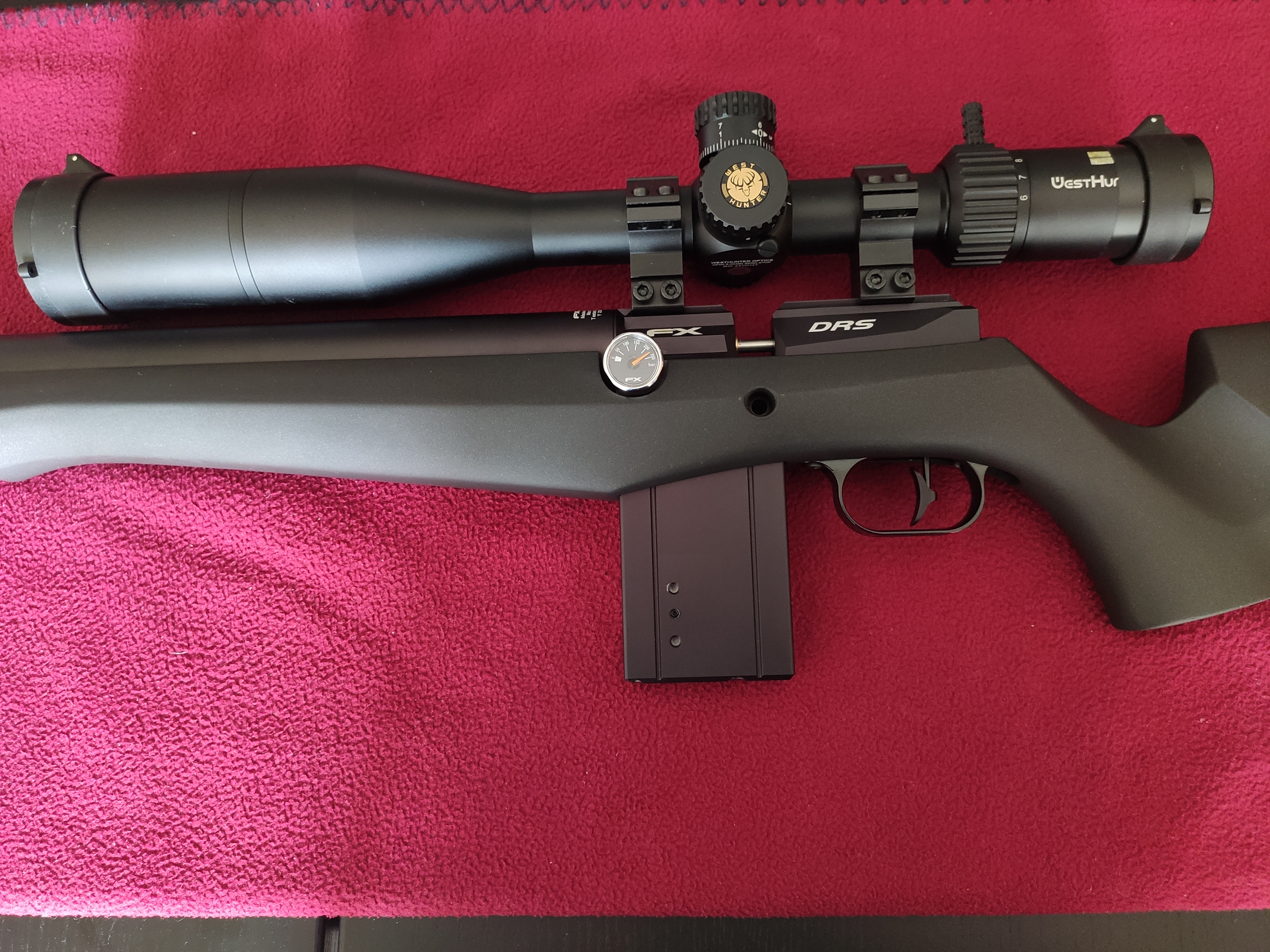

I'm just getting past the break-in period (about a tin of pellets) with my .22/600mm DRS and starting to look for the best pellet. Looks like the factory tuned to an 18g pellet.
Thought I'd share the numbers for anyone curious about the stability FX DRS.
JTS 18.1g -
A 911fps
H 914
L 910
ES 4
SD 1.7
FPE 33.3
GROUP (5 shots, 40 yards) .358 CTC

I found that my DRS groups best with a light/loose hold.
Cheers!
