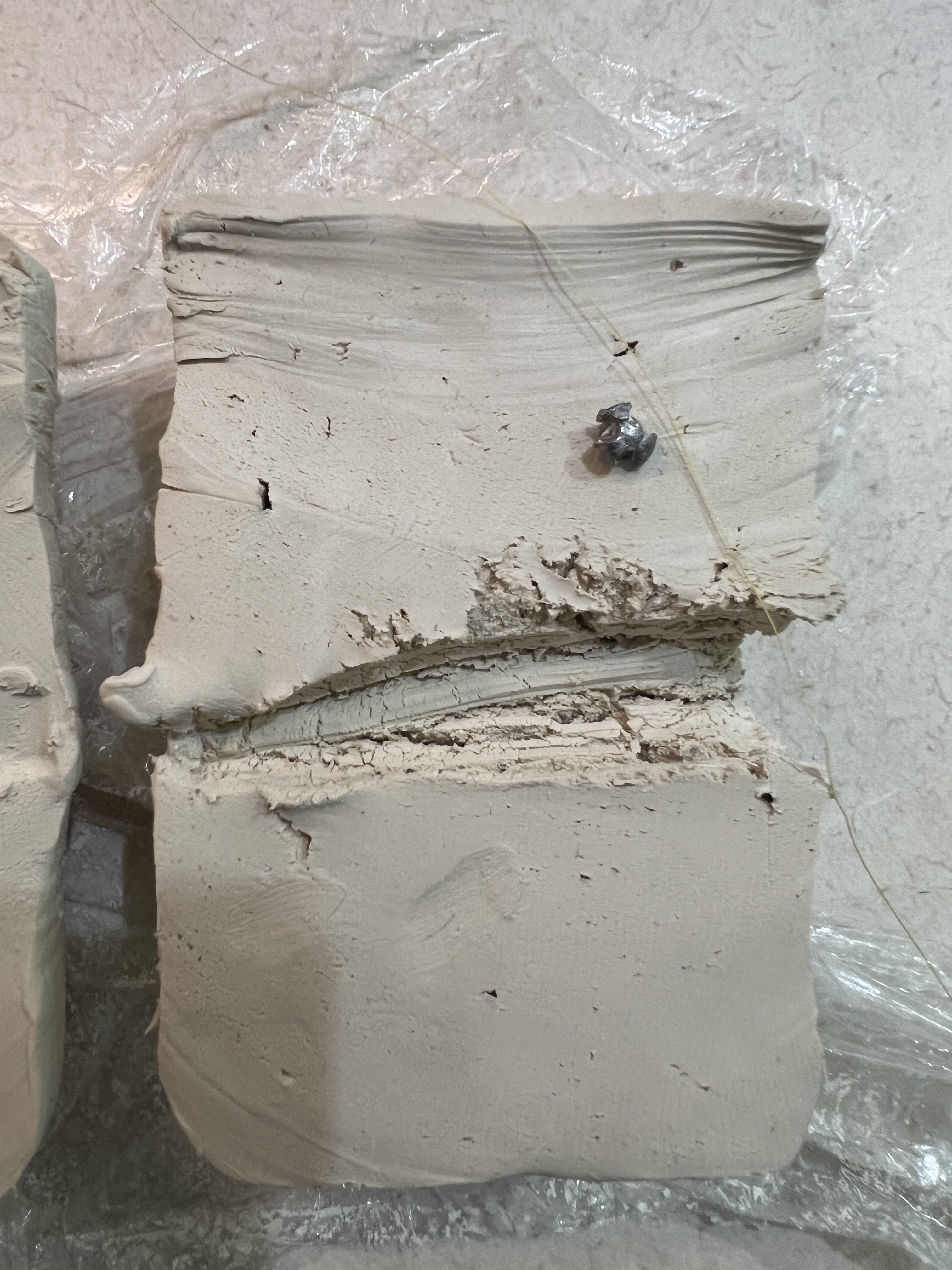

The Hades/Atomics are very effective because they do not “expand” in a traditional sense. The front of the pellet fattens on impact along the serrations, creating a larger frontal area, and expending energy…. but also creating some sharp edges (kind of like a Barnes X-bullet) causing more damage and usually penetrating a bit deeper than your common expanding pellet. They also exit more often than HPs of the same weight, due the deduction in frontal area and sharpness of the petals.
Here’s a .22 FX Atomic at 900fps into 4lbs of modeling clay. You can see the nasty edges on the recovered pellet, and the hefty wound channel. I would not want to get shot with one of these angry little pills!
