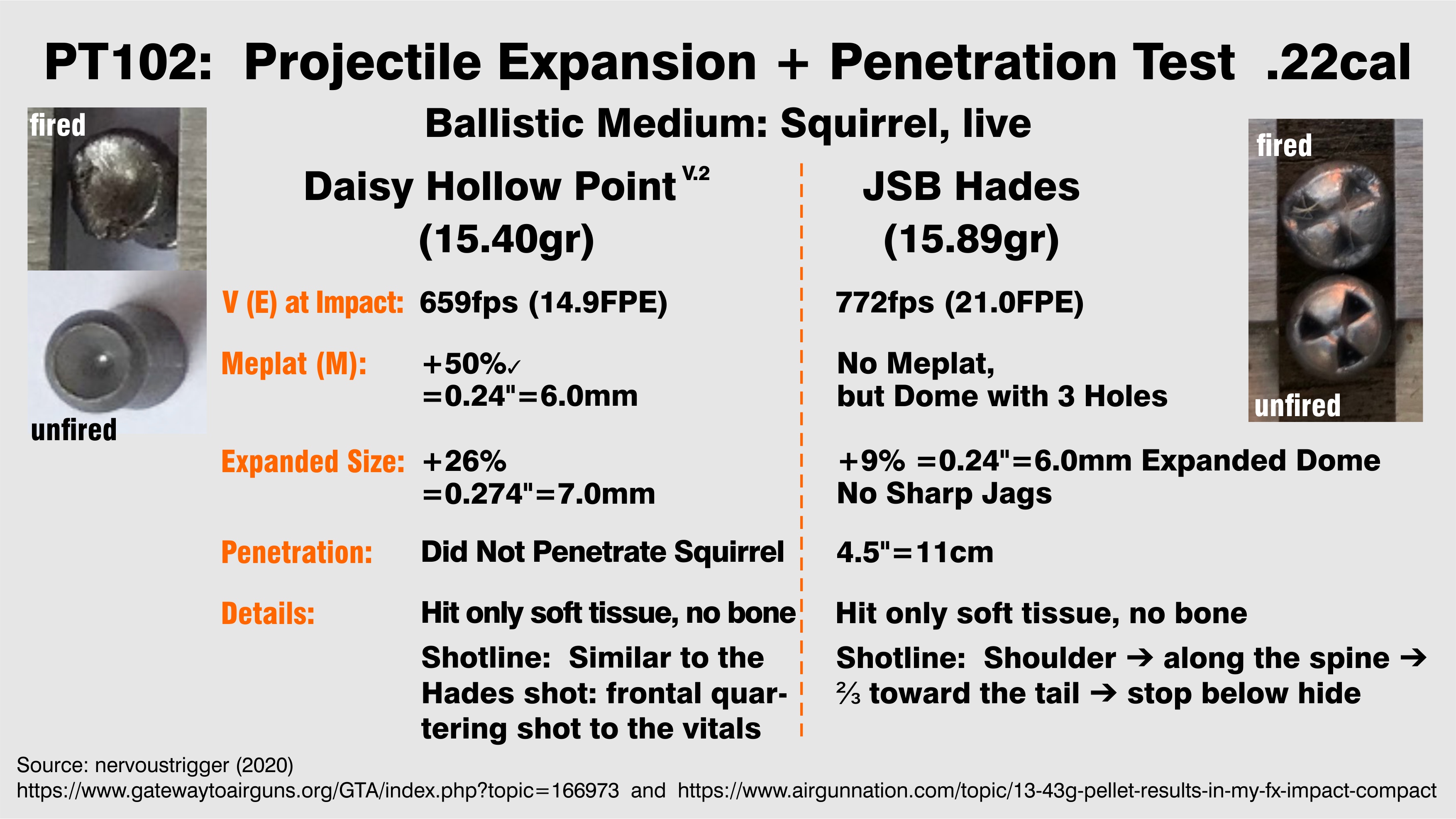

I posted earlier about being underwhelmed by the Hades expansion on actual game/pests. I will however acknowledge that being a semi-wadcutter geometry does deal out greater damage than a dome. For me they work similar to the H&N Baracuda Hunter Extremes (BHE) with the blunt Philips head impression. They hold onto their accuracy at distances greater than a wadcutter but not as far as a good domed pellet. Likewise, their capacity to cause tissue damage lies somewhere in between.
So for example I will often use wadcutters out to 30 yards, Hades or BHE from 30-50 yards, and domes for 50-80 yards.

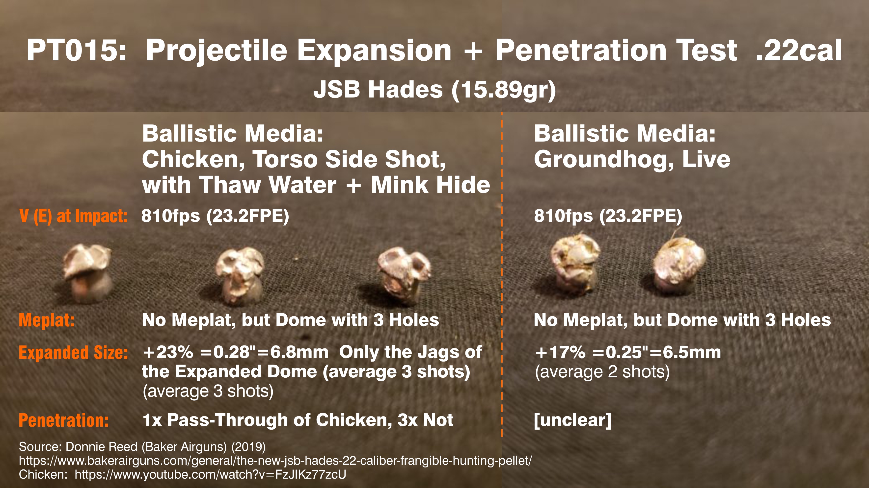

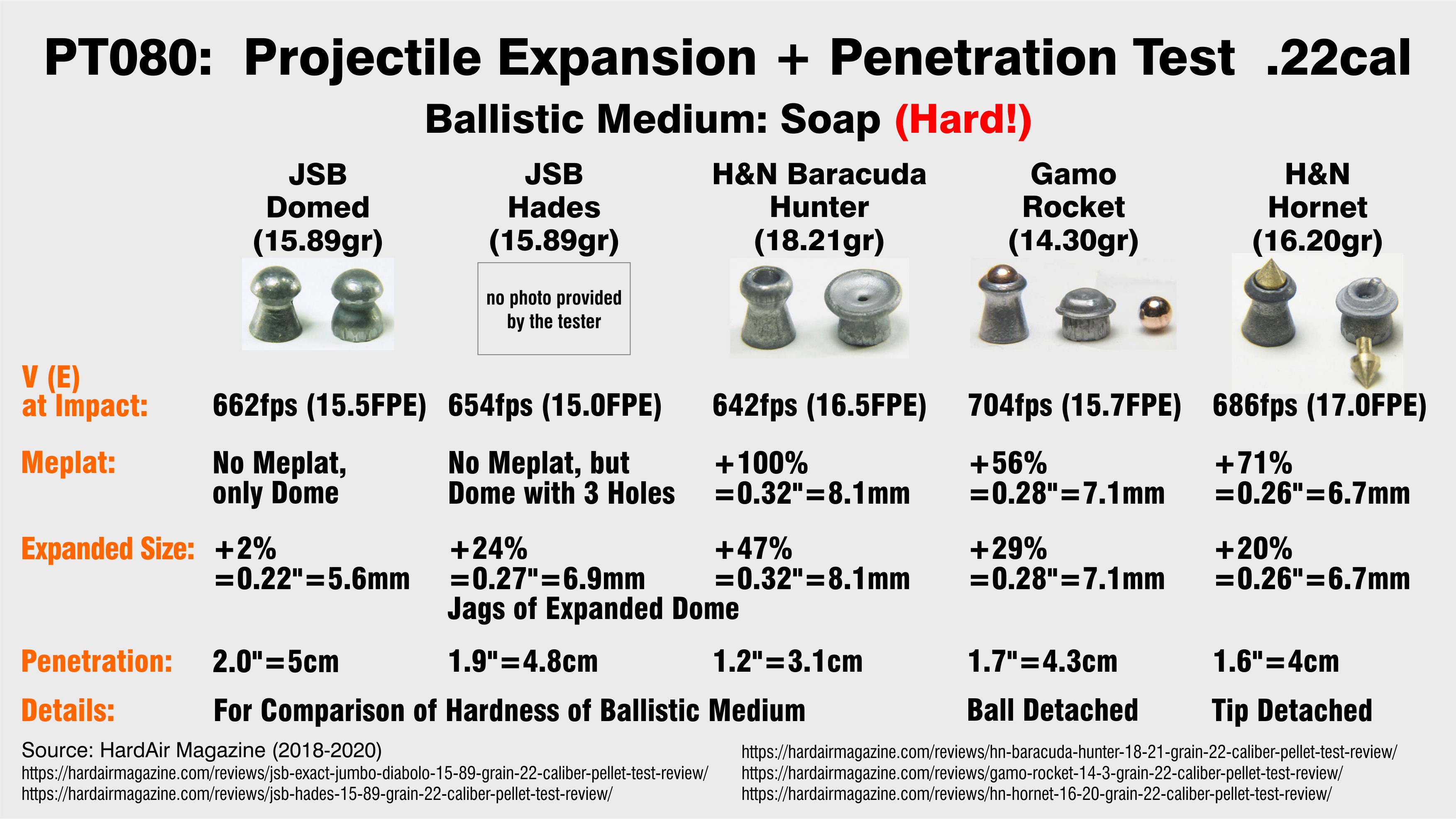

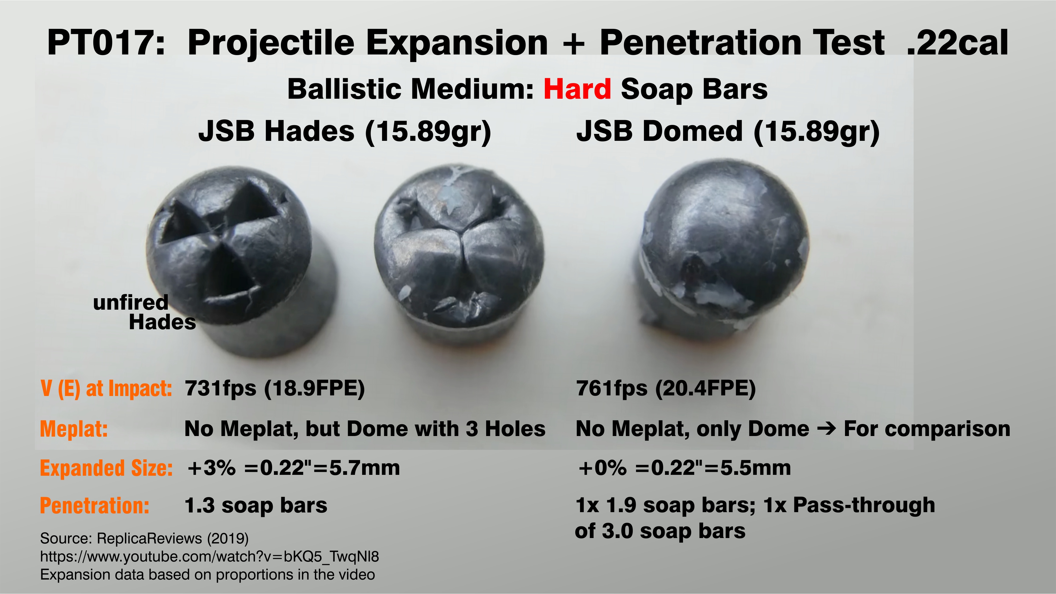

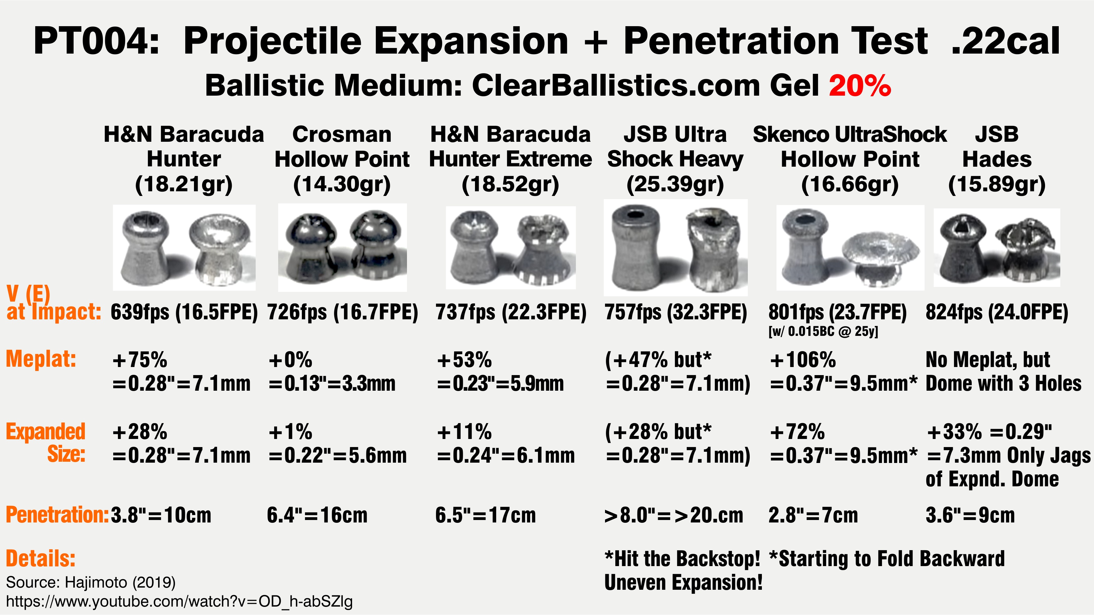

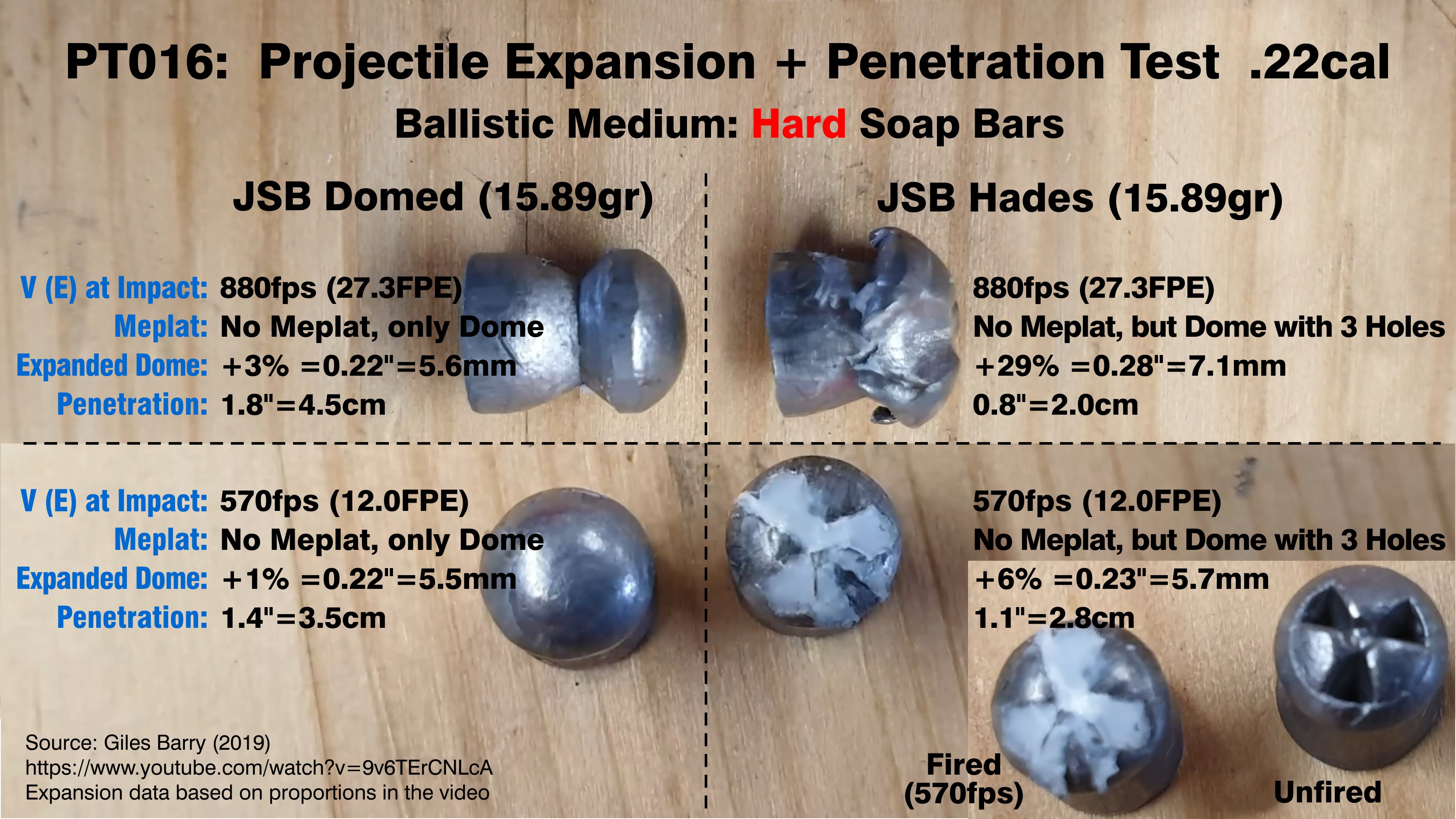

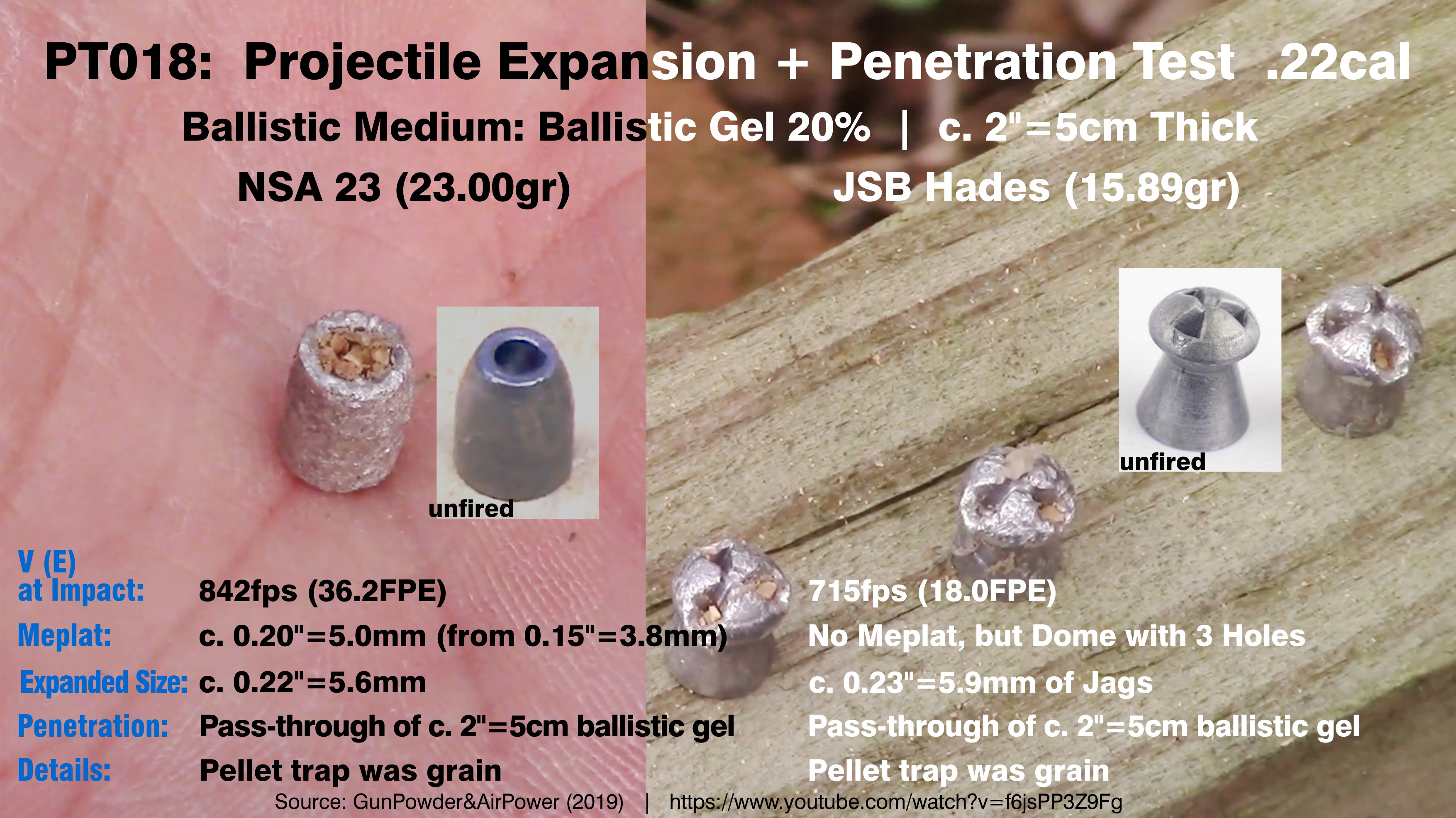

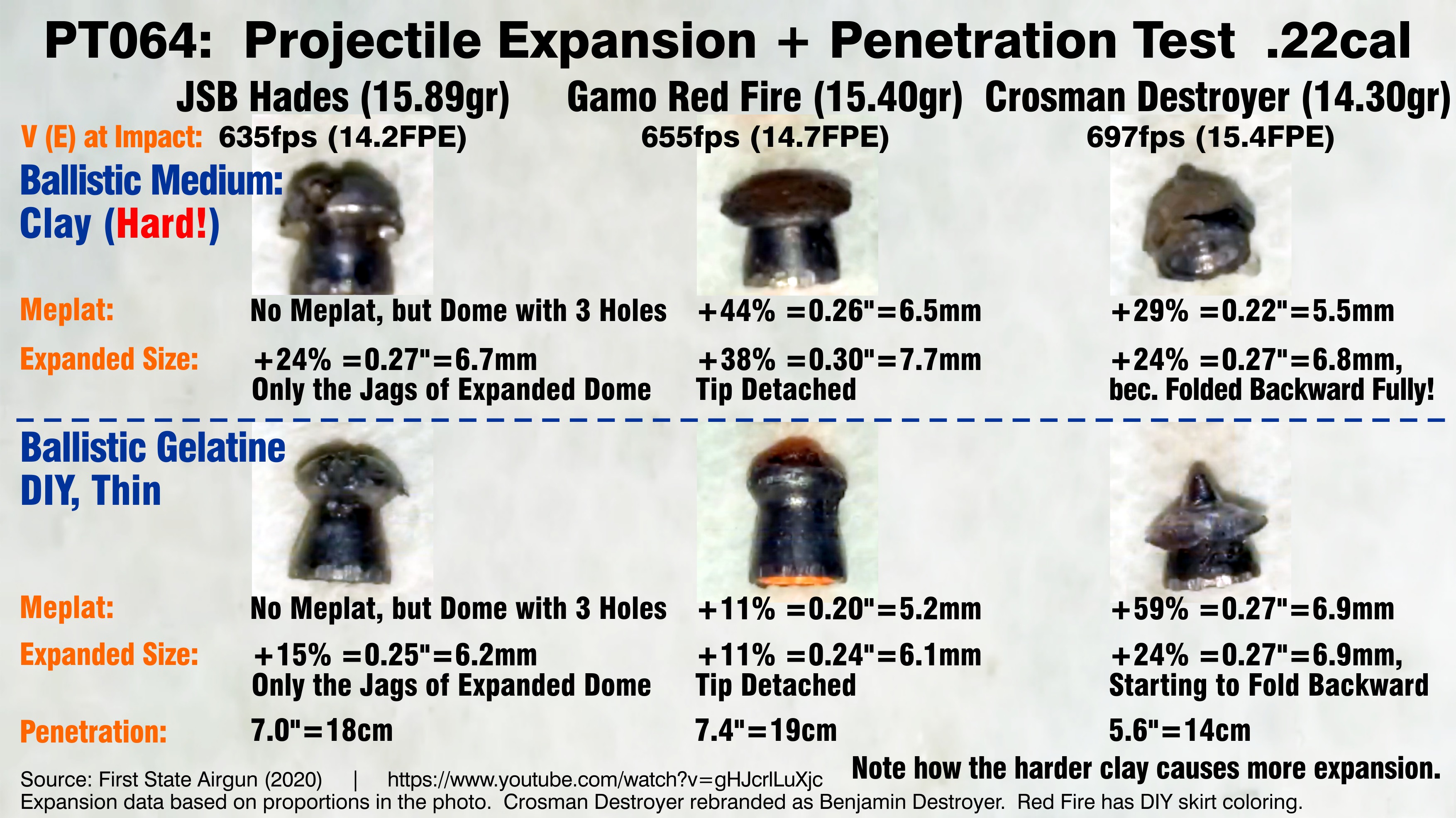

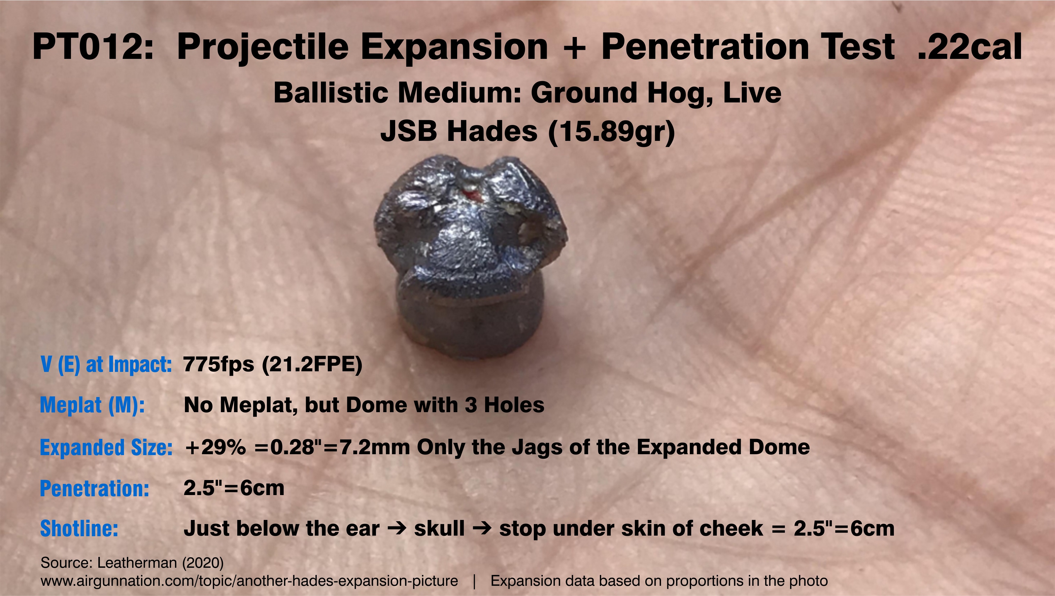

There have been quite a few terminal performance tests with the Hades in .22cal —
however, many testers have used water as ballistic medium — which is perfect for expansion — and actual game is far from perfect — so the "test" results are extremely optimistic — not to say unrealistic.....
Below are some of the tests. Note that expansion increases as the hardness of the ballistic material increases unrealistically — and/or the impact velocity (in some tests they are unrealistically high).
If you have any test results, I'd love to get the specs to include your results in the expansion test collection:

Projectile Tests. PT012.  Leatherman (2020). -Ground Hog, Live.- 21FPE. Hades @775fps. 01.jpg
Projectile Tests. PT015.  Donnie Reed (Baker Airguns) (2019). -Chicken, Torso Side Shot, Hard ...jpg
Projectile Tests. PT102.  nervoustrigger (2020). -Squirrel.- 21,15FPE. Hades @762fps + Daisy H...jpg
Projectile Tests. PT064.  First State Airgun (2020). -Ballistic Gelatin DIY, Thin + Clay.- 14-...jpg
Projectile Tests. PT080.  HardAir Magazine (2018-2020). -Soap (Hard).- 15-17FPE. J Dm @662fps,...jpg
Projectile Tests. PT004.  Hajimoto (2019). -20 Percent ClearBallistics.com Gel-. Skenco UltraS...jpg
Projectile Tests. PT016.  Giles Barry (AirgunGearShow) (2019). -Hard Soap Bars.- 12,27FPE. Had...jpg
Projectile Tests. PT017.  ReplicaReviews (2019). -Hard Soap Bars.- 19-20FPE. Hades @731fps  + ...jpg
Projectile Tests. PT018.  GunPowder&AirPower (2019). -Ballistic Gel 20percent – c. 5cm Thick.-...jpg
