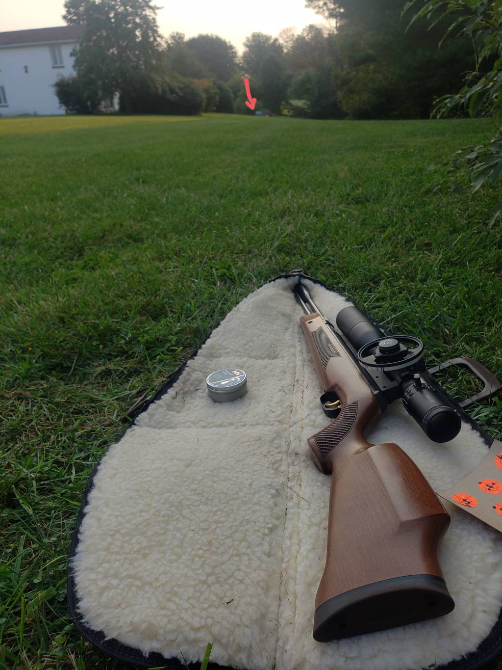

I happened to be playing around with Chairgun when reading your post. Assuming the H&N FTT 14.66 grain pellet has a ballistic coefficient (BC) of 0.019, and given 690 fps, 100 yards, and assuming about 2" scope height zeroed at 30 yards, the POI drop is about 41" at the target.
Does that sound about right?
