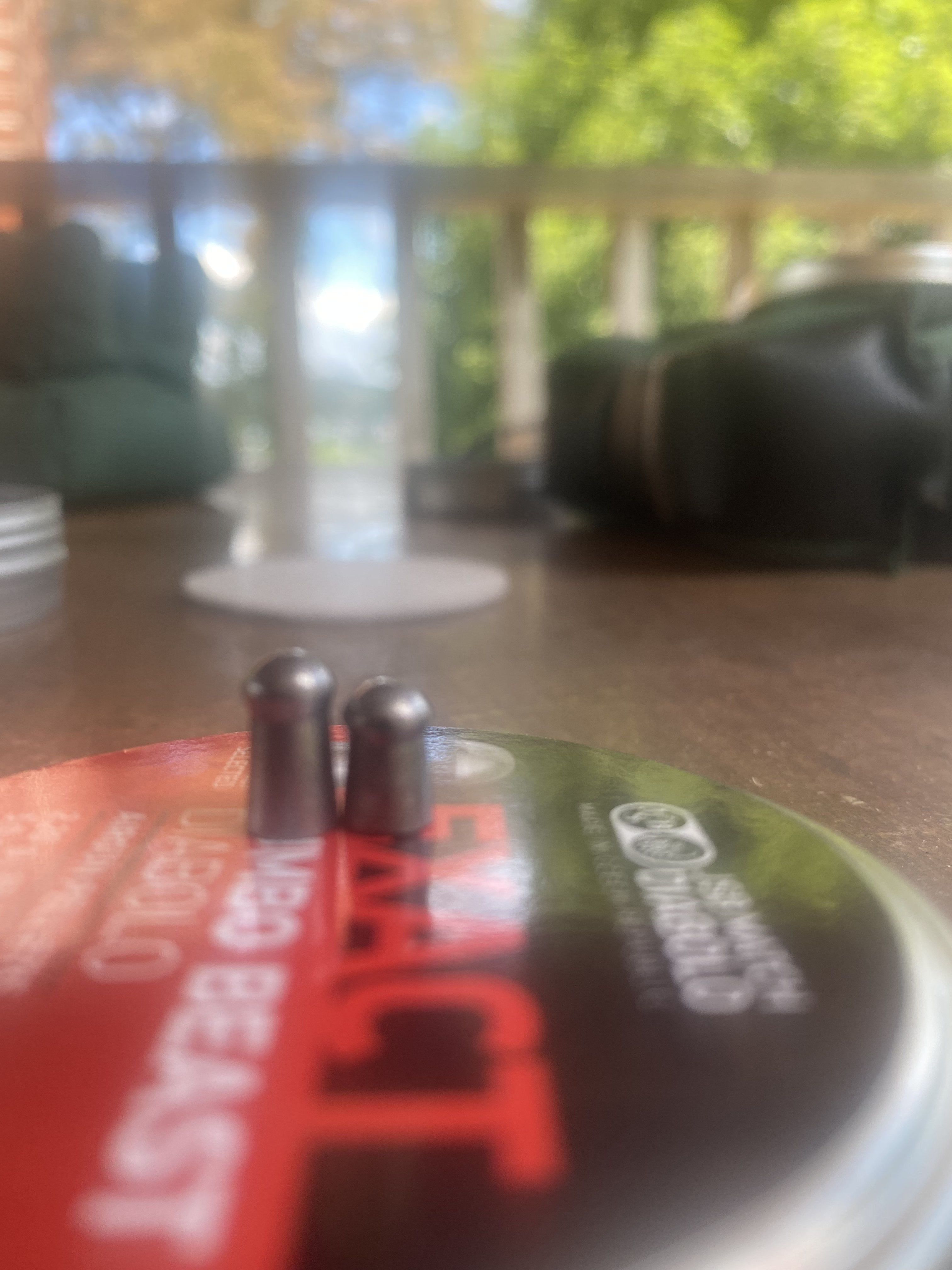

Finally saw these Jumbo Beasts in 33.9 gr back in stock at my dealer, almost scared to buy a new batch before asking.
Shall I expect a same amount of homework as with MRD's?
Got to love the size difference between the 2 lol, go big or go home 😀

Was worth it for me, was shooting MRD’s and wanted heavier, getting good accuracy from them at 50yds, didn’t go any further yet because most of my shooting is 50yds, I wanted a heavier hitting pellet for the bigger critters and found it, getting 70fpe from them, plenty of punch for woodchucks, skunks and squirrels 😀
The JSB 33g have a pretty good reputation on AGN. I shoot them in both my FX Boss and Taipan Long - both .25 cals. I shoot N50 target cards regularly at 50 yards mostly, and they are accurate. At 100 yards, wind is always a challenge for any pellets. The .22g RDs are good, but quality varies and I get random fliers in my RAW and Safari HP .22 cal rifles.

Yep, the 34's were that good out of the Vulcan!
Jim, let us know when you chrony that gun... If its Derrick's gun that he tuned for 40 grain slugs at about 950 FPS, I'd guess those Beasts are going to be H O T. My guess is 1030 to 1060 FPS. o_O
