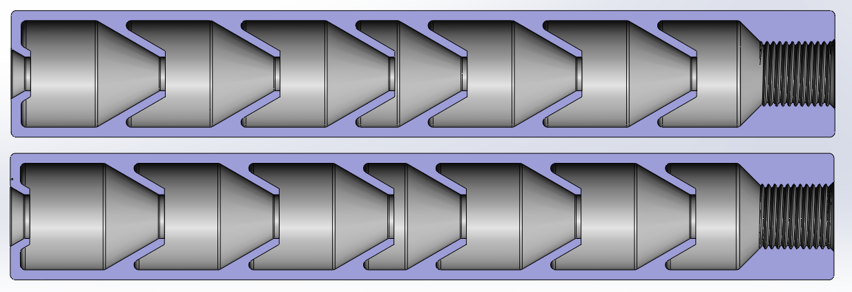

It is likely that the spread in sound reduction would be greater for longer "test tubes", than the 2 dB differences so far reported between the 4.2" long 6.5 and 8.5 mm bore "test tubes".
It was suggested that the typical length for a 1" OD .22 muffler was 6.5". So, I cut and spliced the 4+" ones to stretch them to 6.5".
If anyone wants to test this theory, the two STLs for the longer versions are attached in the same ZIP file. See image below.
View attachment STLs for 6.5 inch long bore clearance test 6.5 and 8.5 mm bores.zip
Okay I will bite. Why?
Pure speculation:
Because there are more baffles in the longer tubes. Each baffle is a multiplier of the bore area differential between the 6.5 and 8.5 mm bore diameters. It is not just the endcap bore that matters in my mental model.
We are not shooting slugs (could, if someone wanted to), but I predict that slugs will also amplify the dB differences between bore sizes. This because slugs have a longer bearing area than a waisted pellet. So, interacting as if the baffle bore's cylindrical sections were longer, or as if there are more short baffle bores. This, affects the amount of air leaking between the baffle bores and projectile.
Also, due to added air flow resistance of more baffle bores, after the projectile has passed the front endcap. Resistance to flow in a pipe is not just a function of diameter; length matter too.
Again; purely speculative.
