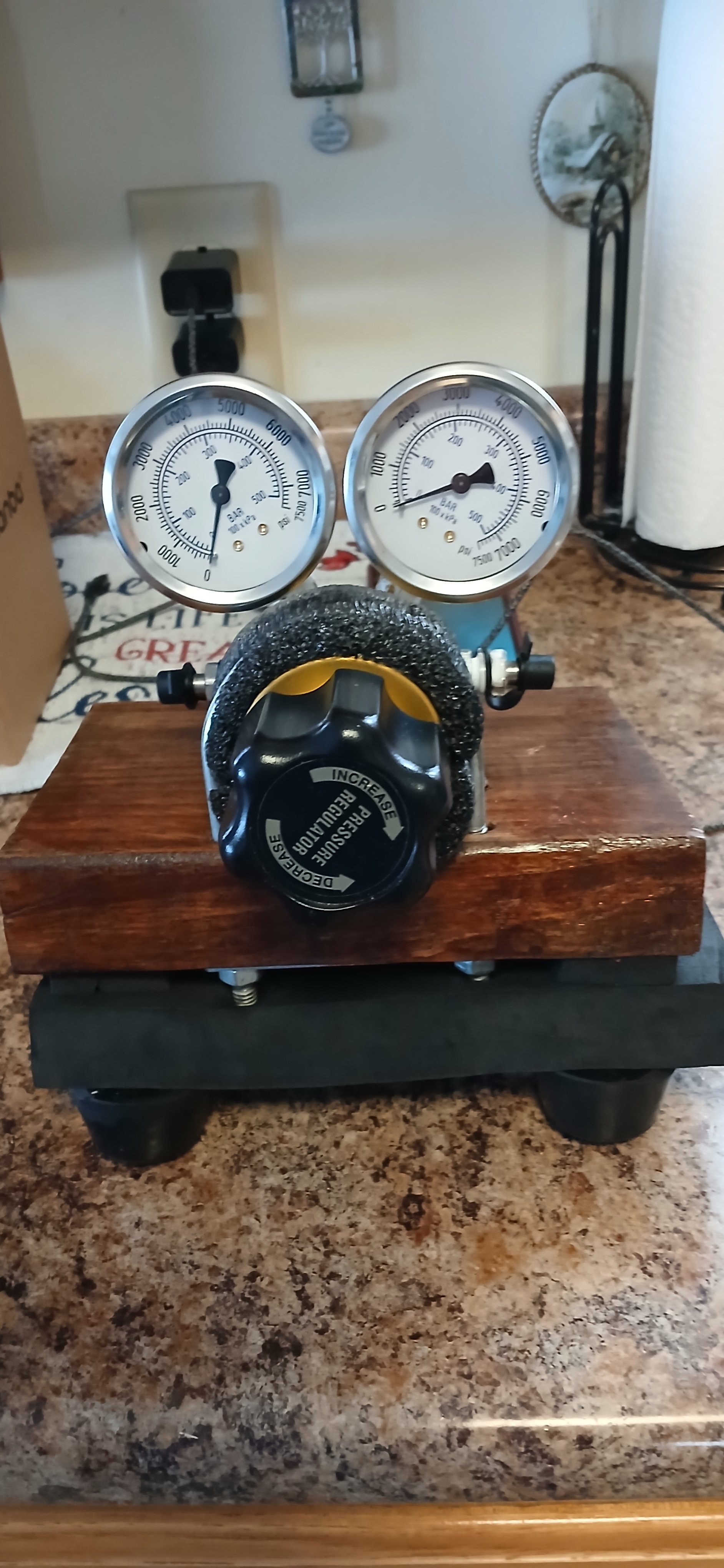

I feel the regulator when set at a certain psi will give you an advantage in acracy. I use an inline to help tune my big bores.
