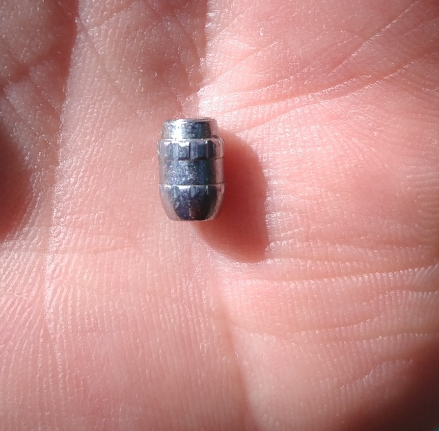

Bob designed the mold to ride on the driving bands to limit bore friction. If I'm not mistaken, he doesn't recommend sizing. They are pretty difficult to chamber in my Urban, but they still shoot great.
Here's one after it passed through the choked in my Urban barrel.

You can't just say you don't recommend sizing. Casting temperature, alloy, mold temperature etc. affects the diameter of the slug/bullet when drops from the mold. If that mold drop a wider diameter then you size those bullets in the barrel of the airgun. Accuracy suffers, speed changes, etc. sizing is important. But each in his own way. I'm sizing all my casted bullets/slugs
If you add Sn 1-2%, it helps the mold fill better, makes casting easier and only increases the hardness a little. personally noticed more benefits than harm. At least when casting slugs and bullets
Bob is the guy that designed the mold I was referring to. He doesn't recommend sizing it because it is designed for minimal engagement and minimal bore friction. If it drops slugs too large for your barrel, sell and and buy something else. My recommendation not to size wasn't a blanket statement.
This mold fills out fine with pure lead. All of my air rifle molds do if I pressure pour.
