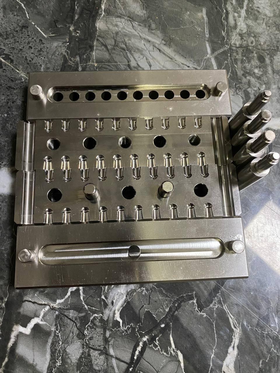

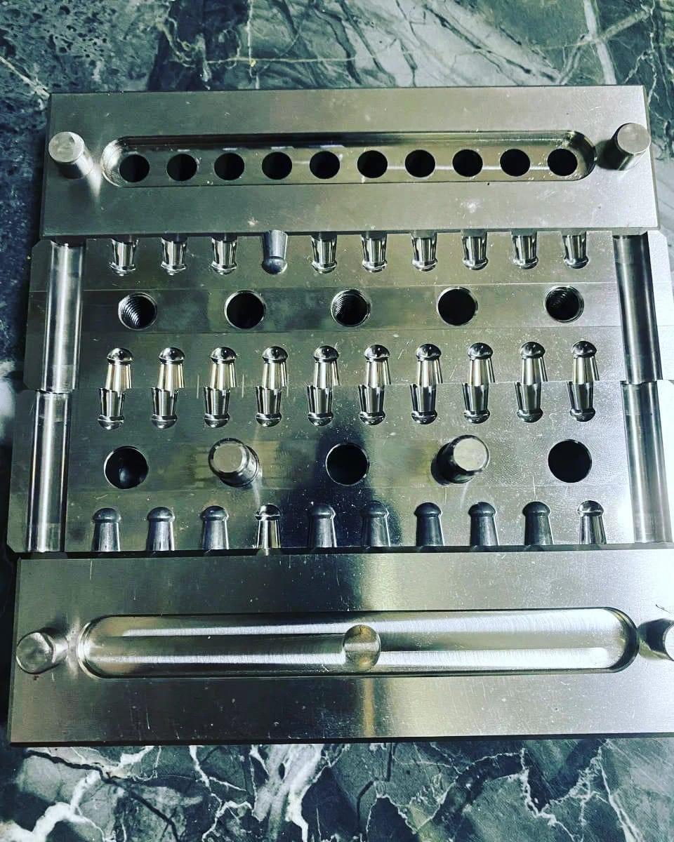

.22 molds
I need .22 Pellet Mold

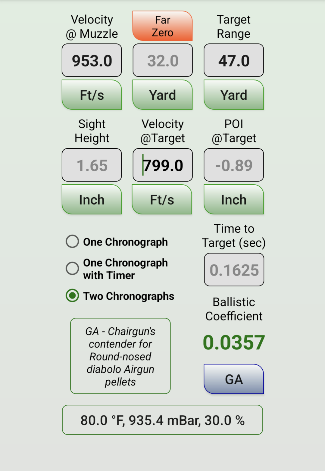

Thi predicted BC for that pellet is: 0.0741
That seems too high for that size/shape.
It is.

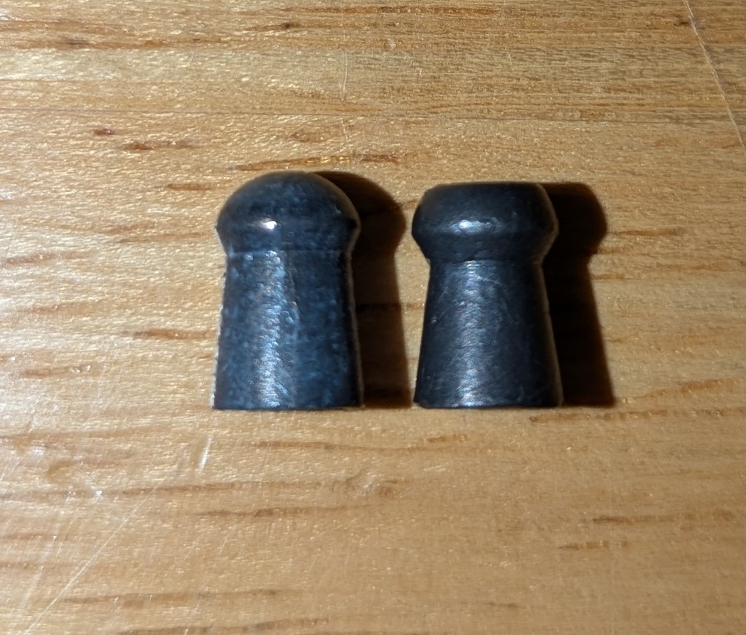

Here they are next to a .22 MRD...
I shot some about two weeks ago and got this....
(Average speed of 5 that muzzle and 10. @ 47 yards)
BC might be much better with a slower starting point, but they were strangely much less accurate at 890-900 than they were @ 950 (from that particular barrel).
Even slower, I don't think they'll ever have a BC of 0.074...
