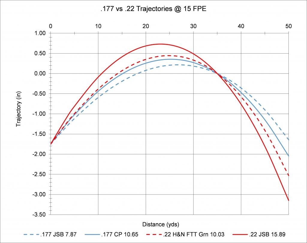

I did this mostly to satisfy my own curiosity, but since I did, I thought I would go ahead and share it. This is not an examination of which caliber is better, but simply how they differ in terms of trajectory and energy in a typical springer producing 15 FPE at the muzzle. The trends are clear, 177 generally provides a flatter trajectory, while 22 potentially provides more downrange energy. Also, one might expect that 177 might provide better penetration, while 22 might provide more "knock down" power. Ballistic coefficients were pulled from the HAM tables.

As for whether the 22 can be counted on to provide more power than 177 in the same model rifle, I don't think there is a definitive answer. Another member recently bought a TX200 in 22 and initial tests showed muzzle energies ranging from 14.0 to 15.9 ft-lb depending on the pellet being tested. Yet my TX200HC in 177 before tuning was providing up to 16.8 ft-lb at the muzzle. On the other hand, the magnum springers with large swept volume may only provide maximum efficiency in the larger calibers. I don't know if that is true, but I could see where it might be.
Because I own a TX200, I chose to consider the situation that appeared to exist for a my rifle. Other rifles may produce a different outcome.

Seems a really useful comparison for .177 to .22 would involve both the lighter and heavier pellets in each and how they would compare across various power level guns. Anyone have a bunch of guns and a few months to spare?
I thought the larger skirt area of the .22 gave the .22 a more efficient push at the start of the shot cycle??
I wonder how the GTO .22 @11. 7gr would look at 16 FT-LB compared to the .177 10.65 gr shown above.
That is the entire point of my post above. Conversely, how would a 7 gr. .177 compare to a 25 gr. .22? The GTO .22 in your question above would have higher velocity in relation to a 15 gr. (or heavier) .22 (from the same gun of course) and therefore probably better trajectory, at least at closer ranges until velocity starts to bleed off. But it would also trade off muzzle energy to do so and would shed both velocity and energy quicker downrange. Seems the question then becomes at what energy level and trajectory balance does any possible generic advantage shift from one caliber to the other? Seems it probably depends on both the shooters needs as well as the gun doing the powering. All relative.

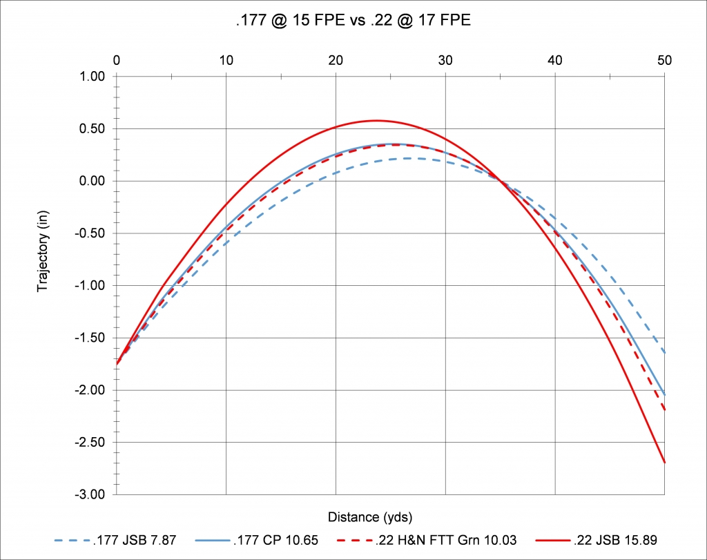

To take into account the possibility that some springers only reach maximum efficiency with calibers larger than .177, I worked up a new scenario where a springer in .22 obtained a 2 ft-lb advantage in muzzle energy over the same gun in .177 caliber. As expected, the gap between the two calibers has closed considerably, especially in the case of the lighter .22 caliber pellets. The heavy JSB 15.89 still has a rather loopy trajectory, although it does deliver a lot of energy downrange.

DanD is correct. The barrel length would not add 3 fpe. Springers benefit less from extra barrel length than do PCPs. In this case it is about swept volume. The higher area of the larger caliber makes it more efficient with the same shot of air.
