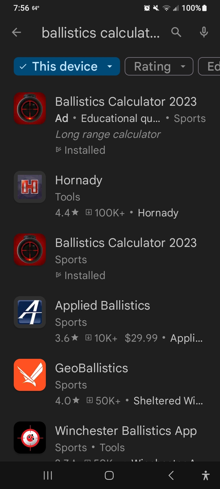

Does anyone here have any accurate data on stock R9 FPE or velocities at 50 with popular pellet brands ..Jsb,H&N..Etc ...14.66 to 15.89 grn...thanks in advance

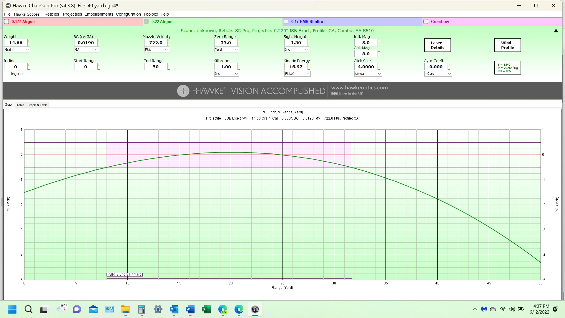

Gotcha. If you don't have a chronograph, down load Chairgun and you will be able to get that info. Ofcourse you'll need to know muzzle velocity. If unknown, use the mv from factory specs. The fpe will be very close between the two weights. Bill and AddiClose..but was trying to find out the fpe or speeds at 50 yards shot from the .22 R9.

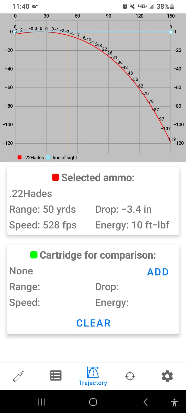

I know with Jsb Hades 15.89 are in the 660's at the muzzle and 605ish at 25 yards with a close .028 B.C. give or take but, I question if chairgun accurately can calculate the FPS from 25 yards to 50 accurately? Chairgun says its 10.6 fpe ...this calculation at 50 is reliant on the velocity at 25 yards at 604.Can this be trusted?Gotcha. If you don't have a chronograph, down load Chairgun and you will be able to get that info. Ofcourse you'll need to know muzzle velocity. If unknown, use the mv from factory specs. The fpe will be very close between the two weights. Bill and Addi

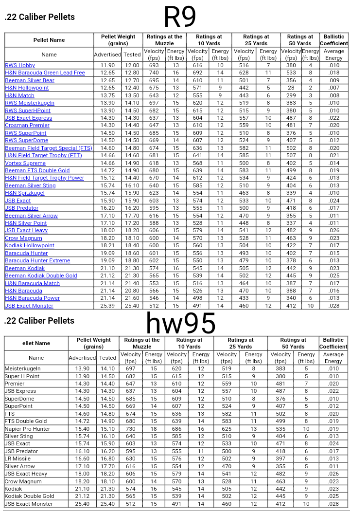

Check out with the one i useclose enough i reckonI know with Jsb Hades 15.89 are in the 660's at the muzzle and 605ish at 25 yards with a close .028 B.C. give or take but, I question if chairgun accurately can calculate the FPS from 25 yards to 50 accurately? Chairgun says its 10.6 fpe ...this calculation at 50 is reliant on the velocity at 25 yards at 604.Can this be trusted?
Deerstalker,would you be able to upload a higher resolution image of your data here ..I can't seem to read the numbers as they are blurry and the Imgur app required to view isn't working for me ..lol ...thanksFWIW, My HW95L .22 with an ARH kit with Vortek seal runs 720 FPS on average. Chairgun chart which closely matches my rifle actuals. Rifle is accurate for my plinking and sometimes I can keep a 5 shot group within an inch or better at 25 yards. I use H&N FTT 14.66 gr 5.53 mm
