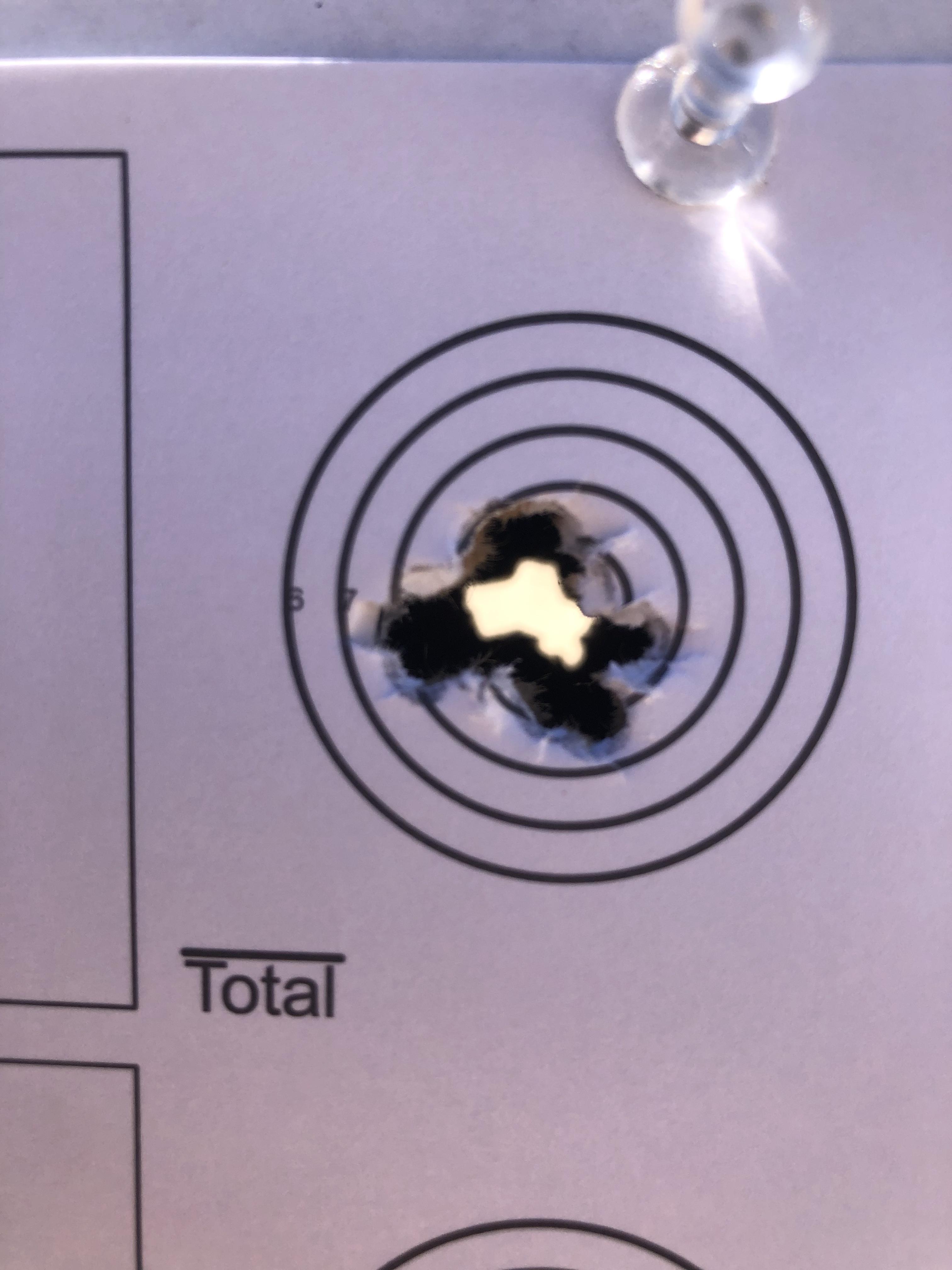

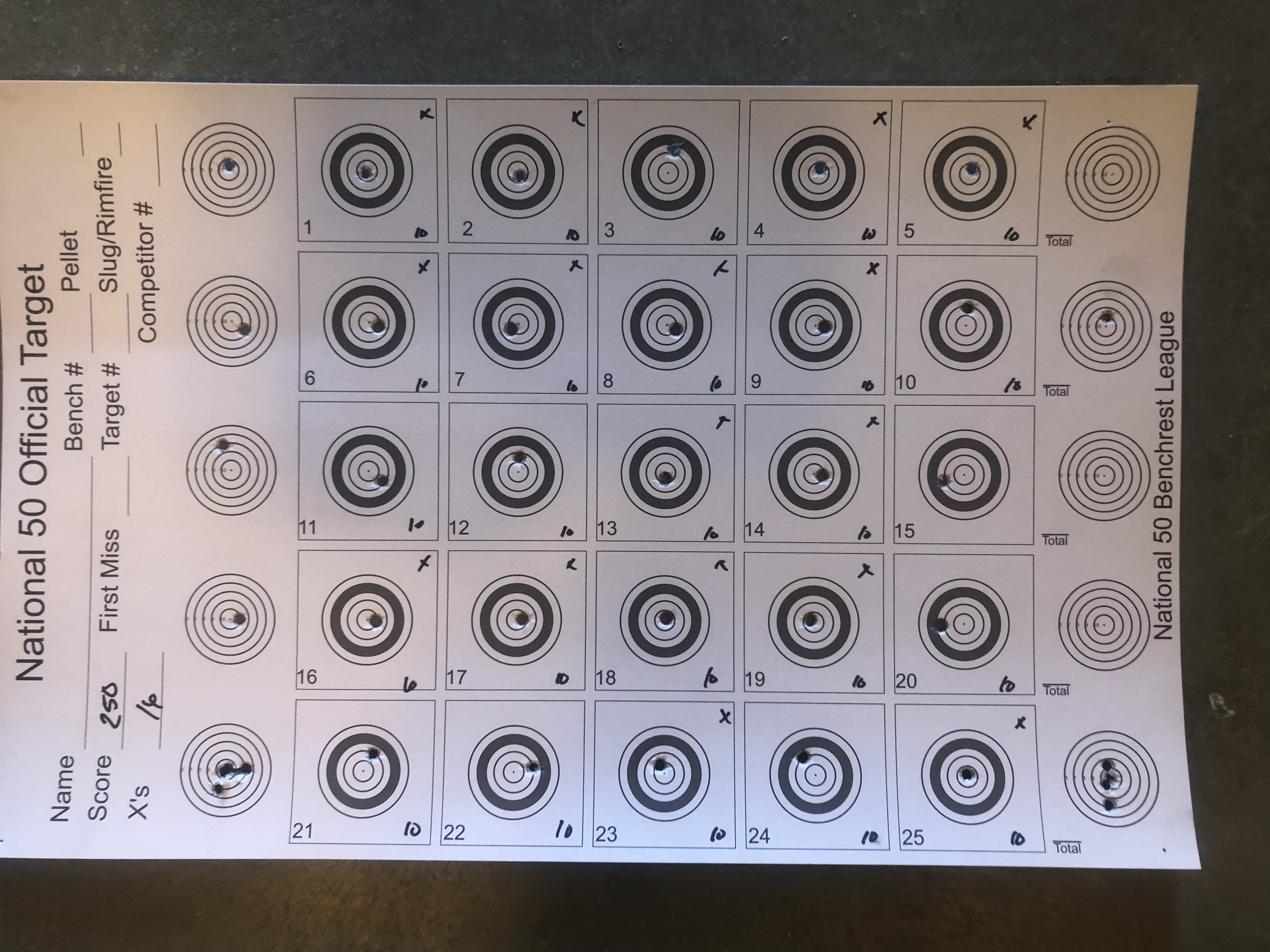

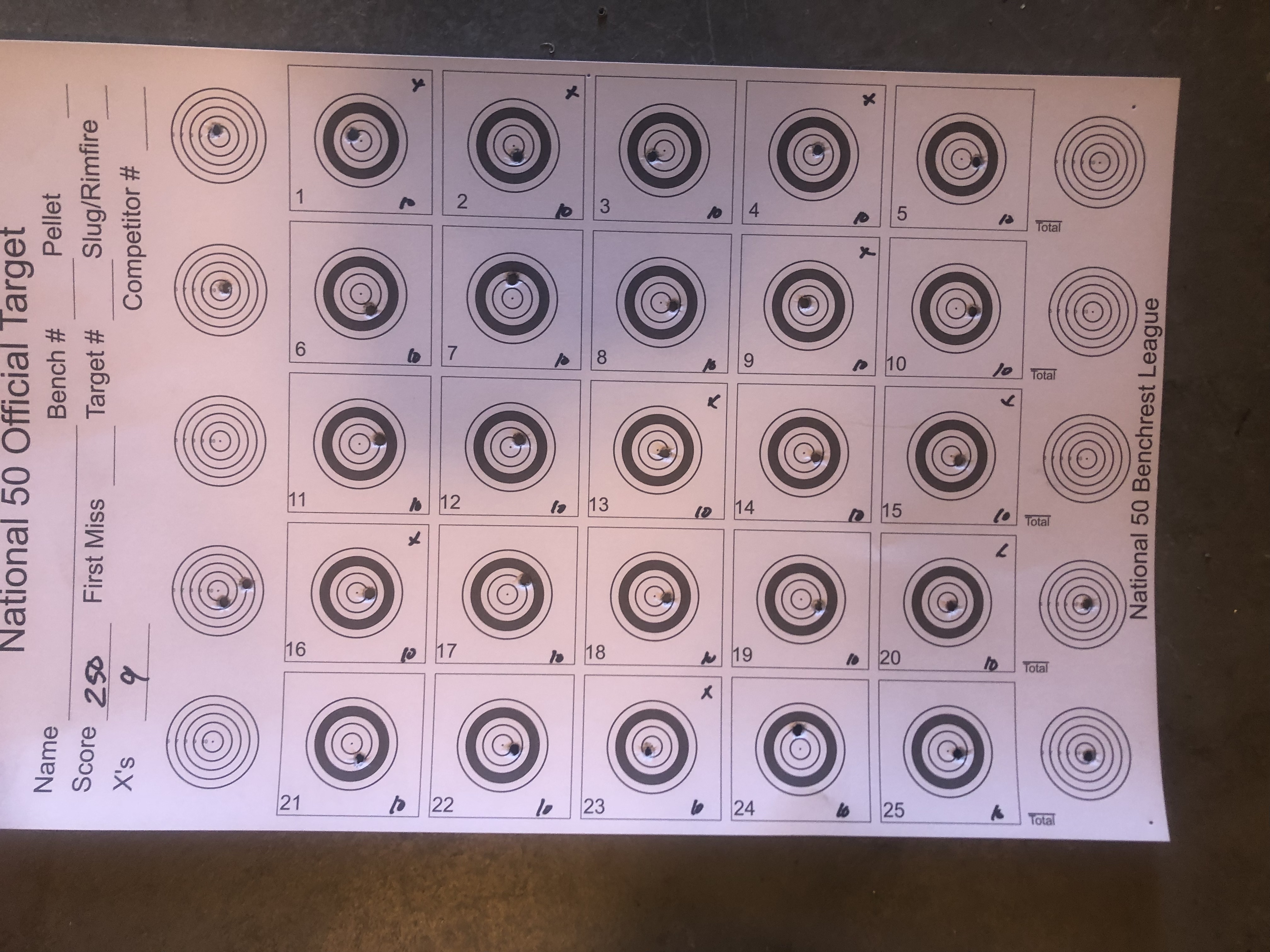

Here is a couple 25 shot groups and a couple N50 cards. The group in box 19 was at 50y, and the one on the sighter is at 50m. For the one at 50m….my wind holds varied from 2 rings right to well outside the rings. The odd thing about these is that they were shot at 780fps. The gun is very predictable and tracks in the wind just like it should. I can’t actually tell any wind drift difference compared to them at 200fps faster. Pretty interesting to go that hard against the grain and get a good result. This gun is going to a country where the BR50 rules limit them to 35 fpe.
