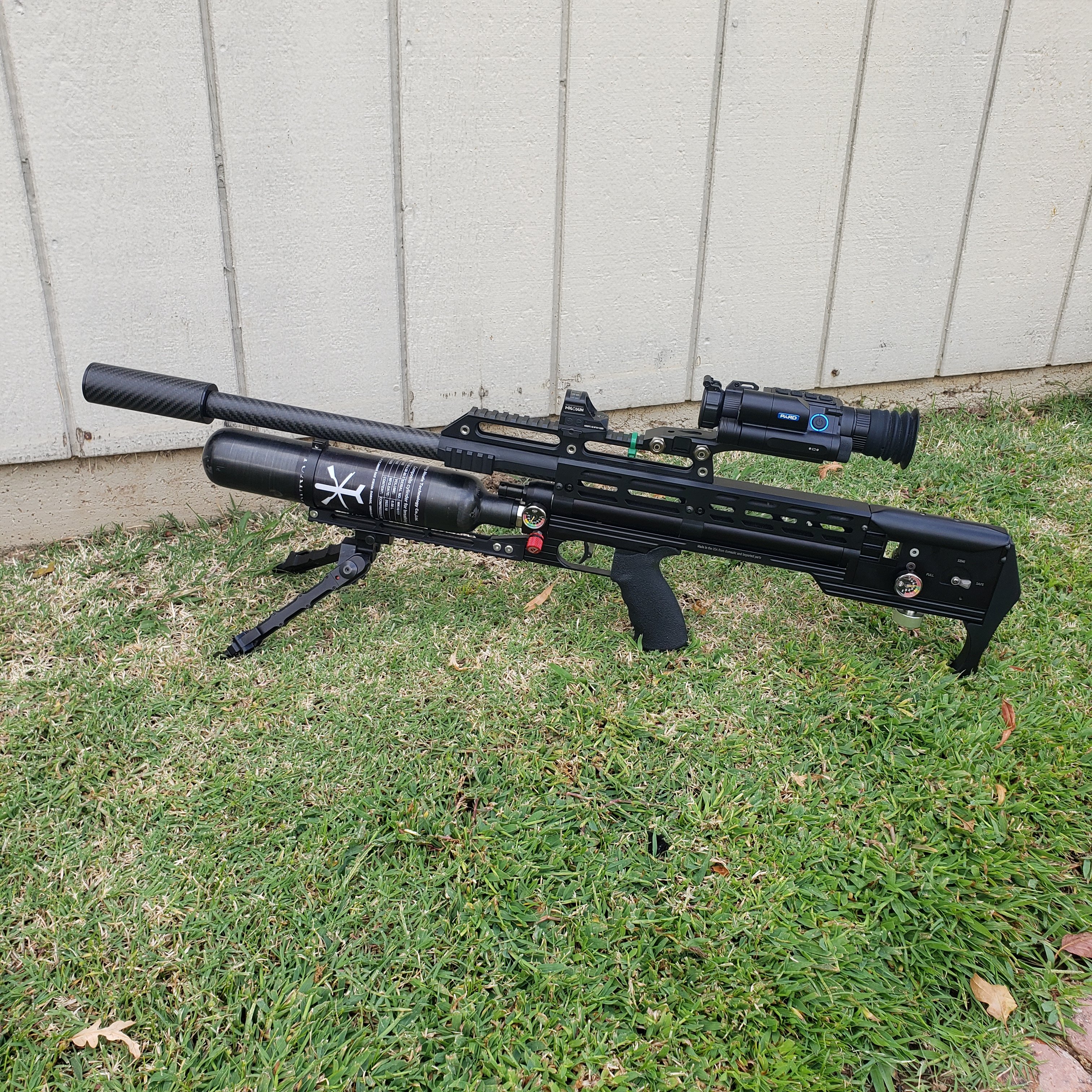

Last week I started playing with the .22 version of the sidewinder. I have the reg at standard 125 bar and the power wheel turned all the way in to be close as I can to backyard friendly. So right now it is lobbing out .22 15.9gr hades at 698fps. I am trying to keep the noise down. I topped it with the Pard NV008 LRF.
