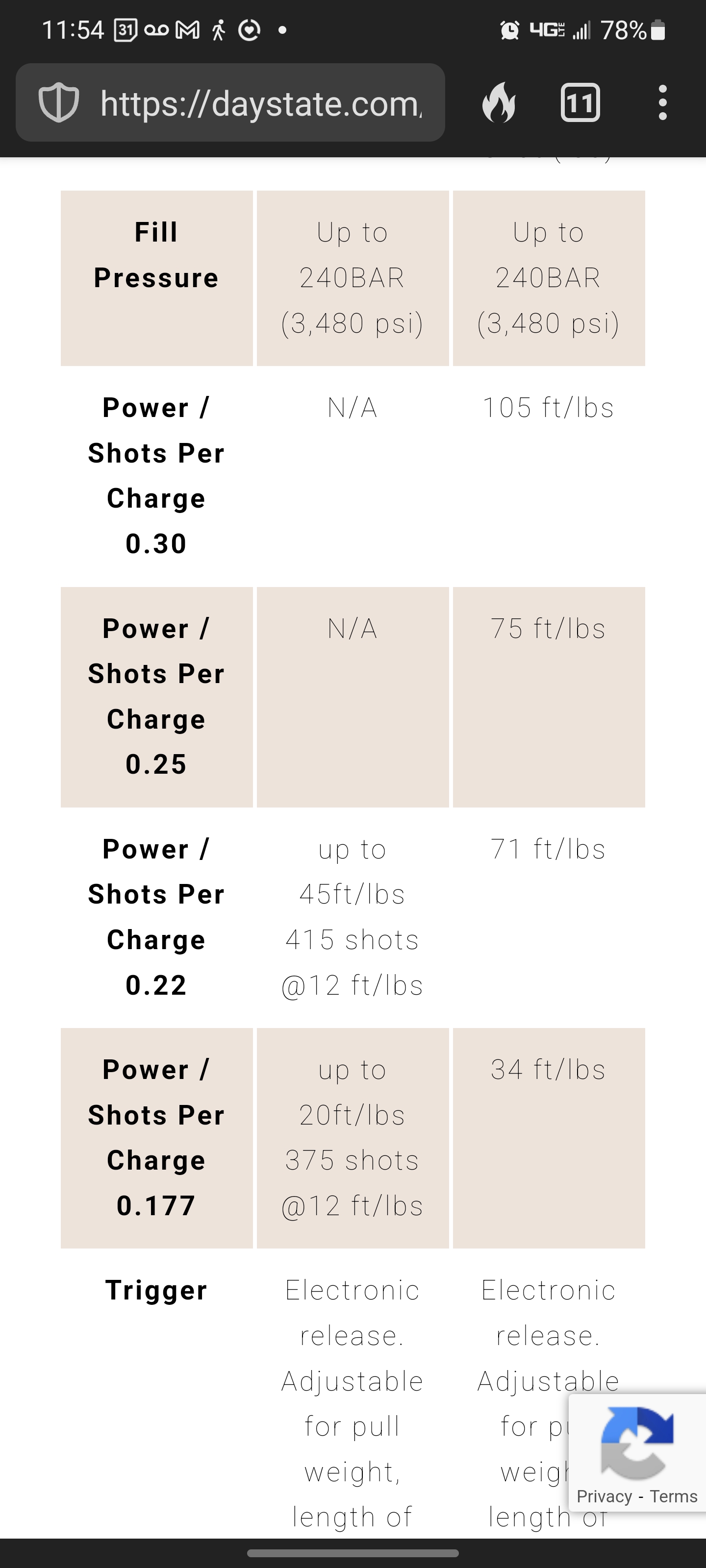

.25 has about 10 ft/lbs more then the .22 on average. I don't think this is a significant amount. 30 and above definitely does.

You are killin me with that comment 😱 I just put in a preorder for a GK1 Shorty .22 and I’m seriously wondering if I made the right choice not getting a .25

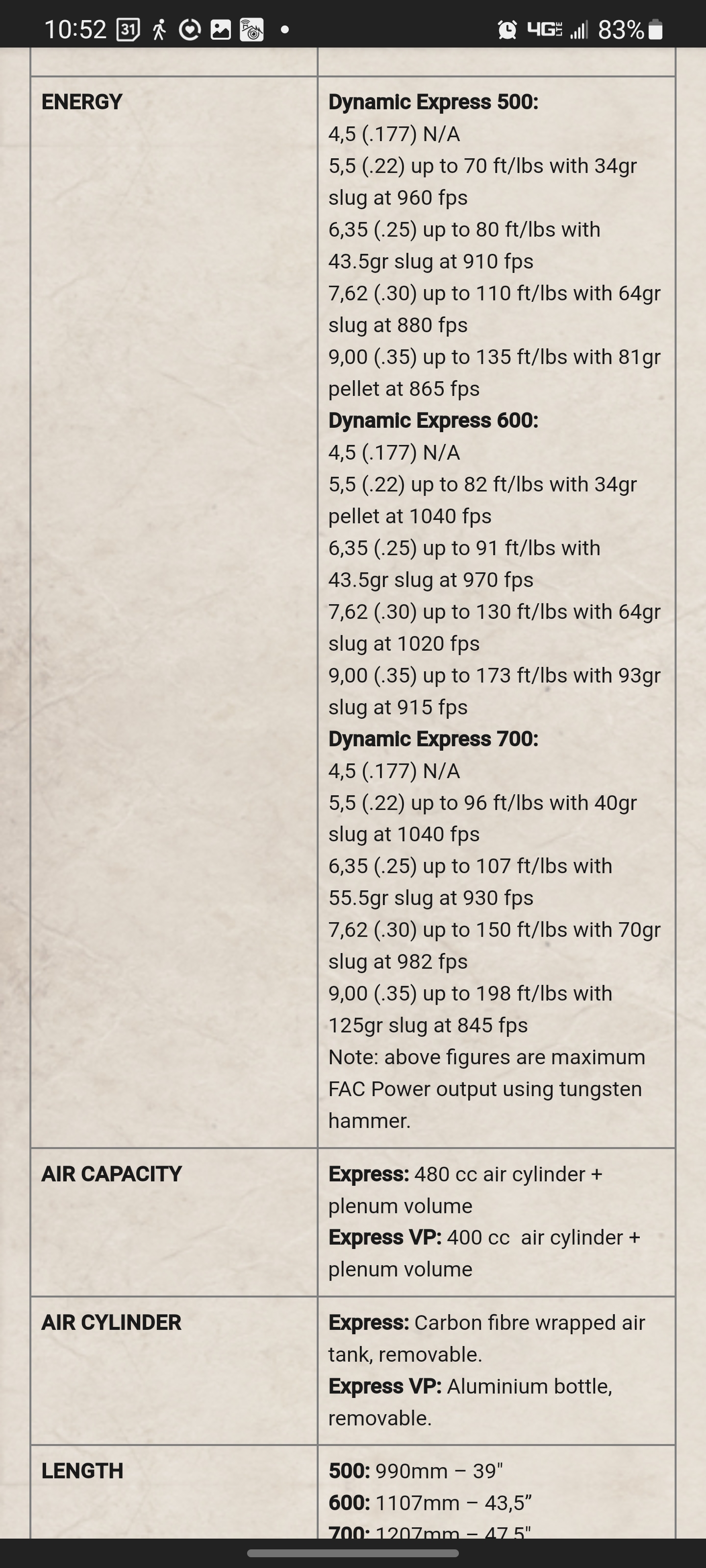

I have both, .22 and .25. My .22 hw100 is my pellet gun. It shoots 18.1 jsb at 890. Fun plinking gun, 77 full power shots at 31 ftlbs.
My .25 is a decated slug gun. 33 gr. at 990 fps or just over 70ftlbs. This is used for hunting, as you probably all ready know.
