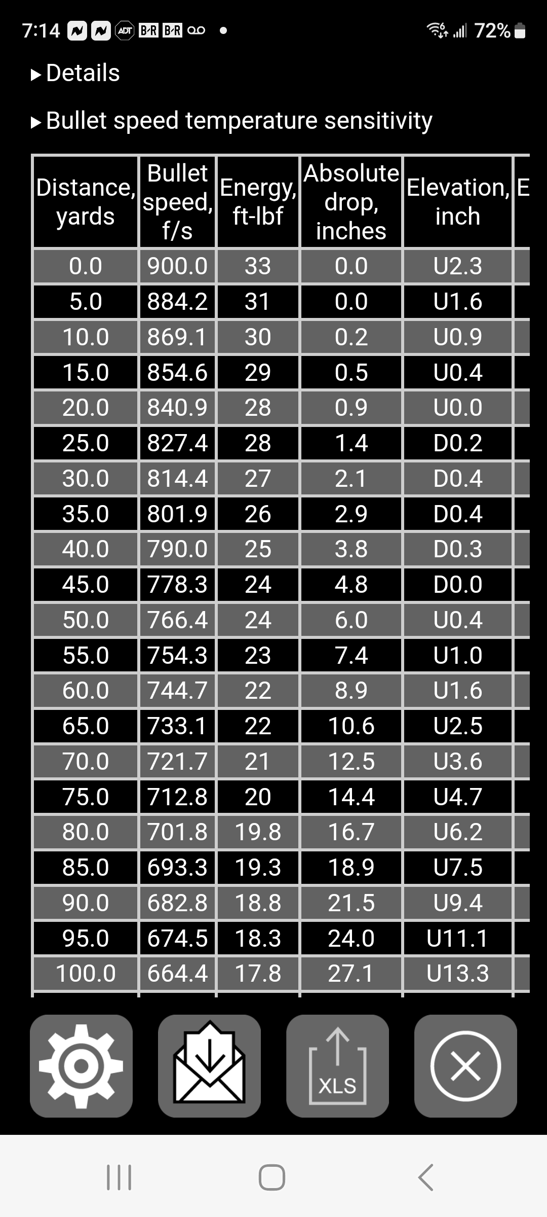

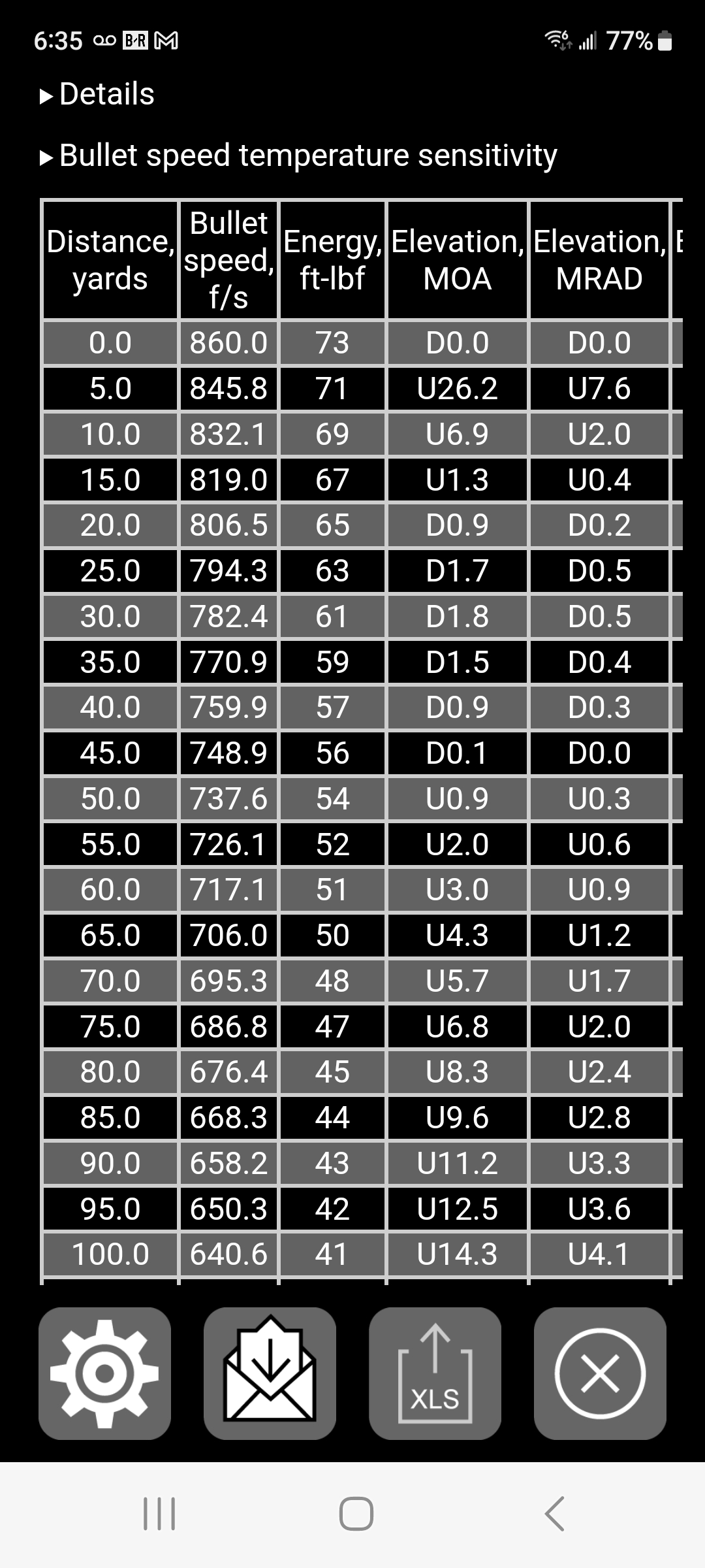

I have both and if I had to keep one it would be the .22.
If I had to pick a pure varmint eliminator it would be the .30. It happens to have more power (75 vs 55fpe) and it’s dead reliable. Shots cost more money in air and lead so it’s not an everyday shooter. The .22 would still be a potent varmint whacker but because it’s a Crown Continuum I can swap barrels and dial it down for volume / field target or put the 700 on and crank it up to hammer at longer ranges.
