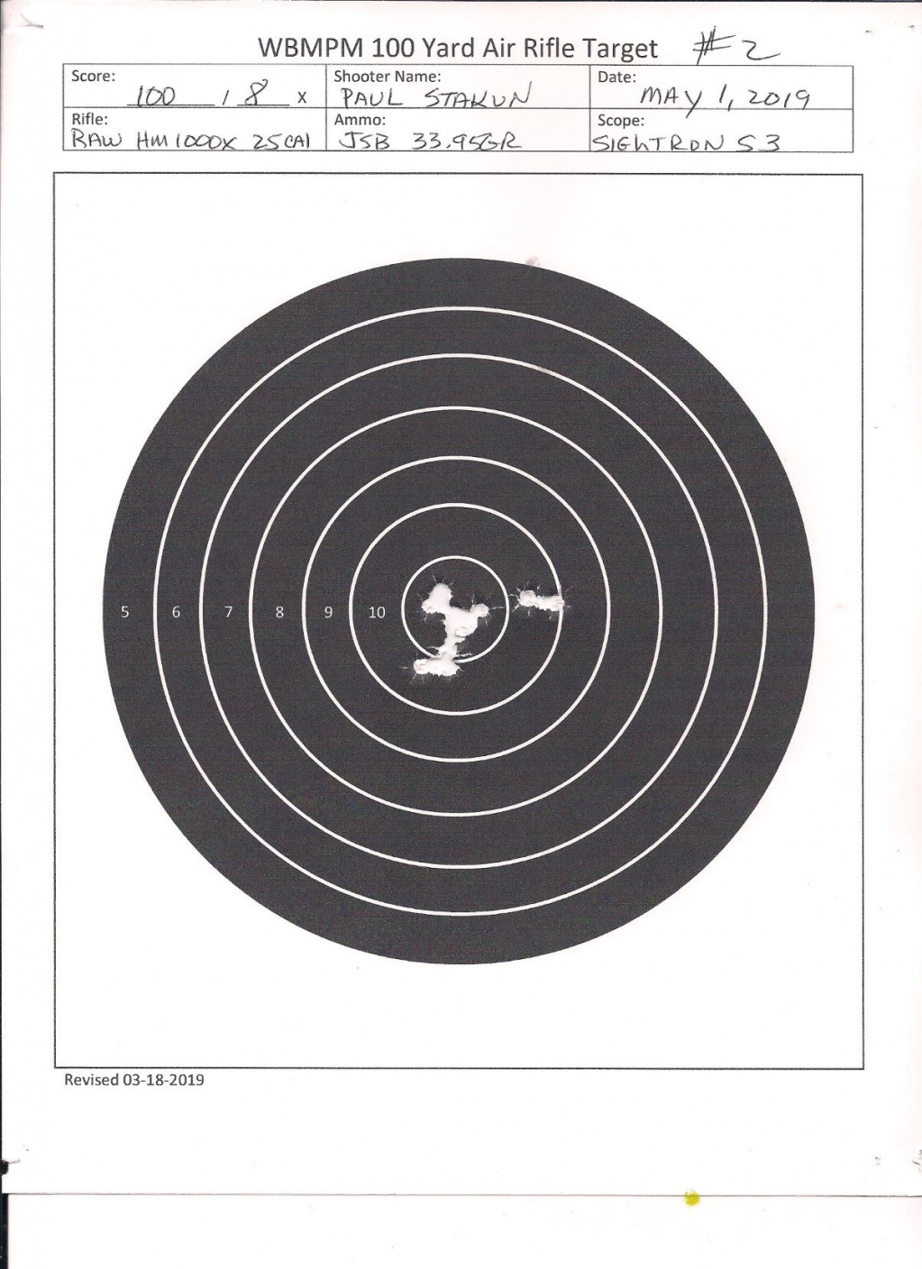

both are ok, if money is not an issue I will go .30 if not Monsters 0.22 agree very good both are quite accurate at 100y. As mention the good thing on 0.22 is that you can play more with the speed, with .30 you have more limitations. If you can shoot both @ 1000 fps (as max speed, so you can tune down a bit) .30 cal will be my choice for bench probably. But again Monsters are very accurate too ... both ways are good IME
If I recall correct, that is a 100m 8 shot group 0.30 44gn @ 950 fps
