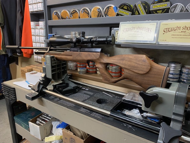

Purchased from Krale during the pandemic, this rifle is a Weihrauch HW100 T (thumbhole) in walnut. I paired it with a Hawke 6-24x56 Hawke SFP scope on top of Sports Match vertically adjustable rings. After it was received and the barrel was cleaned, I tested about every .22 pellet in my arsenal. While there was a close 2nd and 3rd, the H&N Baracuda Match in 5.53 diameter reigned supreme, particularly when the 50 and 88 yard target groups were factored in.
There are many things to like about this rifle. Built like a tank, perfectly finished, and among the quietest rifles I own. The magazine system is very simple, can be kept loaded because there are no springs to fatigue in the magazine, and the anti-double feed system is very nice. The trigger is as close to perfection as one can get in terms of adjustability. If there is any downside, I only get about 28 shots before it falls off the regulator, but as accurate as it is, I can't see that as an issue.
Pulling it out of the vault last week, it didn't disappoint. I hadn't shot it for at least six months because I loaned it to a friend. I didn't do anything to it but stick the fully loaded magazines in it and start shooting utilizing my indoor 18 yard test range. The results can be found below. I have also included the "best performing" 50 yard targets from the original pellet tests. This is an heirloom rifle that will last many generations with care.
