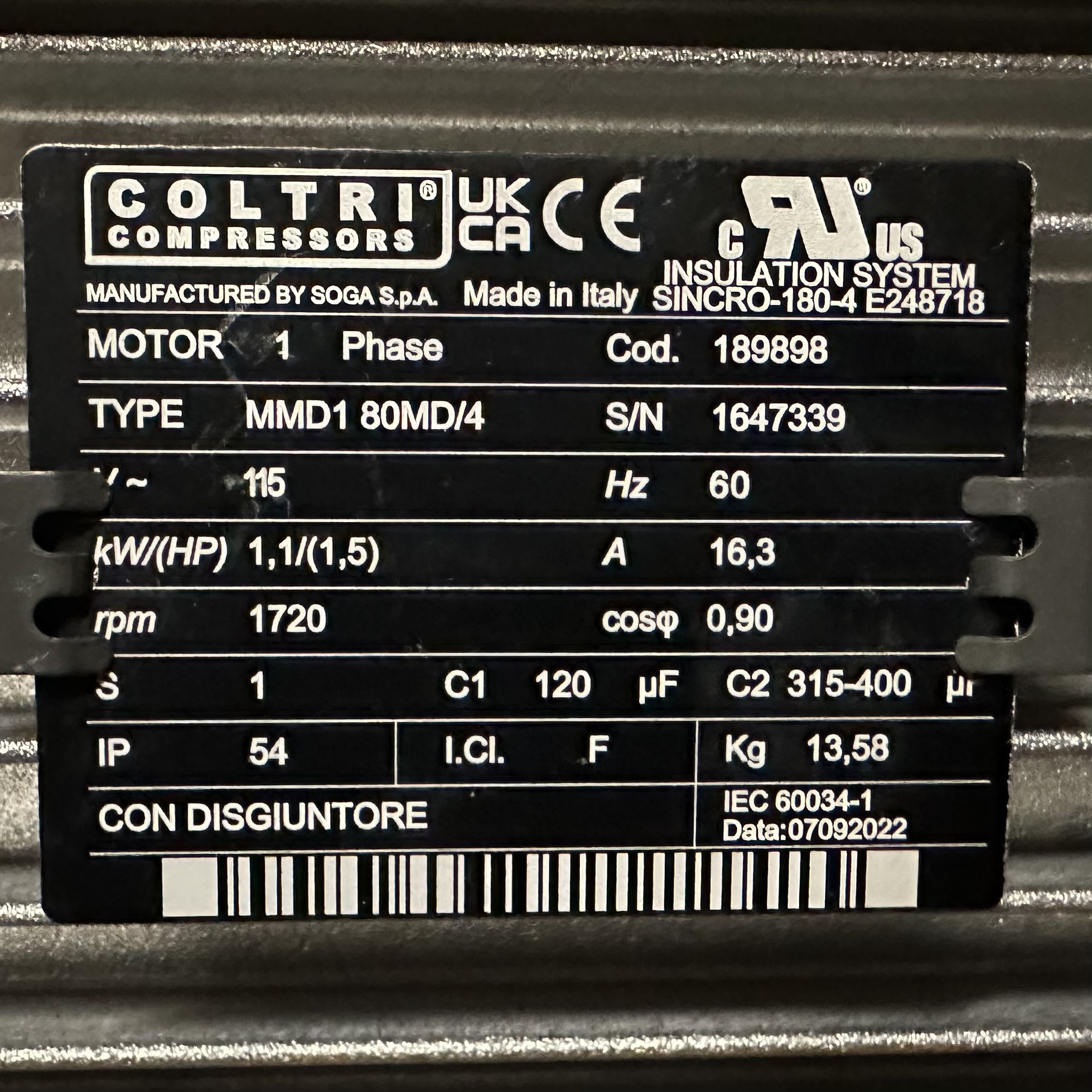

I was told this compressor is the latest 4 stage unit.
View attachment 336918View attachment 336919
The older LC110 below has a 3 stage pump (MCH3). The hole from the missing stage is covered by a blanking plate.
Reactions: iAMzehTOASTY1

Some of the advantages of the 115v compressor are:
  • $2500 compared to $3500
  • Lighter weight
  • Significantly less noise
  • Low power consumption (not sure how to quantify that)
  • Standard 110v receptacle (likely the greatest factor)
