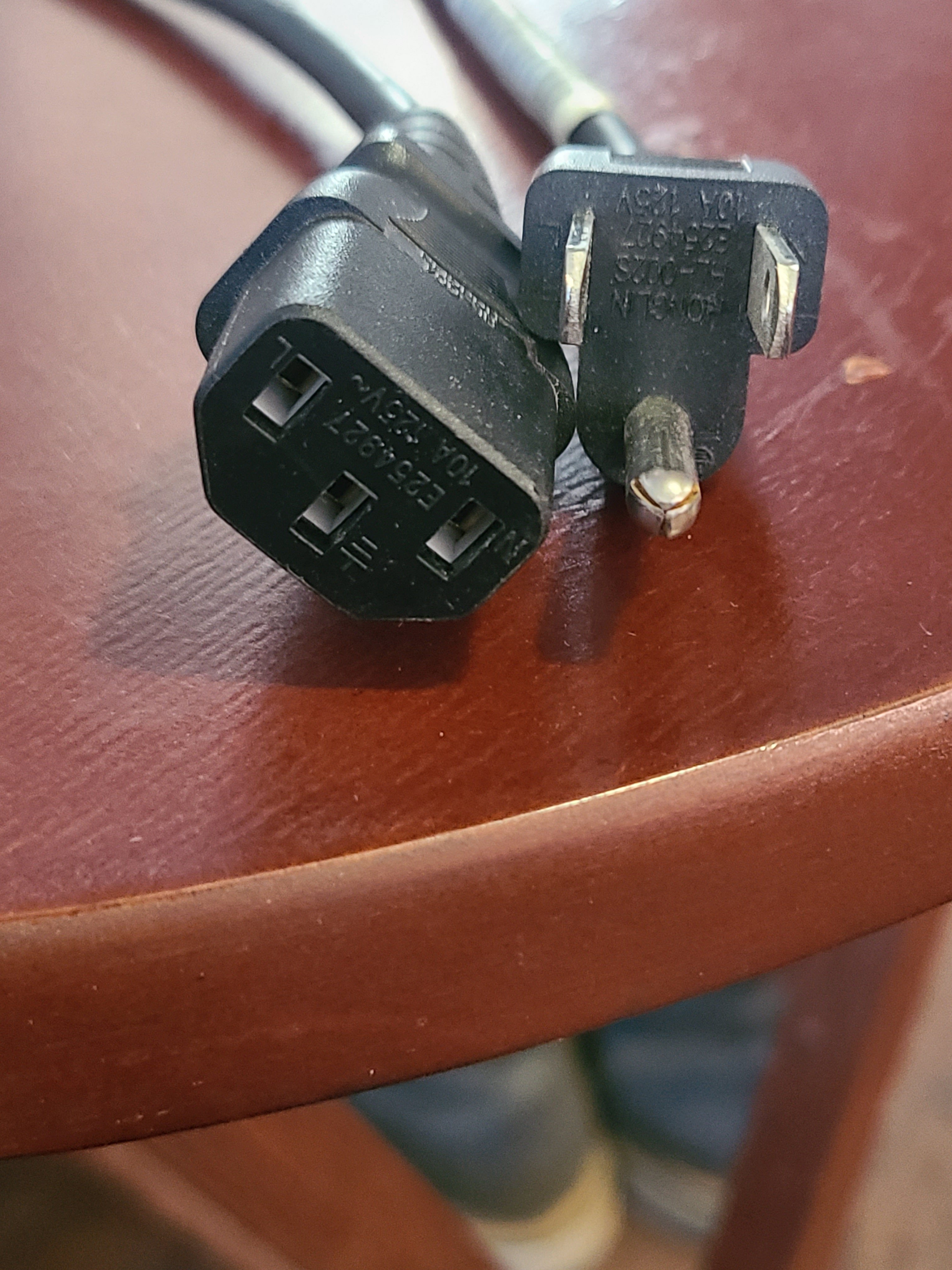

Im wondering if anyone else has a 220 version of the Yong Heng, and if so, if they would examin the wire size of the included cord, and see what size of wireing Yong Heng sent with their 220 compressor.
Years ago, I ordered a 110 Yong Heng, but received a 220 version.
I contacted the seller, and they allowed me to keep the 220 device for free, and promptly sent out a 110 version.
Whatever the reason, the seller did NOT want me to return the 220 compressor.
I suppose that the cost of return shipping, was greater than the cost of the compressor.
So I never even opened it, and have absolutely no money invested in it.
Worse case, it might be a great source for parts, for my 110 Y.H. version, with exception to the motor.
I never even opened it, and simply put the 220 compressor off to the side, unopened, thinking that the company might eventually want me to send it back, but they insisted that I keep it.
So it has sat for 4 or 5 years, unopened, in a dry basement.
I just recently opened it up for the very first time.
This Young Heng 220V compressor was brand new, was sealed, and clearly labeled as 220 volts.
Once I opened it up, and saw the cord, I thought maybe it was simply mis-labled, and possibly a 110 compressor afterall, despite it being labled as 220.
The 220 compressor cord looks exactly like a 110 cord.
The included water pump, (unlike the 110 version, plugs directly into the side of the Y.H)., is also labled as a 220 volt water pump.
I very briefly, and I do mean VERY briefly, plugged the compressor into a 110 outlet, and no surprise, it does not work on 110 volts.
Just a quiet "HUM" for noise.
So it seems to be correctly labled as a 220 compressor.
But it came with this very lightweight, 18 gauge, 300 volt cord that looks EXACTLY like a 110 cord, but will not fit a 220 outlet.
Now Im scrathching my head!
Im thinking that I could simply cut the male end off of the cord, purchase a correct plug to fit a 220 wall outlet, and be good to go, BUT...
BUT 18 gauge wire seems much too small for a 220 volt device.
WIREING IS WAY TOO LIGHTWEIGHT FOR 220 IN MY OPINION!
So I removed the compressors outer housing, and examined the wireing on the inside, that goes to the on/off switch...
It too looks to be very lightweight and probably 18 gauge as well.
Im just wondering if anyone else has a 220 version of the Yong Heng, and if so, if they would examin the wire size of their included cord, and see if they too have 18 gauge wireing.
Is 18 gauge wireing, large enough, for a 220 device?
Attachment cords are usually undersized being they are under 6' in length. Your compressor should draw, 7.5A @ 240V. I would make sure the supply breaker is a 2 - pole 15A. How long is the cord? You could also source another heavier cord that has the same female end. It looks like a computer monitor cord.
Reactions: Airgun Al
The Yong Heng included cord is about 5' in length, and the female end is labled as 250 Volt, and 10 A, while the cord itself is labled as 18 AWG and 300 V.
I agree, that it looks exactly like a common 110 v. , IEC computer, or guitar amplifier cord.
Im by no means an electrician, so when I saw the 110v style male end, and the small diameter cord, a red flag went off in my mind, as not being correct for a 220 outlet (true), and also not being large enough for 220V service (false).
But apparently, if I simply remove and change the male end to fit a 220 wall outlet, the 18 gauge cord will indeed be heavy enough ....I think!
I will then proceed with extreme caution, and if the compressor begins to spin properly, I will certainly monitor the temperature of the cord carefully for a while, especially when used for any extended period.
Thanks for your help!
MORAL OF THE STORY: If you order a 220V Yong Heng compressor, the cord will need to have the male end cut off, removed, and replaced with the proper 220V end!

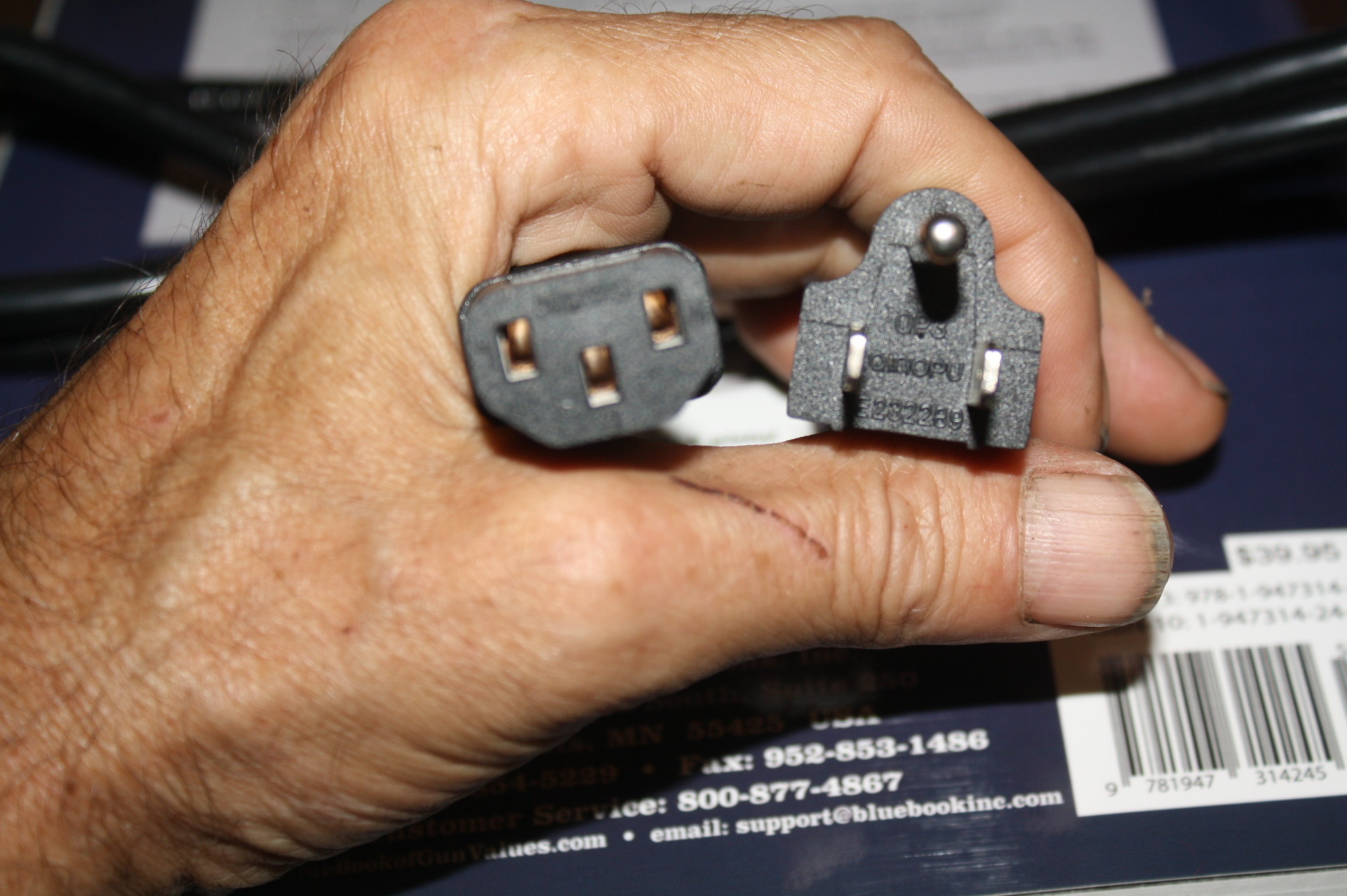

That male plug must be a Chinese thing. I had a neighbor years back bought 3 small 220V machines directly from China and they had the same configuration as our 120V plugs. Definitely strange. From what you had described, it doesn't sound like you would be able to change taps to run it on 120V. What's the amperage of your 240V receptacle. If your using it for a welder, I would assume it's at least 30A. I wouldn't run this compressor on anything over 15A @ 240V. If the compressor motor overload fails and there is a locked rotor, the wiring on the motor, etc. would burn well before a 30A breaker would trip. It has to be fused correctly. Be safe.
