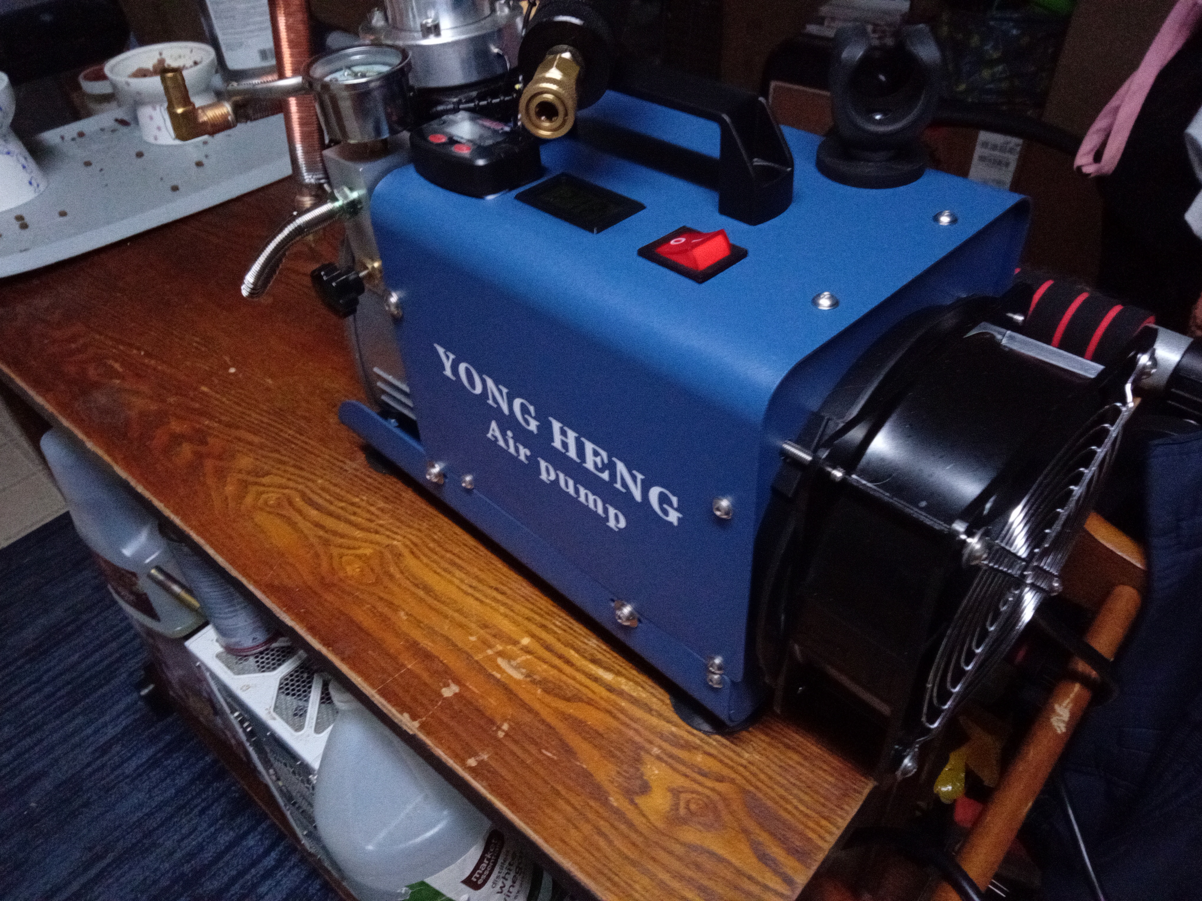

220 Volt Yong Heng?
Is 18 gauge wireing, large enough, for a 220 device?

18 gauge wire would be small for 110V for the YH but fine for 220V. Depending on the temperature rise you consider acceptable and the length of the wire I saw values of 12-16 amps limit for 18 gauge in a quick google search. The YH should draw no more than 8 amps on 220V. Current for a given wire size is more complicated than some would think since the length of the wire makes a significant difference. In a house, 14 gauge wire is used for 15A circuits and 12 gauge for 20 amp circuits.

I believe I will simply swap the male end of the included power cord, so that it fits my 220 wall outlet, and proceed with extreme caution!
And I do mean EXTREME caution!
