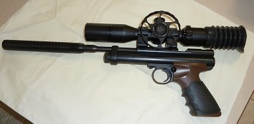

2240 First Chronograph string and question for CO2 Gurus!
bone stock 2240 except trigger mod. Temp in the Garage was 90 degrees. 100 plus outside. First shot with 14g pellets was 470fps. slowly crept up to a high of 479fps. Shot #23 first time velocity dropped below 400 down to 395. at shot #28 the velocity dropped below 300 to 295fps. .Question is: If it's shooting a little hot because of temperature is that going to give fewer shots at the top of the velocity?
