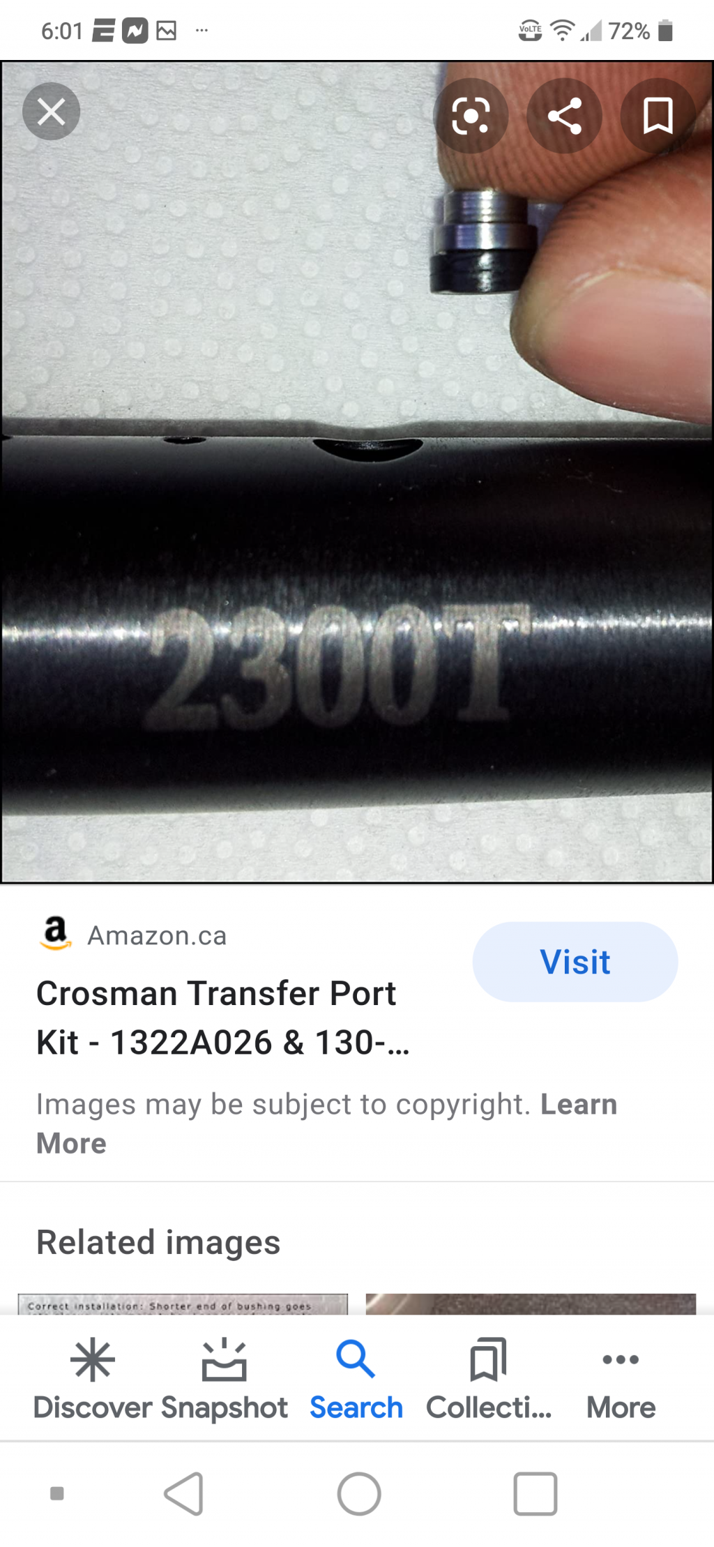

I recently purchased the 2240 Crosman pistol also I purchased the steel breech to go with it . I shot it before I did any work to it and it seem to function fine with the plastic breach. After I installed the steel breach I had great difficulty feeding a pellet into the chamber
it seem to not want to make it past the transfer port. After examination with a flashlight I could see the transfer port appeared to be sticking up Fairley High and there was quite a bit of space behind it towards the bolt. It is next to impossible to seat a pellet into the barrel the way that it is right now. Any help with this situation would be greatly appreciated
