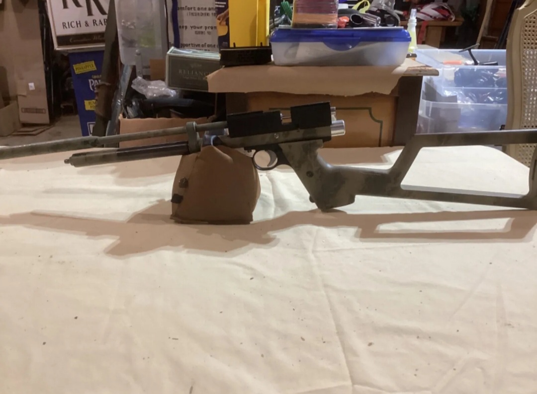

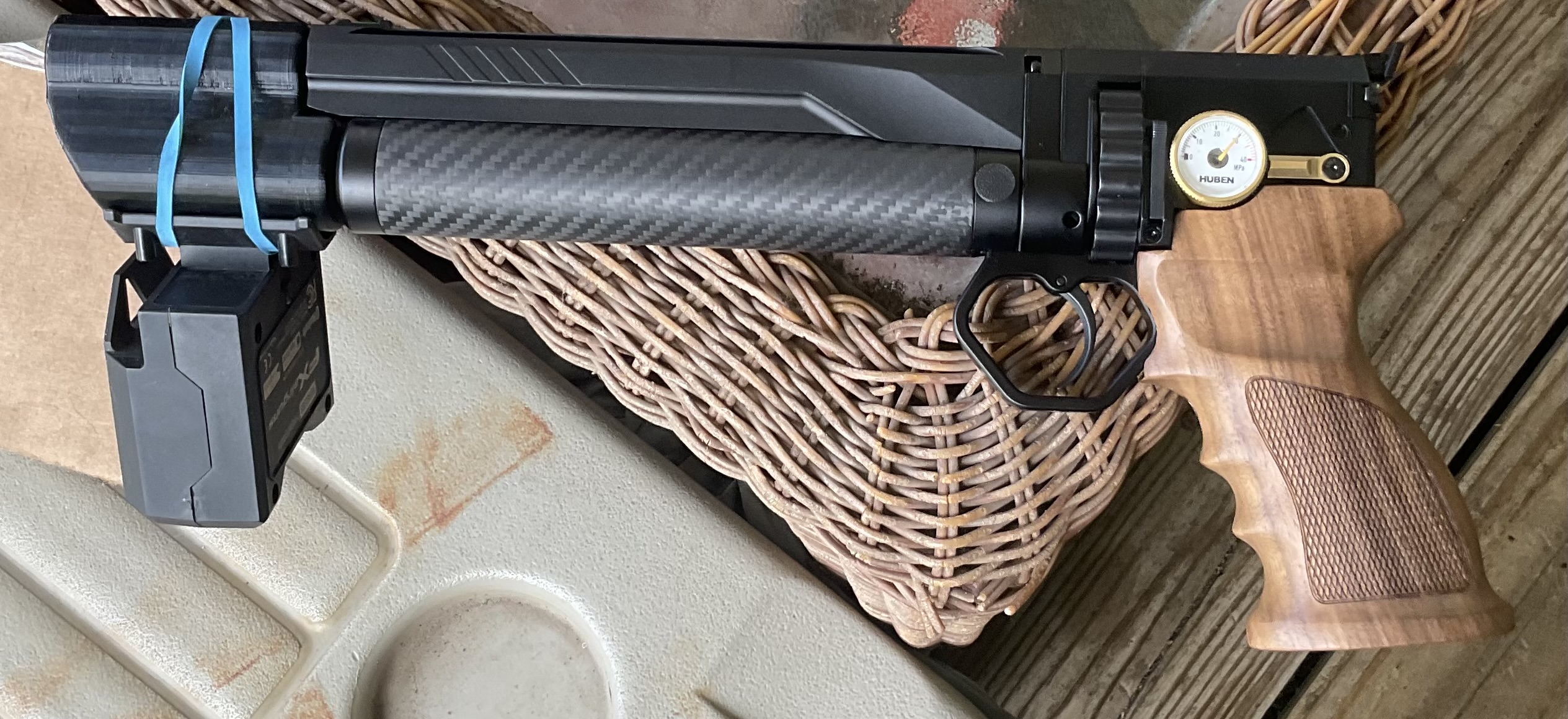

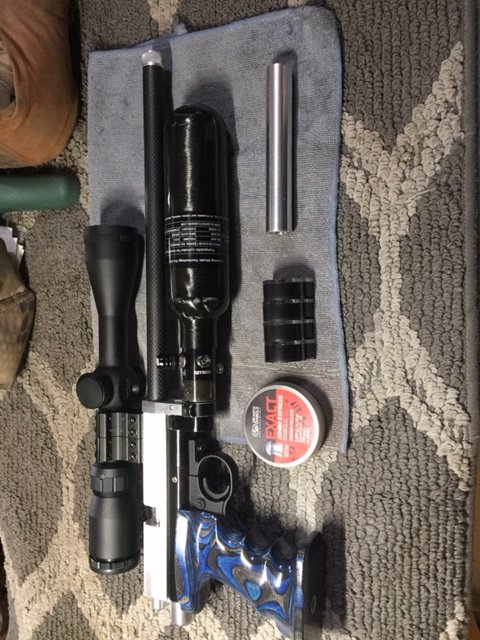

Now here's one I built 4 years ago. Home made lefty action (best for pistol) using Prod mags, P-rod trigger frame, modular valve for quick servicing. Two side screws and the whole powerplant comes out for resealing. Scrap wood trimmings glued together as this was my first try at blind inletting. Crosman 12" barrel, good for 22 fpe with JSB 18's @ 745 f/sec.
wow! That thing looks AMAZING!

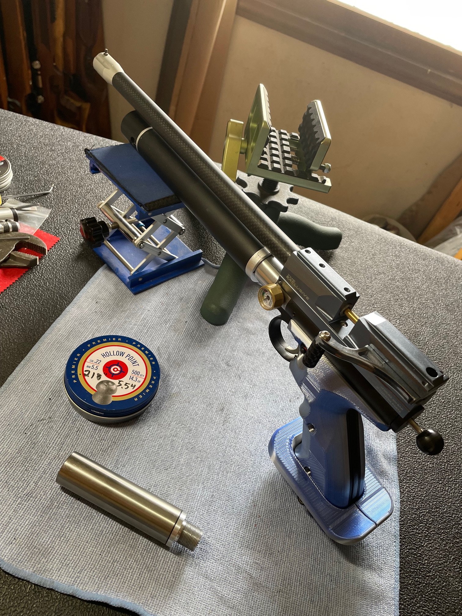

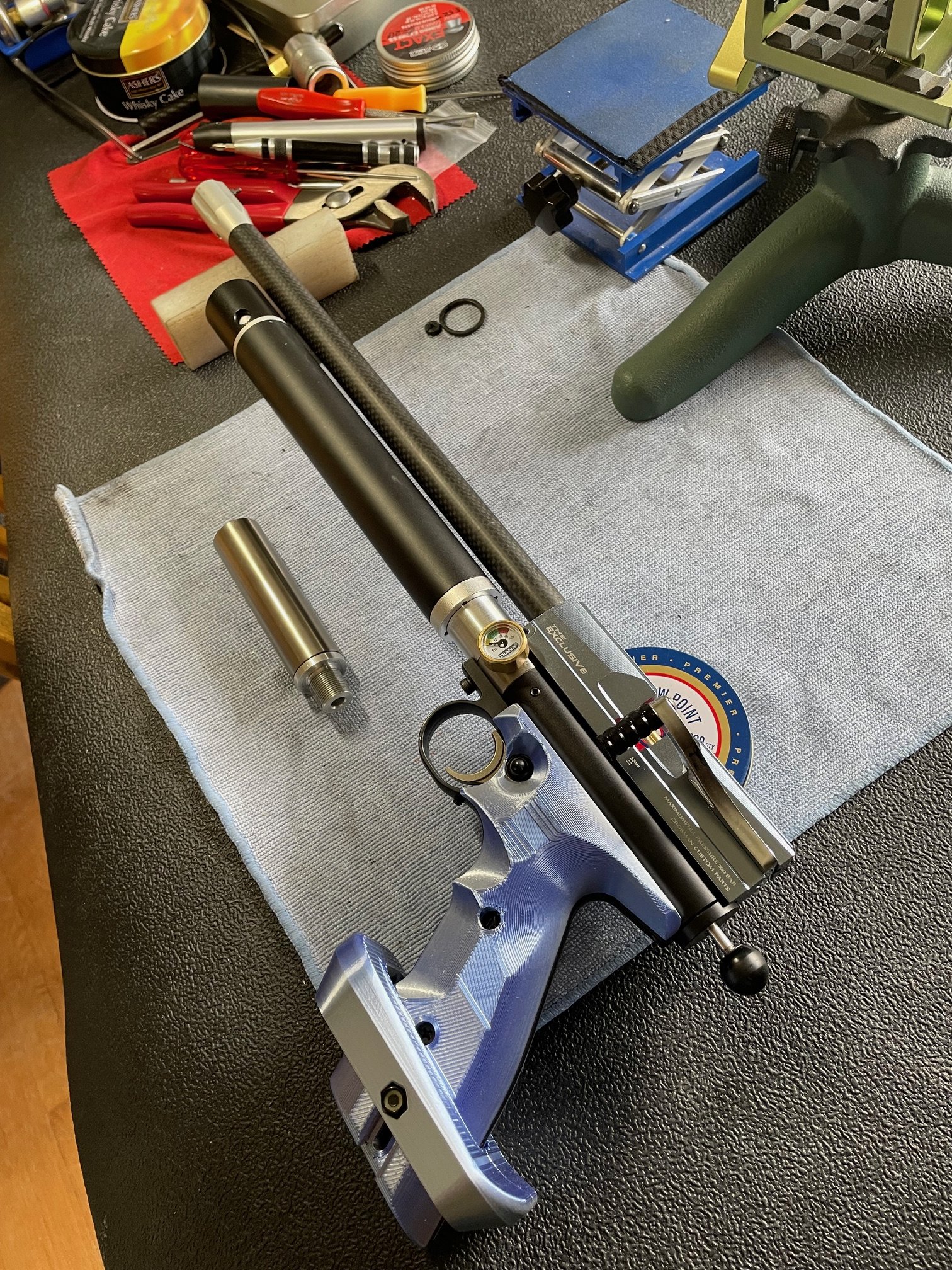

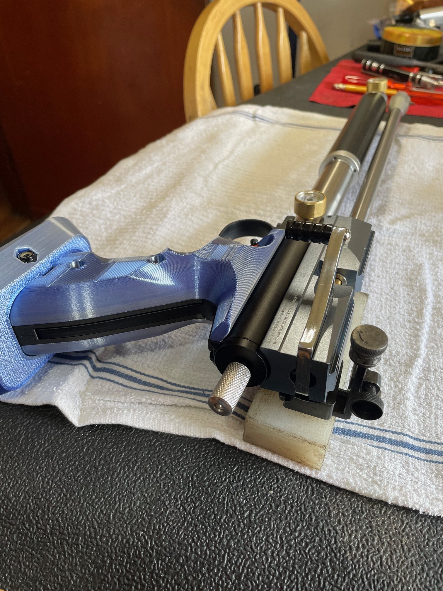

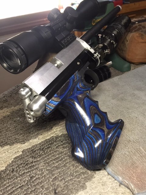

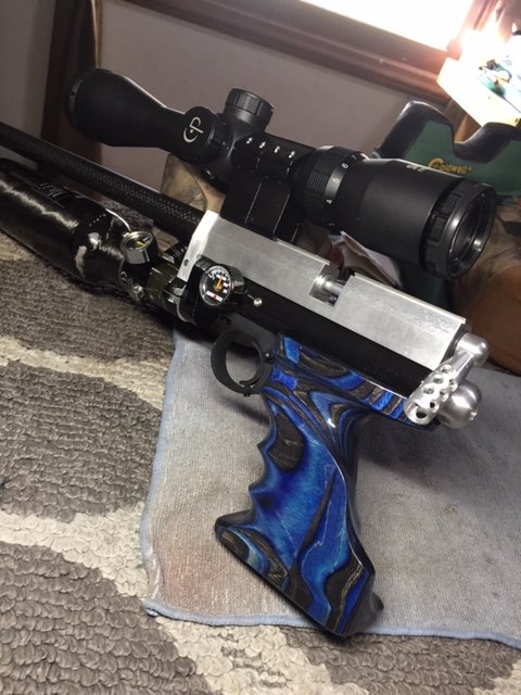

This 2240 I built together with my younger brother. He wanted one in .25 cal and laminated stock. Eastern block polygon barrel 24" long. Modified Exclusive breech, Remington trigger, carbon bottle and home made moderator. It's set @45+ fpe currently, .465" center to center 10 shot groups @ 40 yards. It's posted also on Air Rifle Tuning & Tweaking group.
Fantastic work. This is of if not the best modded 2240 I’ve ever seen.
one of the best modded 2240s I’ve ever seen.
