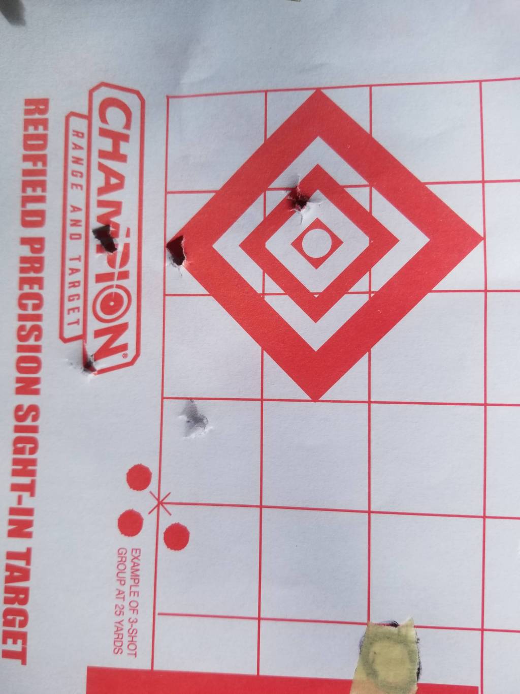

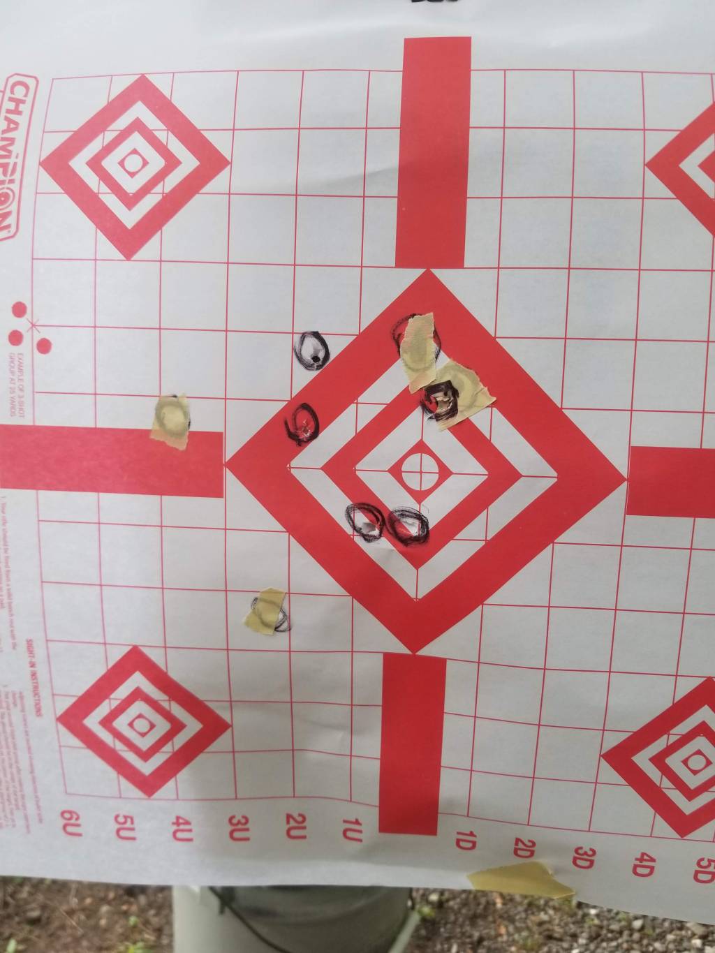

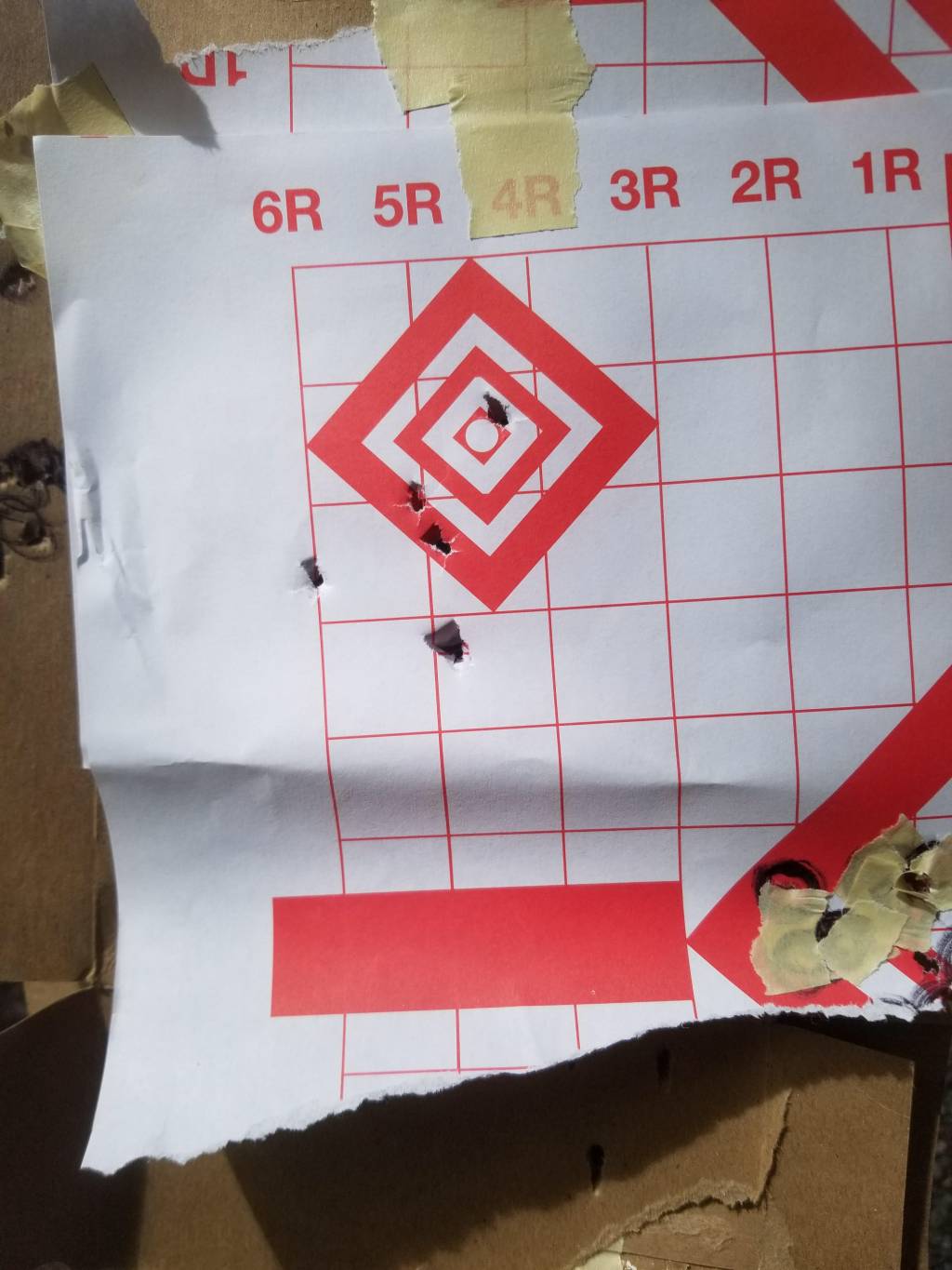

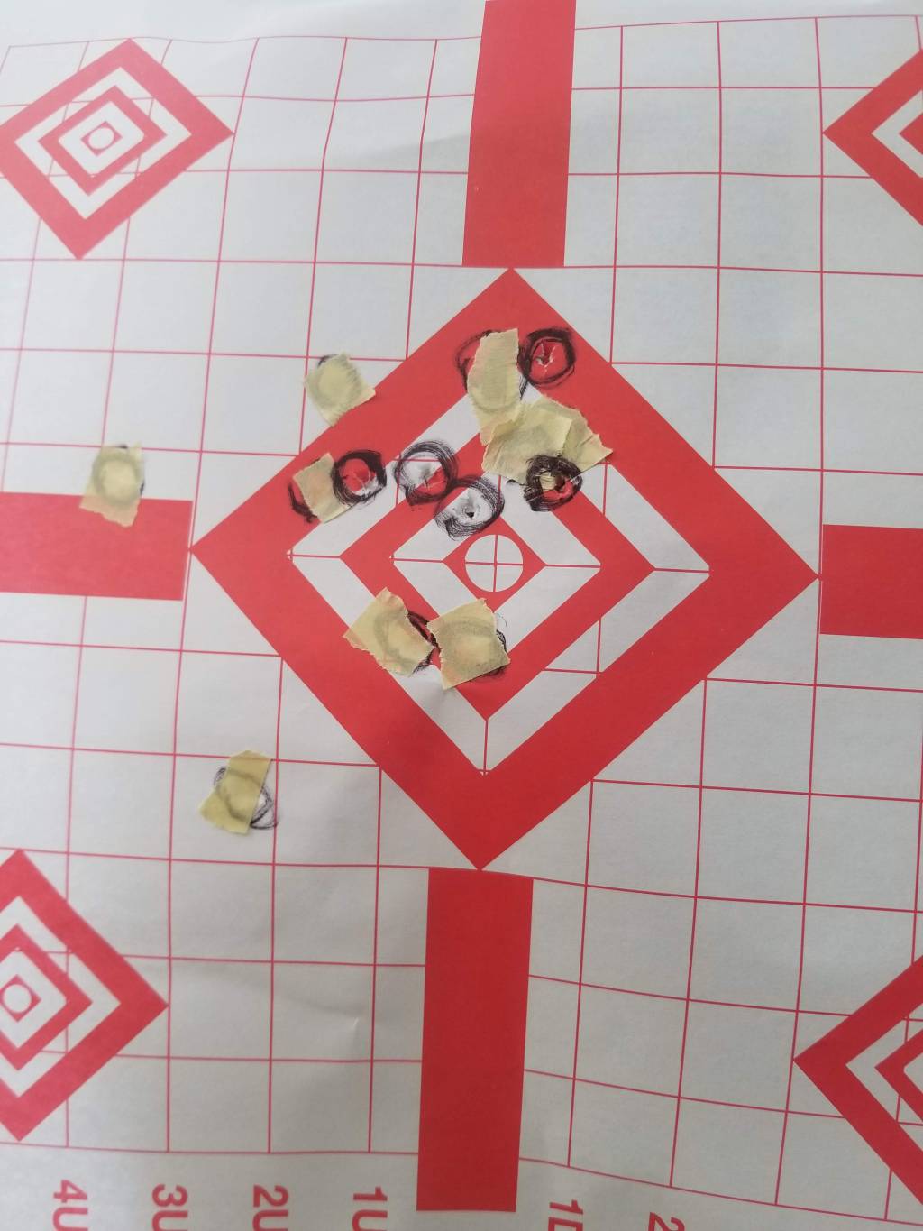

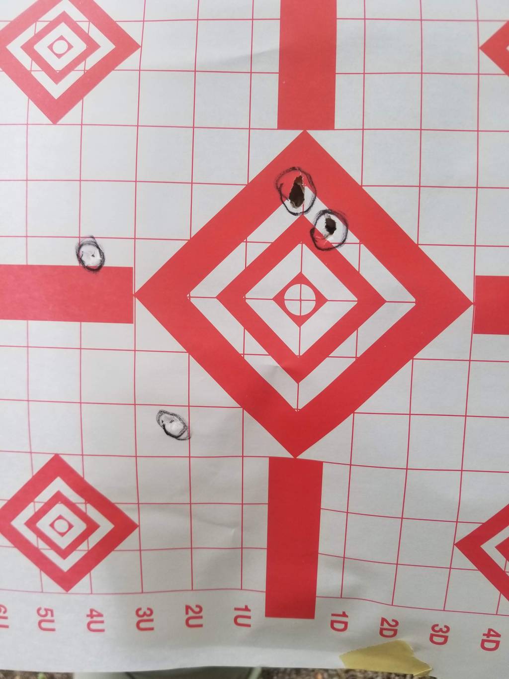

Thank you for that info here is what the groups look like maybe I’m expecting to much this is at 20 yards end of barrel to target face off a support.this is with a new air cylinder seems to like the crossman pellets and the H&N the 2 pictures on left are the 17.75gr
Yeah, unfortunately all of the .22 Crosman barrels I have gotten lately have been absolute junk. You could try and lap them, but the last one I checked had an extremely loose bore. Basically no way I could make it shoot. This is why I am so willing to recommend spa/diana/artemis guns for out of the box accuracy.
It doesn't even look like your pellets are flying straight.

Ya its just to inconsistent, dot never leaves poa,cleaned barrel,cleaned up trigger,weakened spring,tightened everything.All the usual stuff.probably going to get a better barrel.
