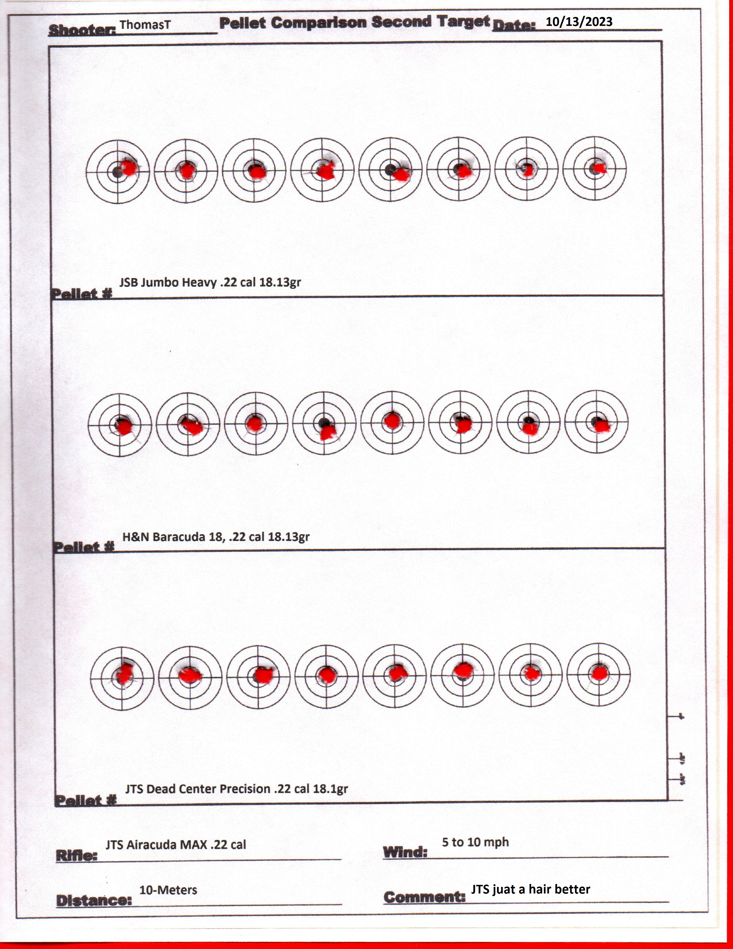

Hello everyone,
I received my order of new 18gr pellets and will now run several shooting test to compare all three Brands. I will test each pellet at 10-meters and then at 25-yards and shoot them straight out of the Tin. After zeroing the scope on a separate target and filling the rifle to 3,000psi, I will shoot eight (8) times at my “Pellet Comparison Second Target” paper target. I will repeat this procedure for every test at both 10-Meters and 25-Yards. The three “open” rings are 1/4", ½" and 3/4" and the Black Dot Bull is 1/8".
The three pellets/brands are:
1) JSB Jumbo Heavy, .22 cal 18.13gr
2) H&N Baracuda 18, .22 cal 18.13gr
3) JTS Dead Center Precision, .22 cal 18.13gr
Below are the results for the 10-Meter Test and I will post the 25-Yard Test results later. As you can see, the JTS is just a hair better in the grouping. It will be interesting to see the 25-yard results.
ThomasT

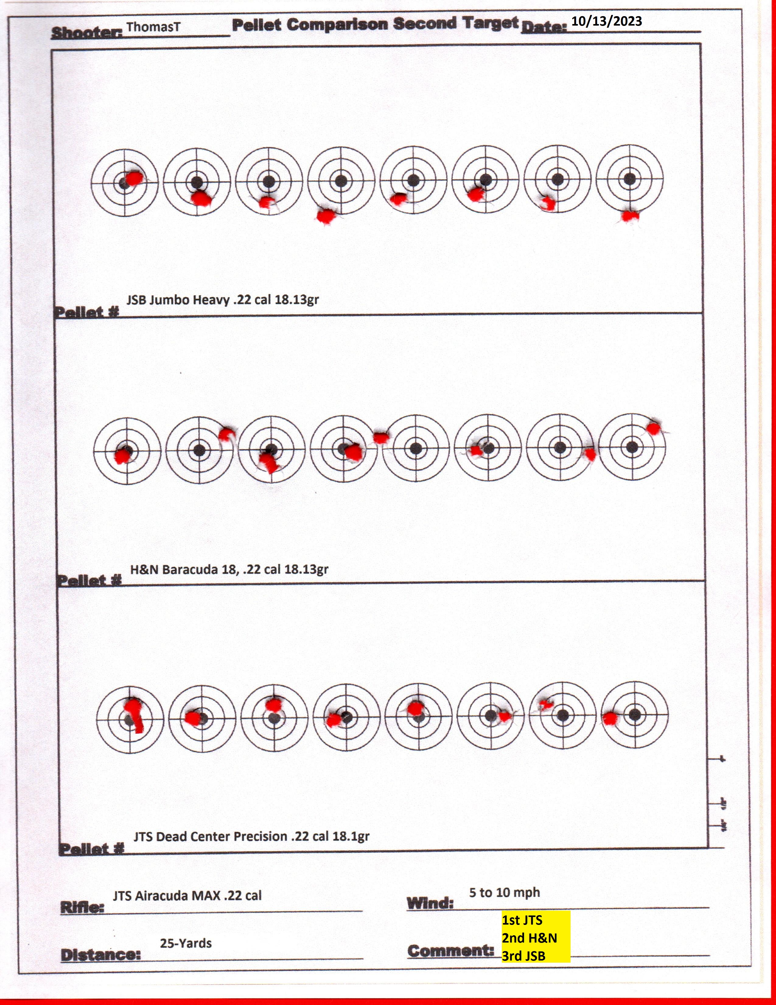

Hello everyone,
OK attached are the results for the 25-Yard Comparison Test and I am more than surprised. I did figure that the JTS would be the Top Shooter, but completely shocked with the other two Brands. I really thought that the H&N would be almost too close to tell, but that was not the case. The H&N only shot 4 MOA’s out of eight? And JSB put two POI’s outside of the 3/4" ring and only had 3 MOA’s. Cannot blame it on the rifle because it did shoot 7 out of 8 MOA’s with the JTS pellets and that “one” could be blamed on me.
I have one more test to try and I might add it here later on.
Hope this will be of some help to the Forum members.
ThomasT
Interesting, and coincidental. I just ran the same three pellets for comparison in their .25 caliber versions. I ran them at 25yds and 38yds. My results were same as yours out of my Airacuda Std. with the JTS just slightly better than the other two.

Hello @rsfrid
At 10-meters they are all very close, but the JTS really shines out at 25-Yards. To me that is a big improvement over the other two brands. I did some more shooting on other paper to verify what I shot on the "Test Targets" and saw the same results which made me happy. However the JSB, on the other paper, had the same flyers and poor results.
