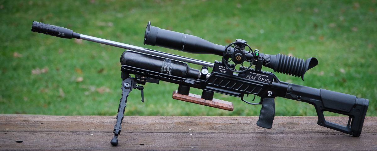

After well over a year of messing with my 22cal RAW, I'm finally done. I'm using a 21" LW 12-groove barrel that Scott machined for me, as I prefer the balance to the longer 23" barrels. I'm using an SSG in conjunction with a TM hammer. The reg is set to 135 Bar. I set it up to shoot MRD Light pellets at 35fpe (about 95% of max energy at this reg pressure), which average 1/2" groups at 50yds. I also swapped out the RAW chassis and MDT buttstock. I'm happy with the final setup.
I did a shot count yesterday. I'm getting 120 shots with an SD of 7 with a 3ksi fill, shooting down to about 125 Bar. Does my shot count seem about right for this power level?

As far as SSG’s or balanced valves, I’ve not seen real data that shows they have more than a few % benefit over a properly balanced and setup RAW action and regulator. I’m just not sure they‘re worth all the hype.

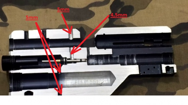

I have a different opinion, let's imagine a block/action from say an FX Royale 500 that has a balanced valve. It can be made so that all the changes can be done externally, hammer, hammer spring, valve, valve seat, valve needle seat, valve return spring, valve return spring force adjustment, replaceable TP. The new Daystate Black Wolf has two types of valves but it is not as accessible as on the FX Royale.

I know about the plenum, but it's much easier to make it smaller or larger than to limit it like on the new Black Wolf (about 35 cc). An example is the Epic Two or One which have I think three sizes of plenum.

I agree with Scott. There is a reason that RAW is designed and manufactured the way they are and why they are considered bulletproof for their intended applications.
Pardon my ignorance, but can you explain what these are?
SSG is a "Spring Stopping Guide" which is for most a self made anti-hammer bounce devise ;)
TM hammer is the Older style hammer from TM-1000's that are lighter than the supplied HMX-1000 hammers used with the newer rifles ;)
