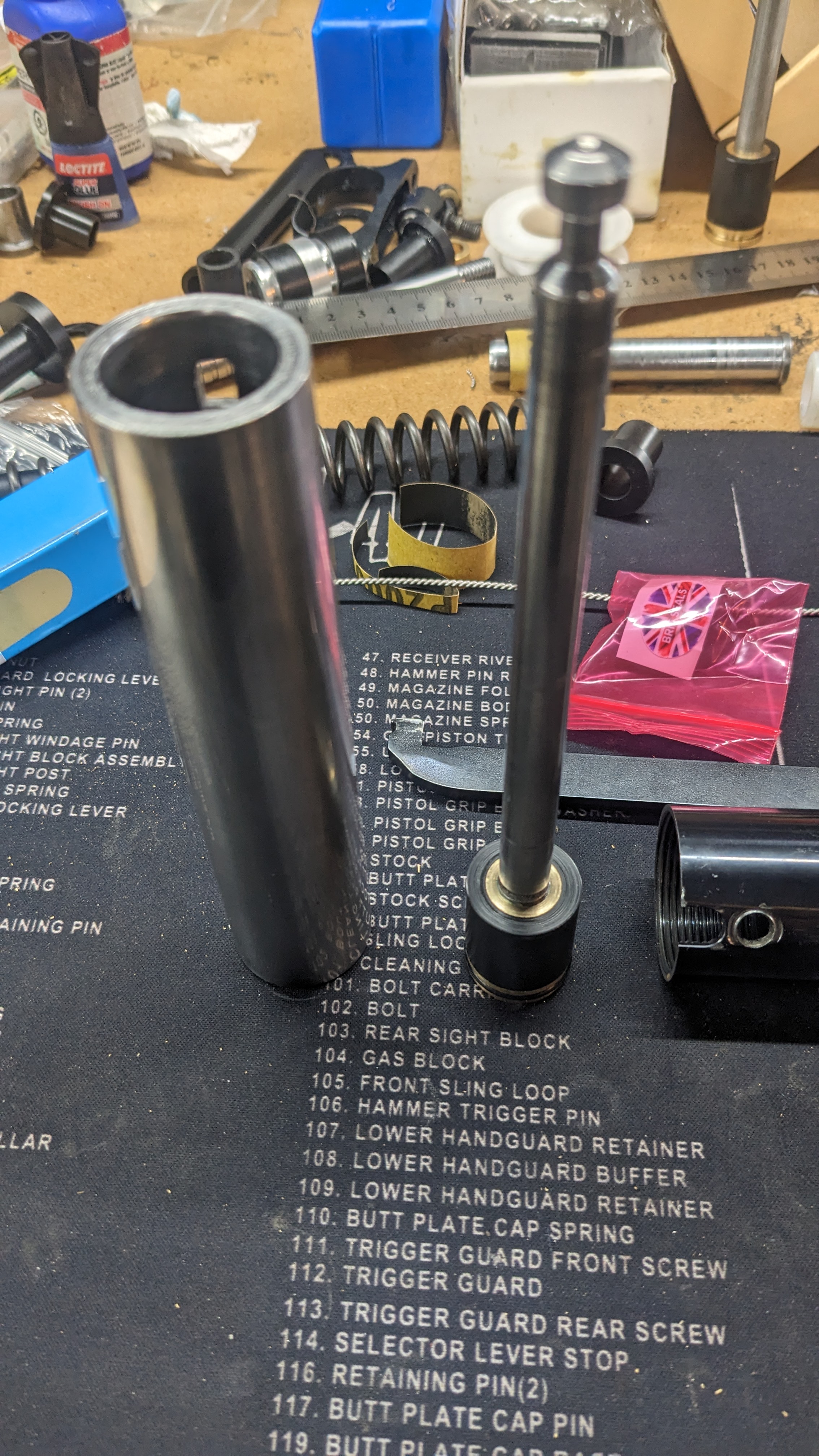

Hi all,
I've been developing a 22mm tune on my HW97, .177 rifle. The piston is skirtless, 130g with tophat, o-ring sealing and on a TX200 mk3 spring and latch rod.
I'm quite happy with it but recently a leaky compression tube has had me questioning things and I thought it would be interesting to get some more thoughts on a solution.
Initially the rifle was set up to shoot 8.44 exacts @ 760fps, I had issues with the comp tube leaking originally. I think I had a void in the compression tube sleeve, I fixed this by sealing the end with retaining compound.

22mm? "Skirtless"? You've done so many design changes my head spins. I don't know where to start. Maybe some pictures might be helpful.

The piston is kept square via the spring guide. The spring guide is reamed to 0.002" larger than the latch rod. Squareness isn't an issue. It will be kept more square than the factory piston.
