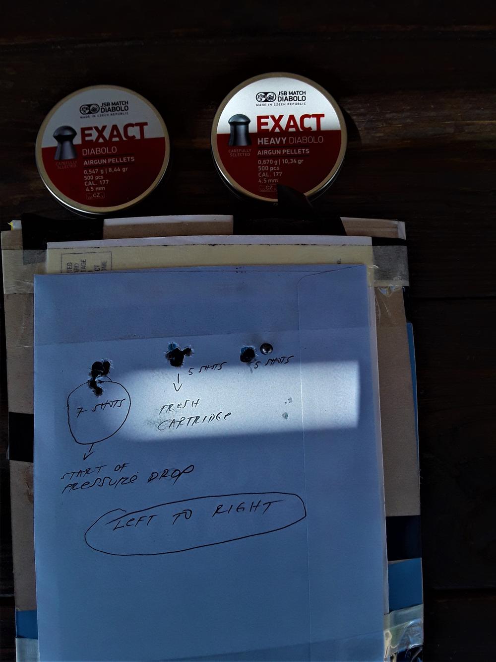

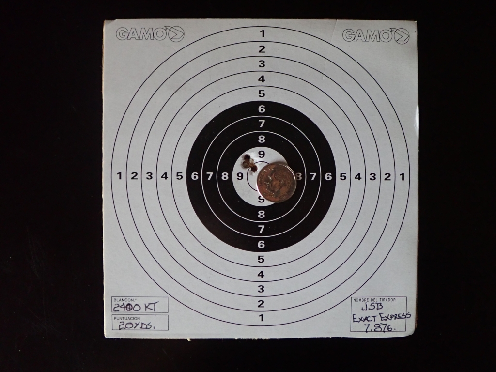

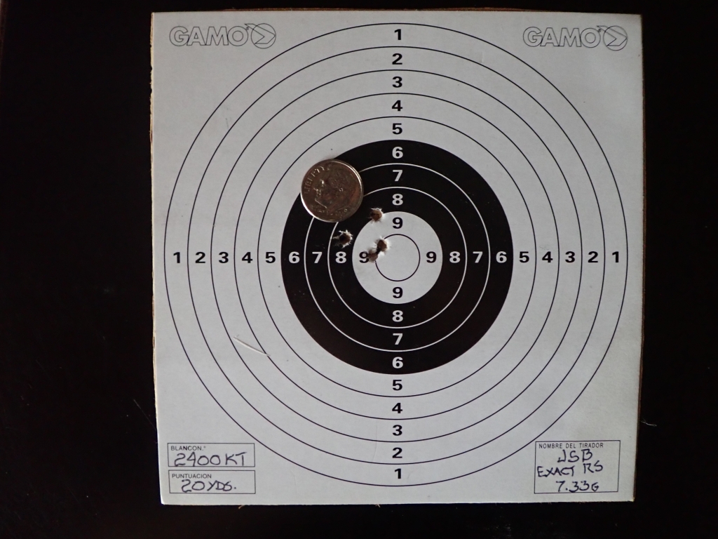

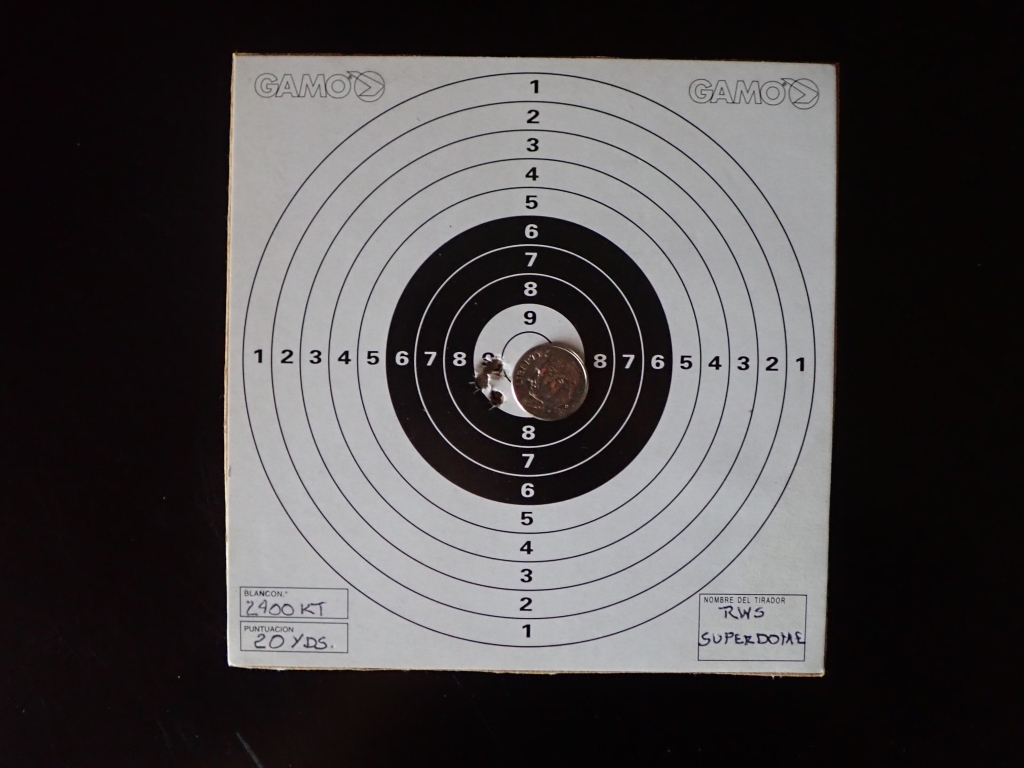

I have a factory stock .177 2400KT with the 14" L/W barrel. It puts out about 7fpe and is very accurate if I do my part. The targets below are the from when I first got it. After seeing the what the JSB 7.87s shot like, I stopped trying other pellets. I will say I have never been able to repeat that group, but I've come close many times. Recently I've found it also loves the H&N Finale Match W/Cs in 4.5mm.
5 shots at 20 yards
