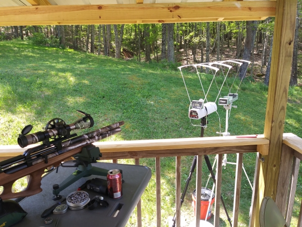

"SMH77"Beautiful mid-60’s weather here today so i plan to do a quick test of BC on just one .30 cal pellet to see how it changes over temp. Then I plan to convert to .25 LW (non-polygon) barrel and try to get all the data on the .25 cal pellets before I loose daylight. Hope the temp doesn’t drop and affect readings…

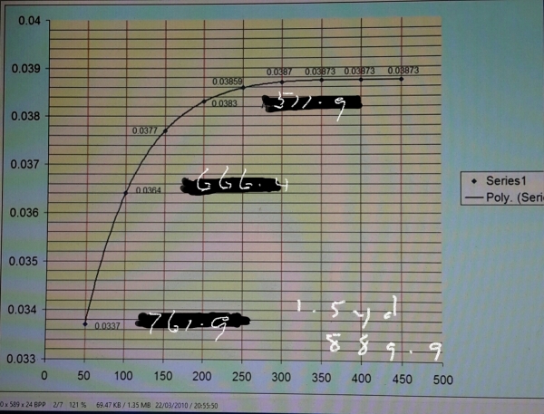

OK Sean,
The original study was done in 2010 with data collected at 1.50 yd, 50 , 100 and 200 yd over a protected chronograph. I doubt anyone had previously shot an airgun over a chronograph at 200 yd or possibly 100 yards before.
This graph is a rudimentary summary showing average shot data at these ranges derived from the then new FX Kings, my very accurate BSA Bowkett Hornet; and interpolation and extrapolation as indicated.
The method and most relevant information about the study can be read in the reference below. Note that bc figures have been recorded as at the study altitude etc and also as standardised for perhaps useful comparison by others relative to their conditions.
Any claims made of course should be seen as being relevant in particular to the rifle and pellets used. There is some good discussion in the thread.
http://bsaog.co.uk/forum/index.php?topic=13228.
The graph: From 2010.

Finally had a chance to compare the chronographs and found them to be within 1 fps across 10 shots .
Then set up and did a quick string with the Crown shooting King Heavy Mk2 at 880 with 76 yards between the chronos and got a BC of 0.0515 . Looking forward to doing the 50 yard test the same way SMH77 did to see the difference that the seperation between chronys makes . Now if JSB will get us some pellets I'll get on with it , almost out .
