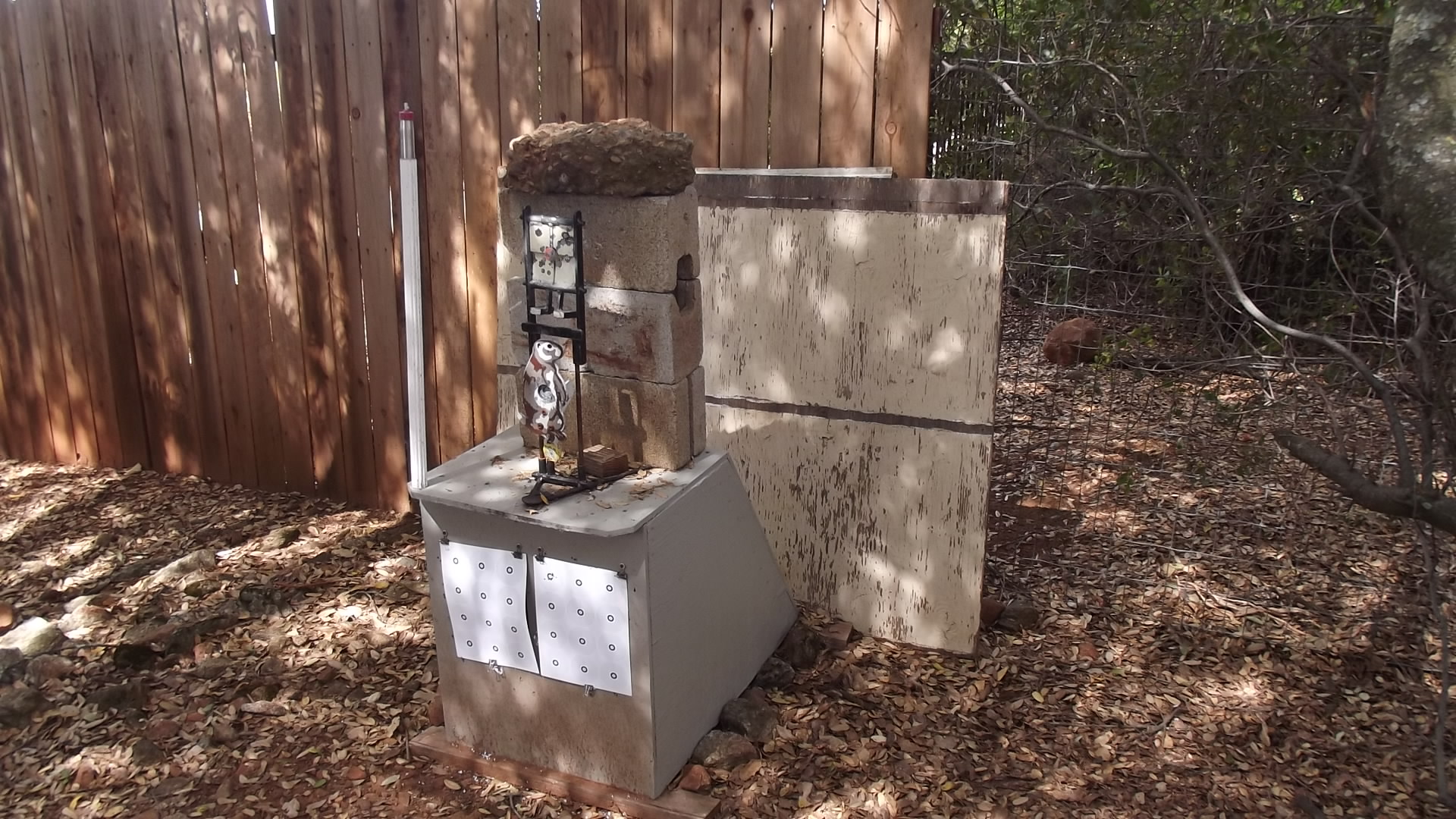

Bounce boxes .... Angled back side with a 1/4" steel plate in place.
pellet / slugs splatter downward into the dirt. has worked great for Many many years now !!

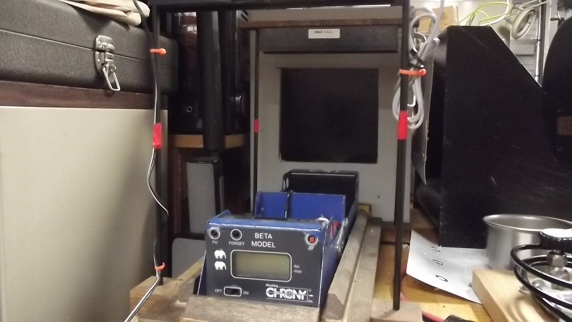

1 big one in yard, smaller one in shop behind the chrony
