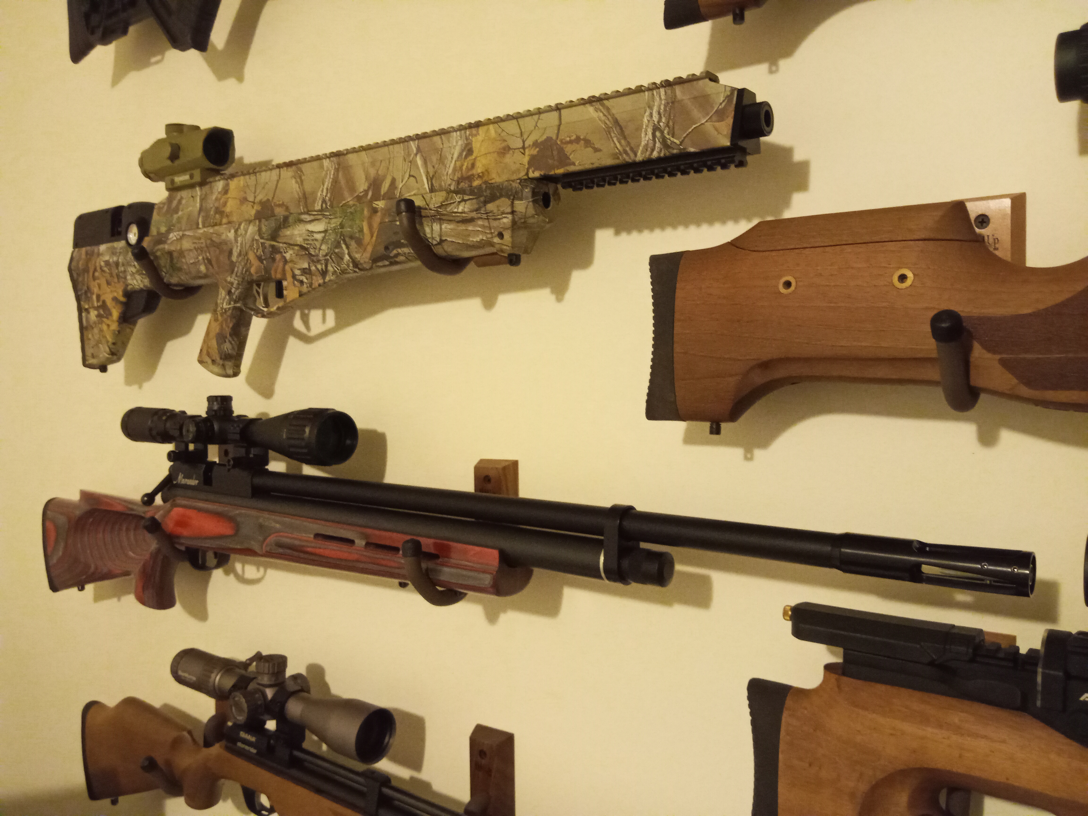

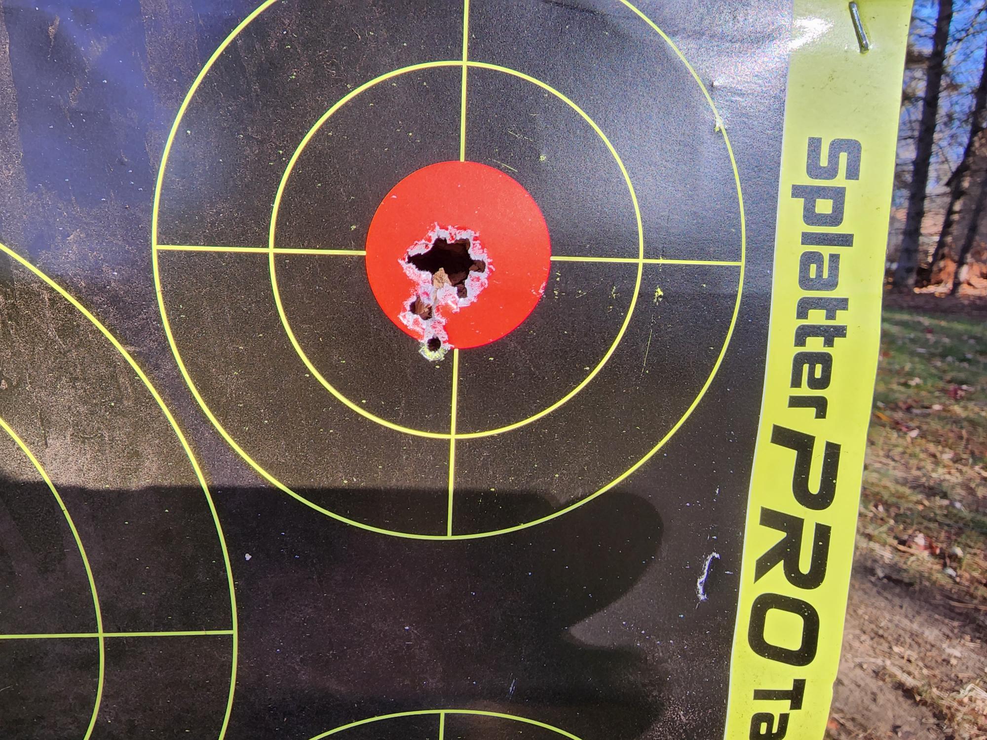

Got my .25 Avenger up to 83 FPE using Seneca 43.2 grain pellets. JSB 33.95's I can push to about 73 FPE. Not many of the slugs get much over 70 FPE due to the slower nature of them from my gun. Testing about 20 different slugs to see which one will reign. But it's hard to beat the jsb pellets for accuracy. Really wish someone made a jsb copy that was about 40 grains. I think that would be the ticket from my gun.
