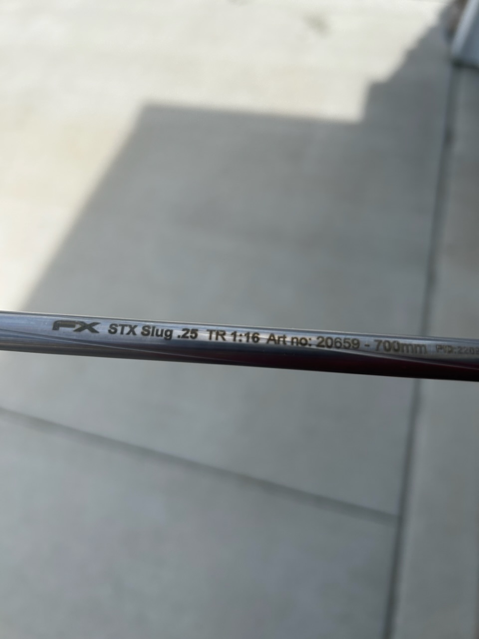

There is no such thing as a “Heavy” liner anymore. The new slug liners are laser-engraved with the word “Slug”.
